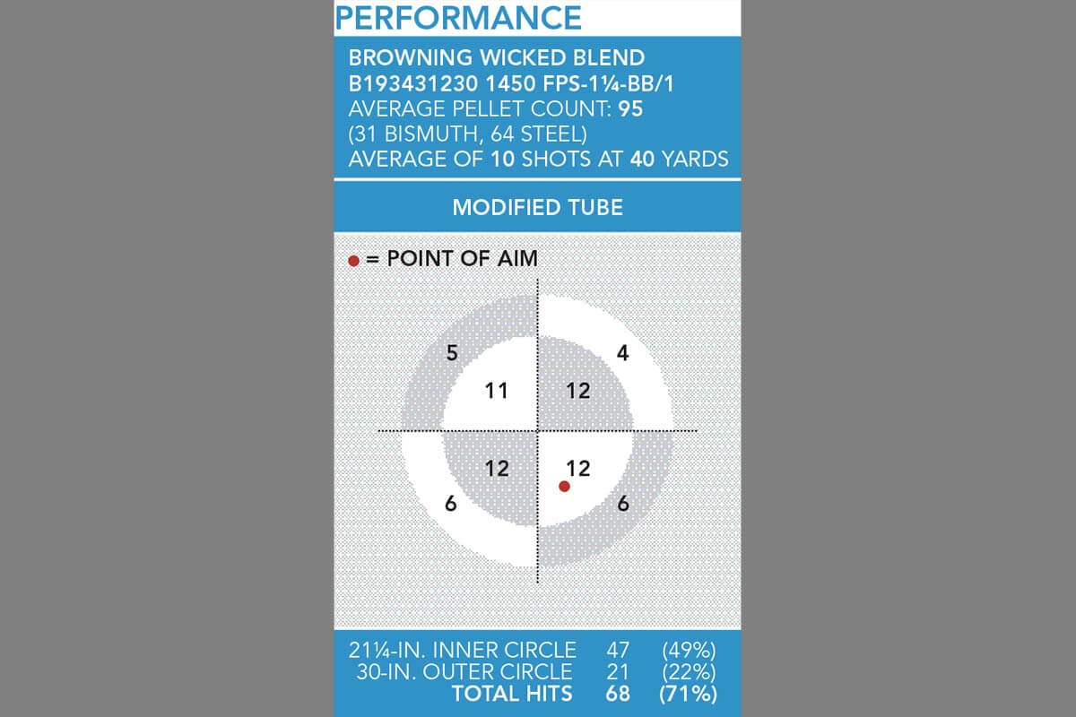

I pattern-­tested the Maxus II with Browning’s new Wicked Blend waterfowl ammo. This combines bismuth and steel shot in one shell, with smaller bismuth pellets riding on top of the steel charge. You can have it in No. 2 steel/No. 4 bismuth or the combo I used: BB and No. 1.
The shot charge is carried in the Wicked Wad, which, Browning says is more aerodynamically stable than competitive types and releases the shot charge gradually and in line with the target.
Browning Maxus II 09
The Turkish walnut buttstock has a husky pistol grip with stippling and checkering. The stock is capped by a Inflex recoil pad that moves forces down to reduce punishment to the face. (Photo by Michael Anschuetz)
I didn’t shoot enough of the new ammo to have firm opinions on that, but I will say that in more than 40 years of patterning shotguns, I’ve never seen a load consistently toss the wad over the top of the pattern board at 40 yards!
