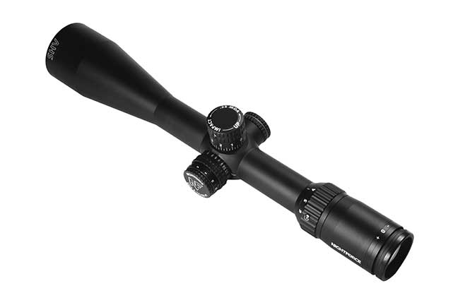

Nightforce SHV 4-14x50mm F1
The Nightforce SHV 4-14x50mm F1 is the only scope in the SHV lineup that incorporates a first focal plane reticle. It is a large scope (14.8 inches long), well-suited to precision shooting with rifles at the heavier end of the spectrum- exactly the types of rifles most frequently used for long range shooting.
MIL or MOA Nightforce SHV versions are available using the MIL-R or MOAR reticles, respectively. The adjustments on the MIL version are in .1MIL increments while the MOA variants adjust via .25 MOA clicks. The 30mm tube provides an adjustment range of 90 MOA/26.2 MIL for elevation and 70 MOA/20.4 MIL of windage.

The elevation dial on this Nightforce SHV is exposed to allow for fast adjustments while the windage dial is covered to help prevent inadvertent movement. Personally, I prefer to dial for elevation and use the reticle for any windage corrections so this system works perfectly for me.
The elevation dial uses a Zeroset screw to lock-in the rifle's zero- the shooter can quickly return to zero by turning the dial clockwise until it stops and this can be done without taking one's eye off the target. Parallax adjustments are made by the knob at the 9 o'clock position (illumination adjustments are located on the same knob) and the graduations appeared to be correct for the ranges listed.
