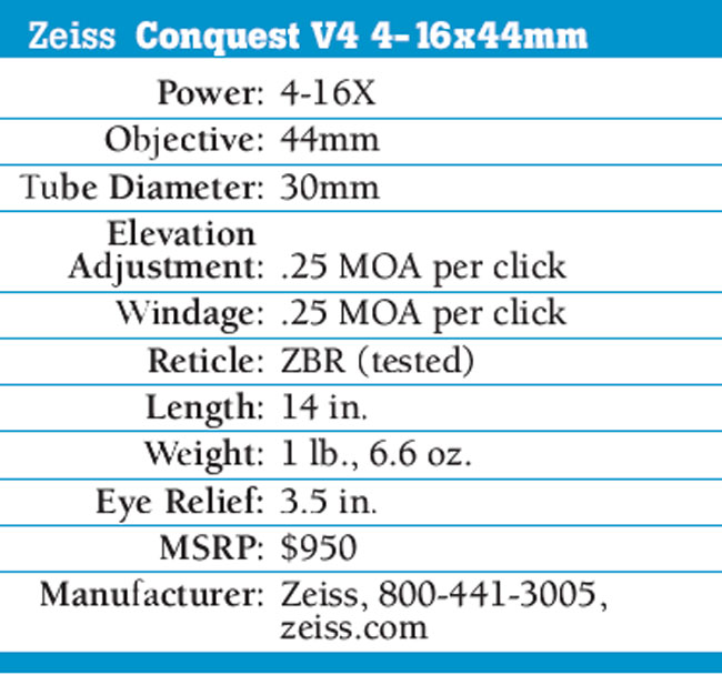

Zeiss Conquest V4 4-16x44mm $950 (Left)

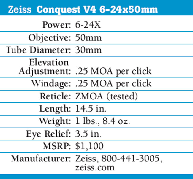

Zeiss Conquest V4 6-­24x50mm $1,100 (Right)

All of this performance comes wrapped in a lightweight package. The 4-16x44mm weighed 22 ounces and the 6-24x50mm tipped the scales at a svelte 24 ounces. No doubt about it, the V4 fights up a couple of weight classes.
