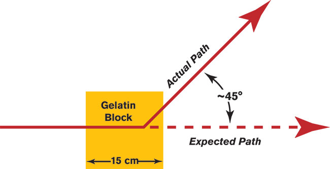

In my youth, I assumed that as a bullet passed though an animal or person, it continued on in a straight line in the same direction the gun barrel was pointed. It was an eye-opener to find that's not always the case.
Hitting any target can upset the artificial stability imparted to a bullet by rifling. If the bullet starts to yaw, it can change direction. My first experience with this came while shooting 200-grain .38 Special bullets through gelatin. I fired a shot, saw the chronograph screen light blink out and felt a dull thud against my foot. In only 51/2 inches of gelatin, the long, slow bullet turned up and to the right 45 degrees, so it had no problem whamming the chronograph screen and bouncing back to the shooting station.
That was a homogenous target, unlike living tissue. We worked an officer-involved shooting where a policeman made an essentially level shot on an armed assailant with a .357 Magnum hollowpoint.
Having expended most of its velocity in the bad guy's chest, the bullet exited and struck a wall about four feet behind the suspect. The pockmark on the wall was close to seven feet off the floor even though the exit point on the suspect was less than five feet from the floor. If one assumes that bullets always travel in a perfectly straight line, the officer would have been lying under the floorboards shooting up, something that both civilian witnesses and the officers involved said didn't happen.
I often wish that some pundits making claims about a certain historical shooting in 1963 would take this very common behavior of bullets more seriously.
