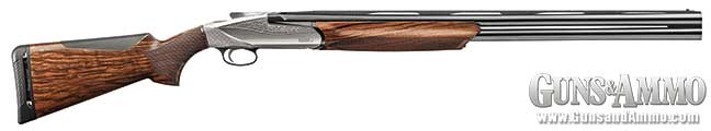

Nobody does style like the Italians, and this is a fascinating gun. The second thing I noticed, after its style, was its airy-ness. The full-size Benelli 828U 12-gauge is wonderfully light in the hand at 6.6 pounds, hoisting like a 20 gauge. Next, the gun practically falls open when you break open the action, like only an old, worn-in double gun can, and even that tension can be adjusted lighter, it turns out. This is because of the next thing that raised my eyebrows: a brightly polished steel locking plate that locks into place behind the chambers as you close the gun, forming the breech face. It is something to see.

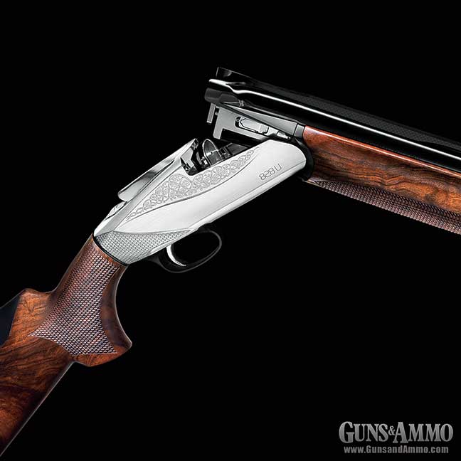

Because this locking plate supports the cartridge base and takes all the pounding of the shell explosion (as opposed to simply the flat front face of the receiver forming the breech like every other O/U out there), the Benelli 828U doesn't have to be built so tight that you need gorilla arms to break it open before it's worn in.
There's another reason it breaks so easily. You aren't cocking it when you crack it open. The Benelli 828U is cocked when you push the thumb lever to open it up, which is another reason the receiver has such a nice, slim, low profile. The forestock is just a forestock, with no internal ejection springs or rods. It even has a push button at the end of it for removal, like a typical side-by-side.

Perhaps the most profound of the unconventional features in the Benelli 828U is that locking plate because it enables the use of many other nontraditional features, such as an aluminum alloy receiver, as well as the impulse ejectors built into the sides of the monobloc. That's because recoil is directed back to the barrel assembly as opposed to simply slamming rearward into the breech face (and your shoulder). This is achieved because the locking plate has lugs that hook into the bottom of the monobloc when the gun is closed, effectively making the locking plate (the breech face in this design) a steel-on-steel part of the monobloc.
In a conventional gun, according to designer Marco Vignaroli (the mastermind behind the Benelli Ethos and the Benelli 828U), the explosion from the shot is essentially trying to blow apart the gun, and the hinge pin is what holds it together and takes all that abuse. This is why traditional guns are tight and stiff at first before wearing in wonderfully and wearing out ultimately. After many thousands of rounds, they need to be refurbished.
Also because of the wear-in on traditional O/U's, the release lever slowly works over to one side across the years. The Benelli 828U should do none of this and, according to Benelli, never wear out, nor does it have to be built super tight with stiff hinges, cocking, safety mechanism and release-lever tolerances to endure that pounding.

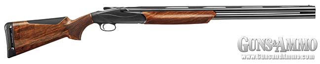

A carbon fiber top sight rib combined with a lack of side ribs add to the light weight and fast handling. The fiber optic front sight can be changed.
This all adds up to a gun that is perfectly balanced right at the hinge (go ahead; you can balance it there on your finger), protecting Benelli's heritage of between-the-hands balance spawned by all of its wonderful internal inertia-driven autoloaders.

Impulse ejectors work as extractors if the shell has not been fired. Once a shell is fired, the hull of the shell — not gas — pushes a small piston through a hole in the chamber. This trips that ejector to throw the shell out.
