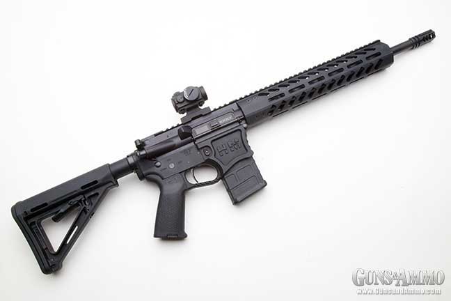

It's not that often that anything really new emerges in the AR world. Sure, we see new innovations on an almost daily basis but rarely is it something that relates to the fundamental design of the firearm. HM Defense's Monobloc HM-15 is truly something different, an AR15-style carbine with both a gas tube interface and muzzle device machined integrally into the barrel. If you believe that simpler is better, the HM-15 Monobloc is a serious step in your direction.

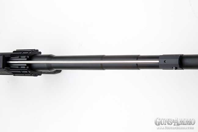

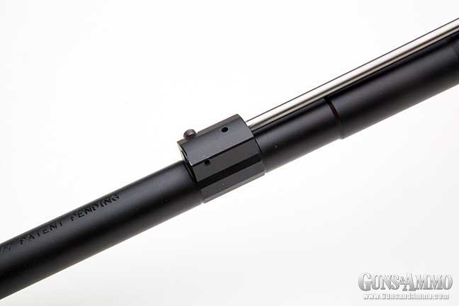

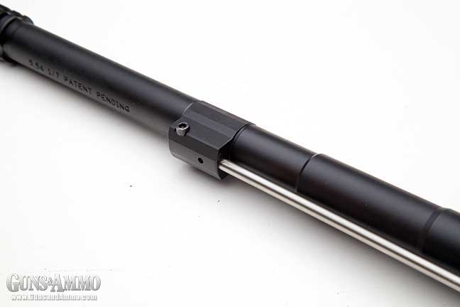

There are two gas tube options available for HM's Monobloc. One is their quick change gas system, only available on their complete rifles, which uses a removable screw to retain the gas tube. In the event that the gas tube needs to be removed or replaced, the operation can be performed in seconds with a simple hex tool.
The second option, available on component barrels and complete uppers, uses a traditional roll pin to attach the forward end of the gas tube to the barrel. The Monobloc is the lowest profile gas system that I have even seen on an AR, with the highest point of the block protruding just .280" above the barrel.

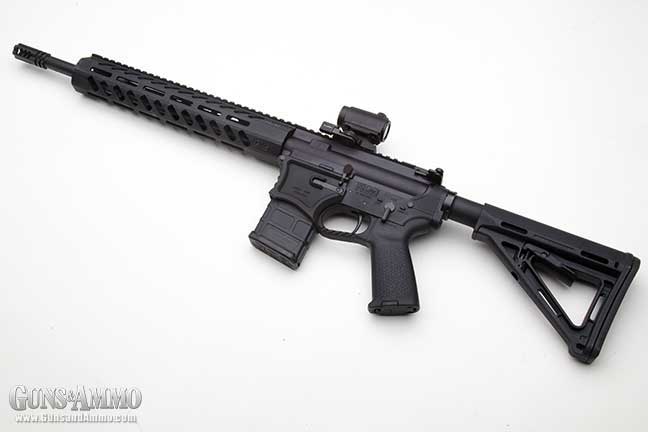

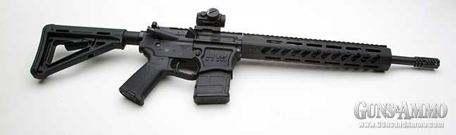

The low-profile system allows for a slim and trim forend, our test rifle was fitted with an M-LOK capable free float tube aluminum produced by HM. This forend is smooth and snag-free except for the top, which has an integral full-length Picatinny rail.
The Monoblocs are available in various configurations and lengths, but our test rifle was in the style that I prefer-- a mid-length gas system coupled with a 14.5" barrel. The National Firearms Act dictates that a rifle must have a barrel of at least 16" in order to avoid registration. To achieve the legal 16 inches with a 14.5" barrel, a muzzle device of 1.5" or longer must be permanently attached.

The Monobloc's gas tube interfaces directly into a port milled into the barrel itself, eliminating the need for a traditional gas block. Not only does this make gas tube installation incredibly simple, it means that the gas block will never be a failure point.

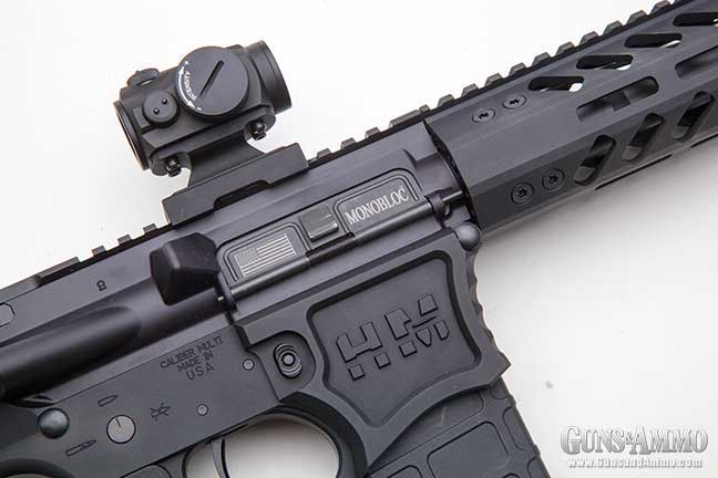

One thing to note is that the HM-15's billet aluminum lower was built to be compatible with Gen 2 PMAGs so Gen 3 versions are a very tight fit due to the close tolerances. USGI aluminum magazines work fine as well as Lancers, Hexmags, and others. HM also offers a traditional forged lower, which works with all AR magazines.
The HM-15 is not just another box-built black rifle. Virtually the only major parts of the HM-15 that aren't produced in house by HM Defense are the MOE stock and pistol grip from Magpul. The lower receivers, barrels, bolt carrier groups, and even various small parts (including a QD end plate that HM Sells as a component part) are produced under one roof.
The Monobloc uses a low profile free float aluminum handguard with a 12 o'clock rail and M-LOK compatible vents.
