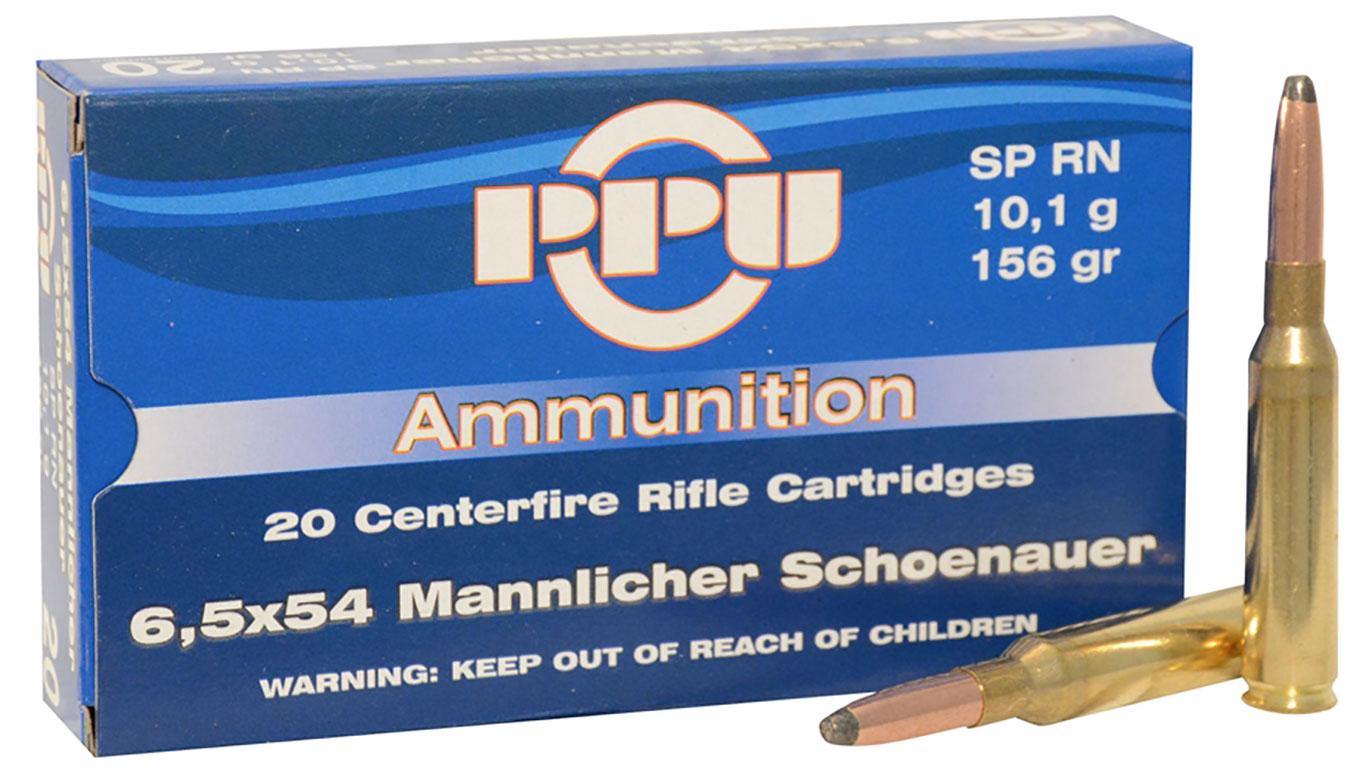

6.5x54 Mannlicher Schoenauer
6.5x54-Mannlicher-Schoenauer
Released in the early 1900s as a military cartridge, the 6.5x54 earned a great reputation among hunters in Africa. W.D.M. 'Karamoja' Bell used one as an elephant rifle - though he preferred the .275 Rigby -taking many of the great beasts with it. The famous Kenyan Game Ranger A. Blaney Percival - brother of Philip Percival who hunted with both Theodore Roosevelt and Ernest Hemingway - used this cartridge as his lion gun. He relied on the Sectional Density of the 160grain solids for penetration, and preferred the light recoil of the rifle. The mild muzzle velocity - 2,400 fps with the 160-grain slugs - ensured that the soft point bullets performed well, without premature breakup. Though a rarity today, both the cartridge and the rifle are revered by collectors.

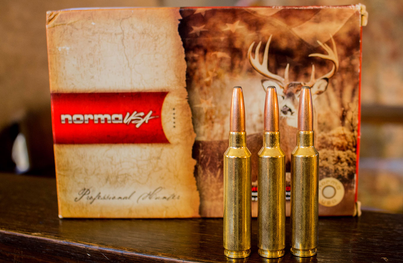

6.5-284 Norma
6.5-284-Norma
This is another gem from the wildcatter's drawing board, being the .284 Winchester cartridge necked down to hold 6.5mm bullets. It quickly became the darling of the long range shooting community, having a case capacity to launch the sleek 140-grain target bullets to over 2,900 fps in a long-barreled rifle. Using a wide body and a rebated rim, the 6.5-284 Norma isn't quite as hard on a rifle's throat as the .264 Magnum, but can still deliver the goods at 1,00 yards and beyond. This is my personal favorite of the 6.5mm lineup, as it makes an excellent hunting cartridge as well as a target round.

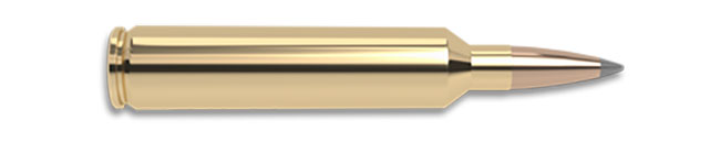

.26 Nosler
26-Nosler
Using the beltless .404 Jeffery case (a particular favorite of mine) as a platform for their series of proprietary cartridges, Nosler introduced the .26 Nosler in late 2013. A 2.590-inch case - capable of fitting in a long-action receiver - blown out, and using a rebated rim, the .26 Nosler is a speed-demon for sure. The 140-grain bullets leave the muzzle at 3,300 fps, making for a flat-shooting magnum class rifle that will buck the wind very well. It's accurate, for sure, but like the .264 Winchester Magnum, you can expect that barrel life will be shorter than that of the milder 6.5s. However, if you want a fast, flat 6.5, the .26 Nosler will definitely fit the bill.

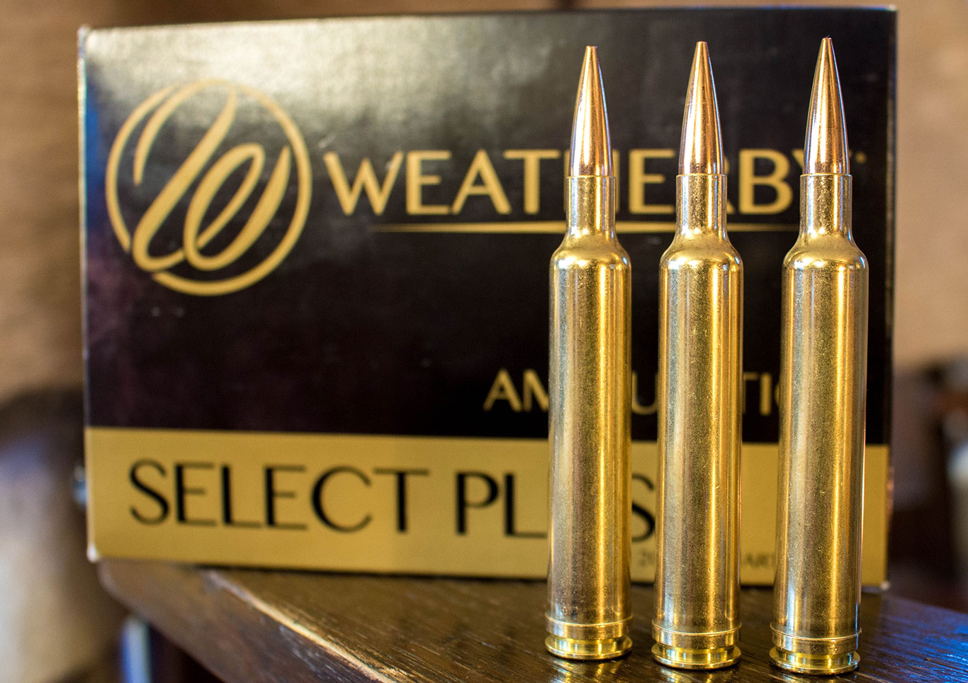

6.5-300 Weatherby Magnum
6.5-300-Weatherby-Magnum
The Weatherby cartridges have always been about speed, and the 6.5-300 is no disappointment. The .300 Weatherby is a time-proven design, and Weatherby necked it down to hold 6.5mm bullets, resulting in the fastest 6.5mm cartridge commercially available. The famous Weatherby double-radius shoulder is there, along with the belt that was carried over from the Holland & Holland design. It will send a 140-grain bullet screaming from the muzzle at almost 3,400 fps, resulting in a trajectory that is a dead-hold out to 350 yards. All that comes at the price of increased recoil andshort barrel life, but if you want a hot-rod, this is your baby. While probably not practical as a target rifle - just because of barrel erosion and recoil - is will definitely reach out to sane hunting ranges with ease.
Editor's Note: Checkout the Weatherby 6.5 RPM cartridge, which was not available at the time of this article.

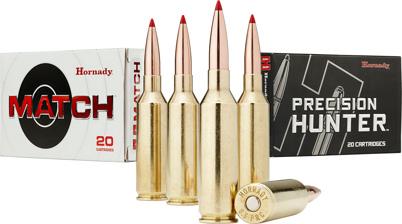

6.5 PRC
6.5-PRC
Introduced at the 2018 SHOT Show, Hornady's 6.5 PRC is based on the .300 Ruger Compact Magnum case, neckedto hold 6.5mm bullets and designed to run in a short-action rifle. Hornady loads their 143- and 147-grain ELD Match and ELD-X bullets, to a muzzle velocity of just over 2,900 fps, putting the 6.5 PRC on equal plane with the6.5-284 Norma. The PRC will deliver a trajectory highly reminiscent of the .300 Winchester Magnum, at least at hunting ranges. Out further, the PRC and its high B.C. bullets will show an advantage in trajectory and win deflection. Think of the PRC as the big brother to the Creedmoor, perfect for the gun games like the Precision Rifle Series and for any hunting scenario where a 6.5mm is warranted.
