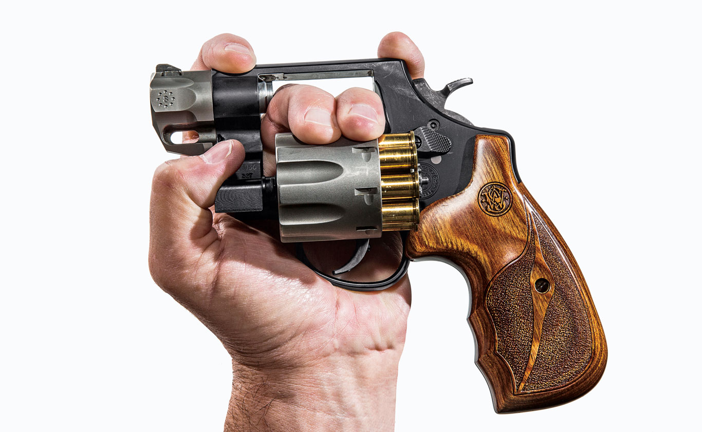

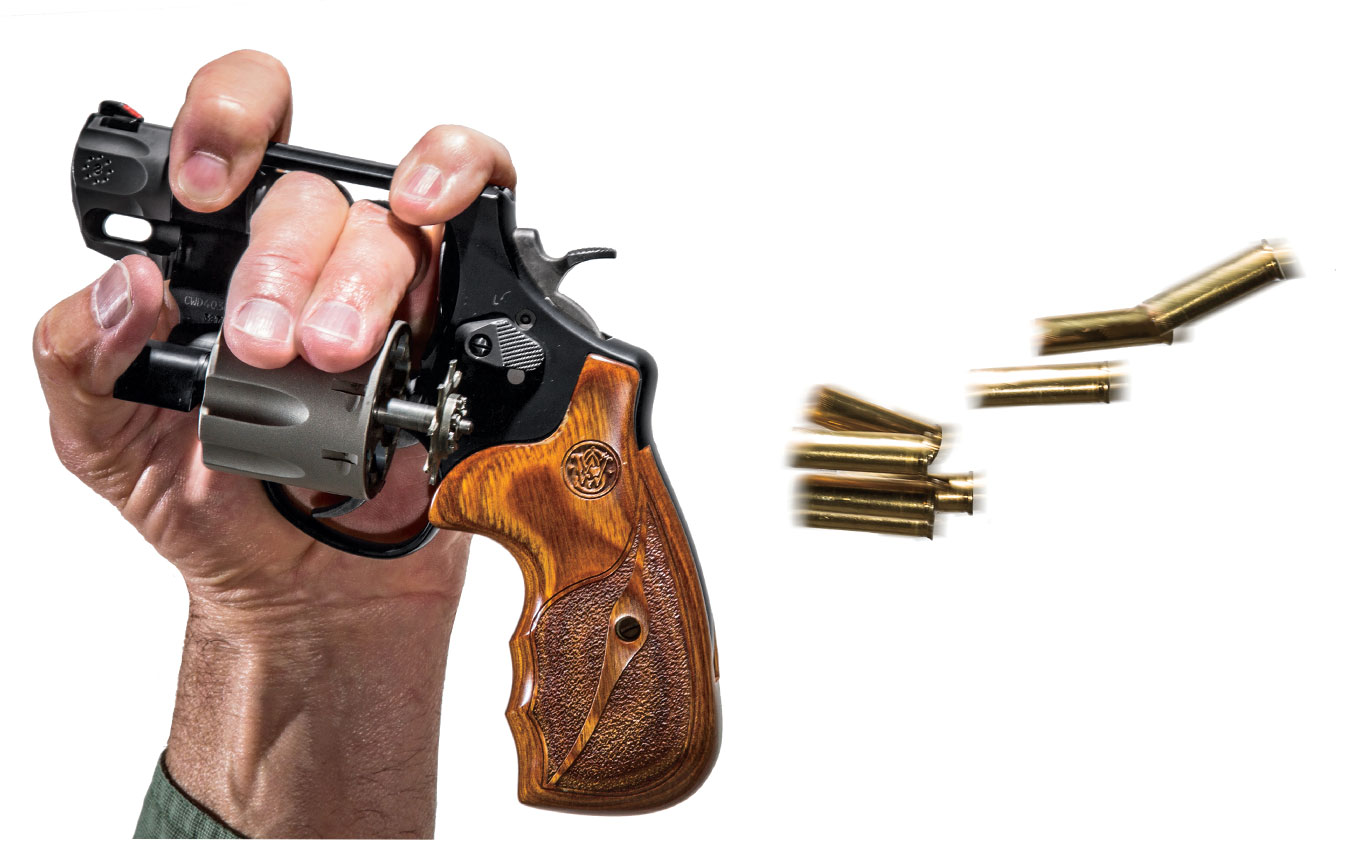

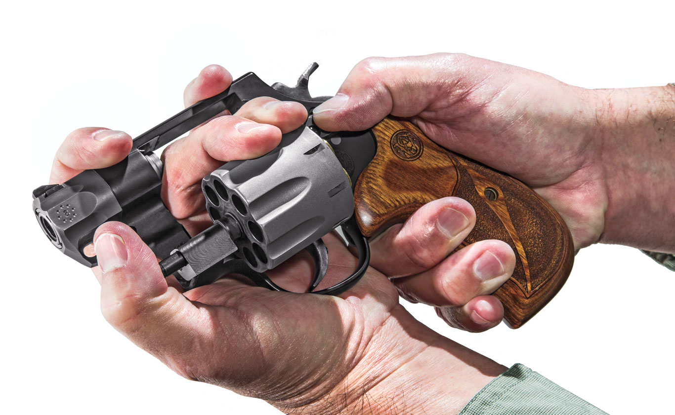

As a trained shooter realizes that they're empty, the revolver should be brought down to diaphragm level. For a right-handed shooter, the right thumb engages the cylinder release button while the left hand wraps around the frame of the revolver. The middle and ring fingers push the cylinder out of the frame. The revolver should then be inverted with the left hand. The left thumb pushes down on the ejector rod, which usually force the spent cases to fall free from the cylinder.
The right hand can then sweep or pluck any stubborn casings out of the way while the left hand maintains control of the revolver. In the event that there are stuck or stubborn casings, the right hand can also tap the ejector rod firmly, dislodging the offenders.

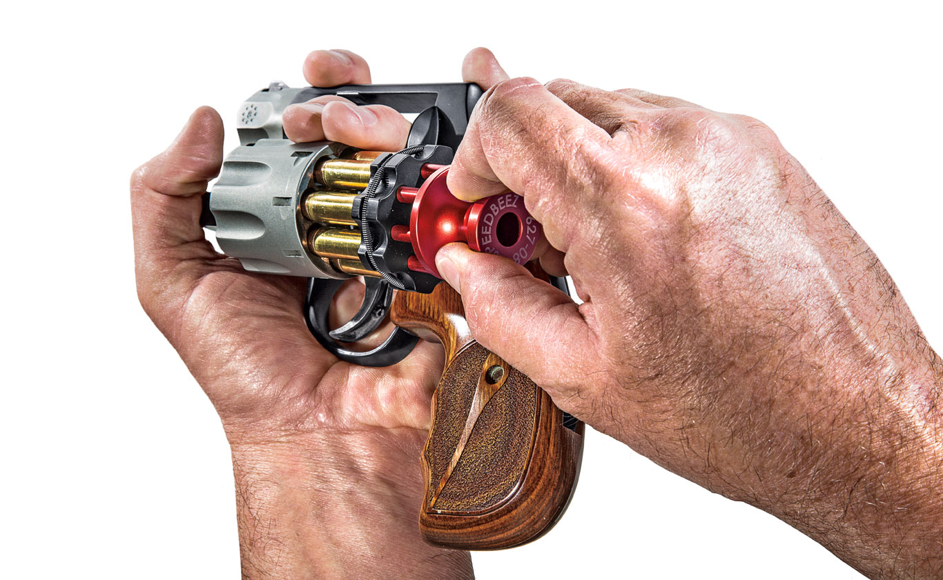

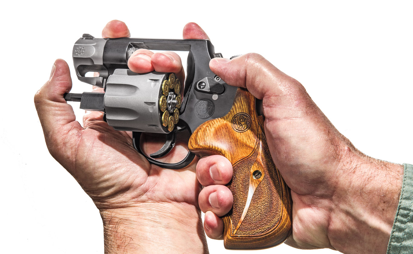

After ensuring that the cylinder is free of empty casings, the left hand then rotates the muzzle towards the ground while ensuring that the middle and ring fingers maintain control of the cylinder so that it doesn't rotate during the reload. The right hand then accesses the speed loader from a pouch or pocket and lines up the cartridges with the empty cylinder holes, pushing them in all the way and seating the rounds fully before releasing the speed loader from the cartridges. The empty speed loader then falls out of the way, while you re-engage the threat.

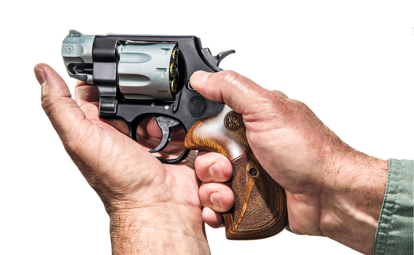

Finally, the right hand grips the revolver and the cylinder is closed by the left hand. Now the shooter must decide whether they need to re-engage or take another tactically appropriate action.

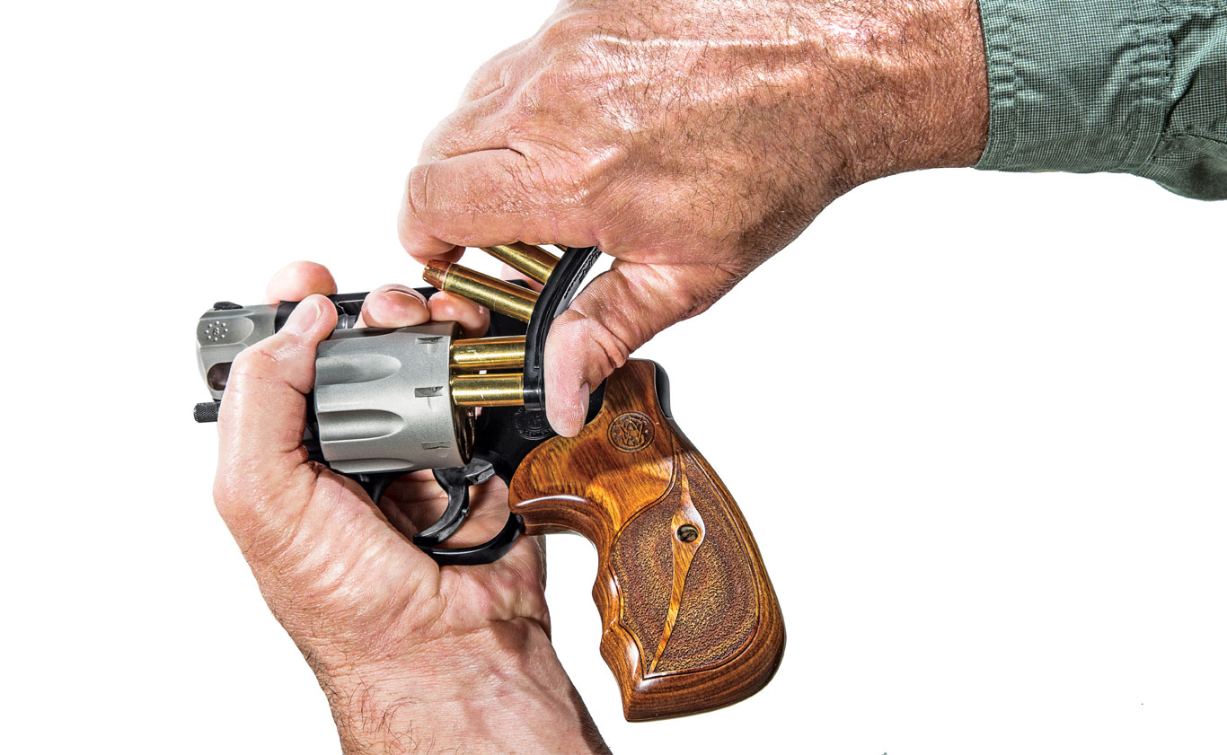

A speed strip is a thin polymer band with recessed cutouts that allow a certain number of cartridges to be lined up in a row. This makes for a flat, compact reload that tucks away easily in a pocket. However, it's a slower reloading method.
To utilize this method, the shooter replicates the same motions as used for the speed loader when breaking open the cylinder and emptying the spent cases. To utilize the speed strip most efficiently, two cartridges at a time are lined up with the empty holes in the cylinder, the shooter then inserts the cartridges and "peels" the strip away from the rims. The shooter then rotates the cylinder slightly with the thumb and fingers of the left hand to expose another two holes at a time and repeats.
