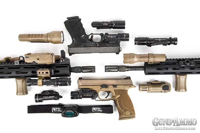

If you have a tactical light mounted to any of your firearms, you're aware of the huge advantage to and increase in shooting ability this convenient, pointable, accessible illumination device gives you in the dark. Both hands can work to efficiently run the gun, and an ergonomically placed switch turns the tactical light on and off without breaking your firing grip. It sure makes hits easy, even in complete darkness.

You've completed only the first step when you attach a tactical light to your firearm. Realize that it is a huge responsibility to get out and train at night with your setup. With a tactical light attached to our firearm, how can we accomplish the task of protecting ourselves, our family and our property at night without violating the most basic rules of gun safety?
The only difference when employing your firearm at night versus during the day should be the use of a secondary lighting system. In reality, your handheld light is your primary source of illumination until you've made the decision to engage a target. Once you are sure of your target, simply transition to the mounted tactical light on your firearm.
I prefer to have a small bungee tied to my handheld (or searching) light for retention purposes, but you can simply drop your handheld light onto the ground if necessary. I'm not a fan of light lanyards, since they tend to get in the way. A dangling light isn't a good thing in a confrontation, as it can easily be used against you. Murphy's law also applies to gunfights, so having a lanyard that gets loaded into a magazine well or snags on other gear is an invitation to disaster.
