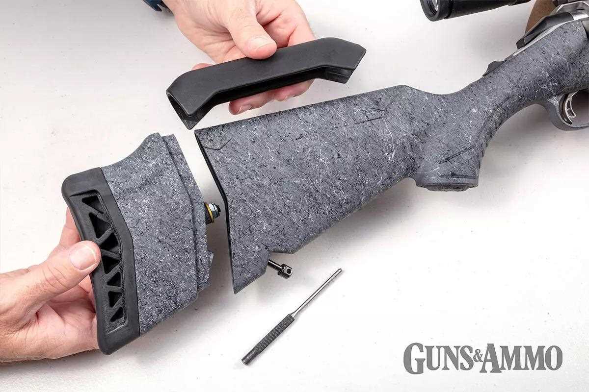

gaad-rf-stock-02
The stock on the Ruger American Rifle Generation II supports adjustments to its length of pull and comb height through the use of spacers. Removing the spacer reduces the length of pull from 13 3/4 inches to 12 inches. A spacer kit for the American Rifle Gen II is offered at Ruger's website. (Photo by Mark Fingar)

The next step is to adjust the length of pull until the shooter’s cheek is in the desired location on the comb. Do this in accordance with what’s most comfortable. It’s important to perform this step without a scope on the rifle because just about everyone will start to move their head to see through the scope if there is one available. This leads to a less than optimal fit later. My Seekins Precision Havak PH3 adjusts length of pull through spacers. Others, such as the Ruger American Rifle Gen II, have a system that allows for length of pull and comb height to be adjusted simultaneously. Loosen the Ruger’s sling swivel and add or remove spacers to adjust length of pull, or swap inserts to get the desired comb height.
Where length of pull adjusts to position the head where the shooter wants on the comb, comb-­height adjustment ensures the head has support when the shooter is on the rifle. Stocks like those found on the Ruger American Rifle use inserts to control height, but the more expensive Seekins Precision Havak PH3 — and those similar to it — have a click adjustment activated by depressing the button on the side. Both achieve the same effect, one is just a little faster and features more options. Where the American gives us a choice between half-­, five-eighths-­, or three-quarters-­inch elevations, the PH3 covers anywhere from zero to three-quarters of an ­inch.
