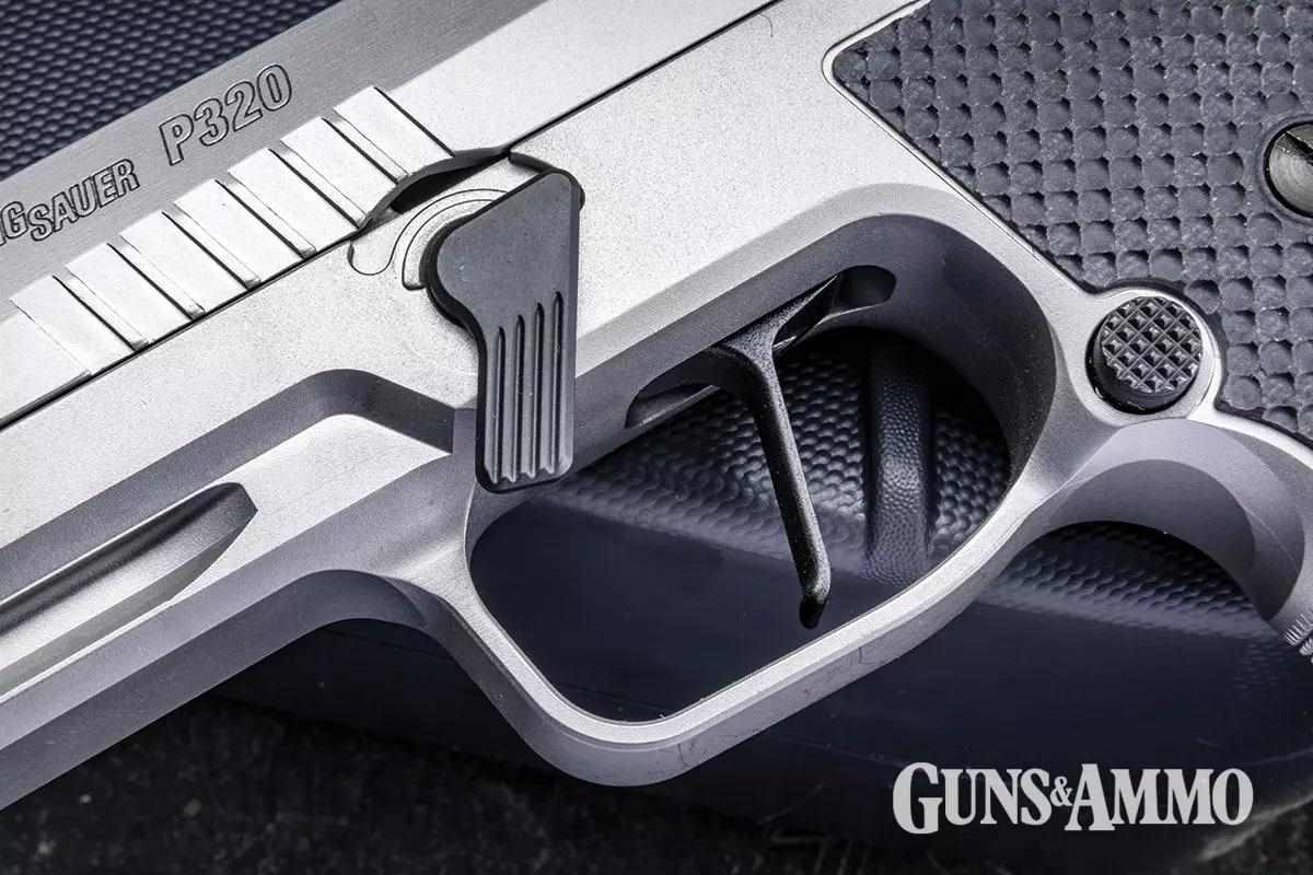

The Fire Control Unit (FCU) is an assembly on a serialized stainless-steel chassis, which is considered to be the “firearm.” Attached to the P320-XFIVE SXG FCU is a steel, flat-face trigger with subtle finger hook. Trigger weight was tested at 41/4 pounds. (Photo by Mark Fingar)

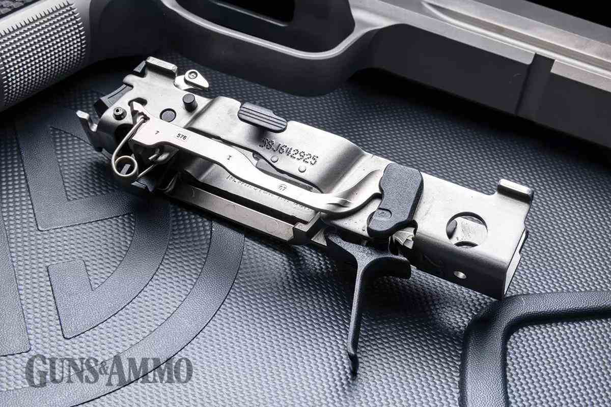

The P320 is a chassis gun, meaning that it has no “frame” per se, just an internal Fire Control Unit (FCU), and a grip module. The serialized part is the stainless-­steel chassis that organizes the trigger, slide lock, sear, pins and springs. It is easily removable from the grip module.

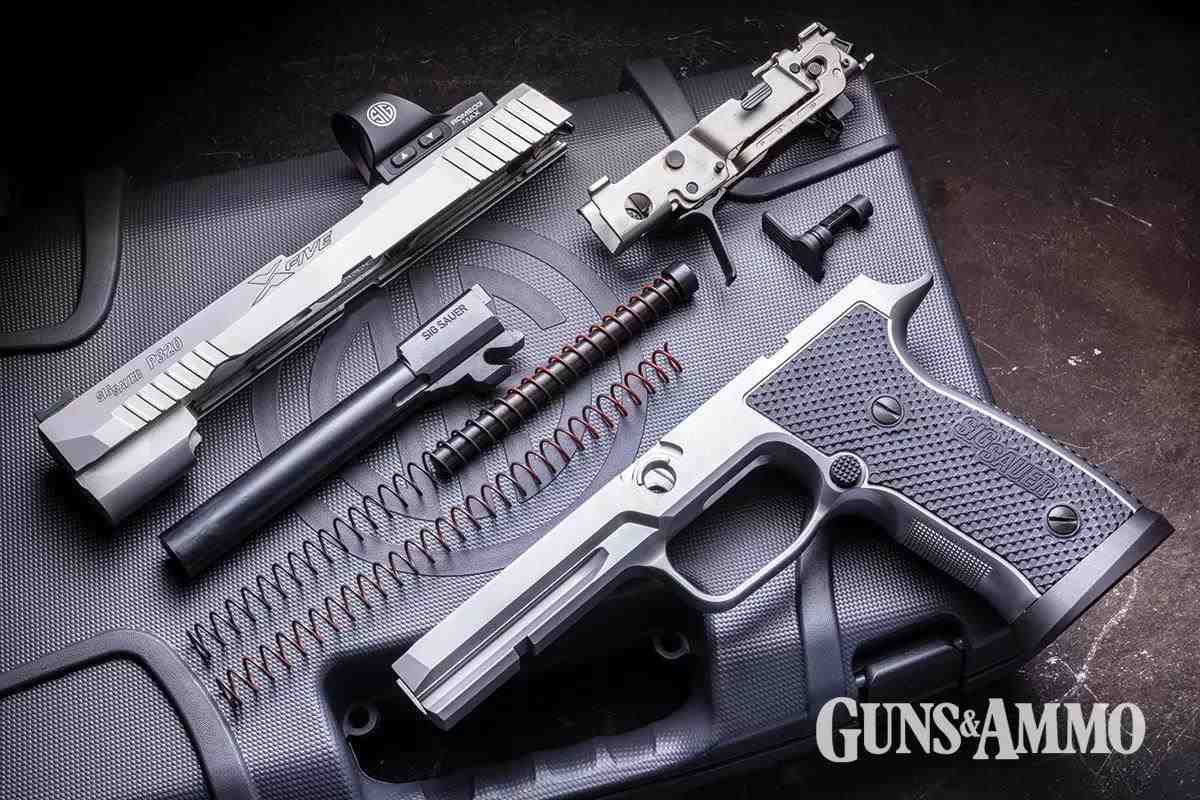

Fieldstripping includes removal of the serialized FCU, which contains the trigger, slide-lock lever and sear assembly. The P320 remains the easiest chassis system to remove from a grip module. (Photo by Mark Fingar)

To remove the slide assembly from the grip module and FCU, first rotate the takedown lever down. (Photo by Mark Fingar)
As part of its competition lineage, the team at G&A immediately noticed that the P320-X­FIVE SXG has a noticeably lighter-­than-­average recoil spring. This pistol uses a 1911 spring system, so when you want or need to change the recoil spring, any spring meant for a full-­size, 5-­inch 1911 will fit the XFIVE. Honestly, it’s a big deal. Veteran competition shooters know that light recoil springs are what you want in a competition gun. First, the ammunition used in action pistol matches — whether USPSA, IPSC or IDPA — is as light as possible while still meeting the declared Power Factor. You want the gun to reliably cycle light ammunition. Beyond that, competitors have learned that lighter recoil springs keep the muzzle flatter during recoil. Lighter recoil springs equal less muzzle bounce.
The P320-XFIVE SXG includes a 12-­pound recoil spring installed, but two additional recoil springs are provided, a 14-­pounder and a 16-­pounder that’s marked red. You can tune this gun to your ammo and your shooting or grip style. A 16-­pound recoil would be considered factory standard for a full-­size 9mm.

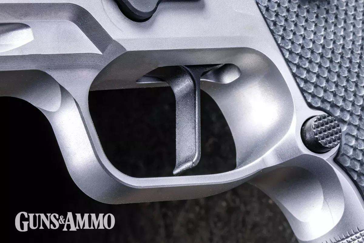

The steel blade trigger is flat-faced with a subtle finger hook at the bottom. Note the triggerguard undercut, enabling a high grip. (Photo by Mark Fingar)

The P320-XFIVE SXG sports the standard P320 controls, including a bilateral slide-stop lever where both levers properly work as a slide release. The takedown lever on the left side is flat and low profile. The magazine release is steel and checkered, and it does not stick out further than the grips. Due to the size and profile of the grip, most people shouldn’t need to shift their firing grip to use the magazine release.

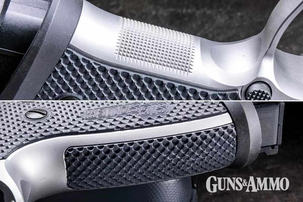

Texture on the P320-XFIVE SXG is comprehensive with LOK grips panels, backstrap, and machine checkering on the frontstrap. A high grip is possible due to the beavertail, triggerguard undercut, and magazine funnel. (Photo by Mark Fingar)
The G10 grips on this pistol are great. These thin, low-­profile grip panels are made by LOK Grips for SIG Sauer. They are G10 and have aggressive texturing. The backstrap under the web of your hand matches the grip panels. On the front of the grip module, there is a small section of checkering in the stainless steel. Between the weight of the gun and the aggressiveness of the grip, the P320-XFIVE SXG will not shift in your hands when shooting.
Inside the triggerguard there is SIG Sauer’s new blade trigger. It is steel and black, with a wide flat face. It fires close to 90 degrees.  G&A’s sample had a long rolling break, with a total pull weight of 41/4 pounds. Honestly, it doesn’t rise to the level of a true competition-­grade trigger, but it is far better than a standard P320 trigger. It is a reminder that the P320-XFIVE SXG is not a custom gun. Rather, it is a factory gun with some unique features that make better suited for competition. The steel magazine well provided a generous opening and a smooth surface to guide mags in with speed. It is removable, if you prefer.

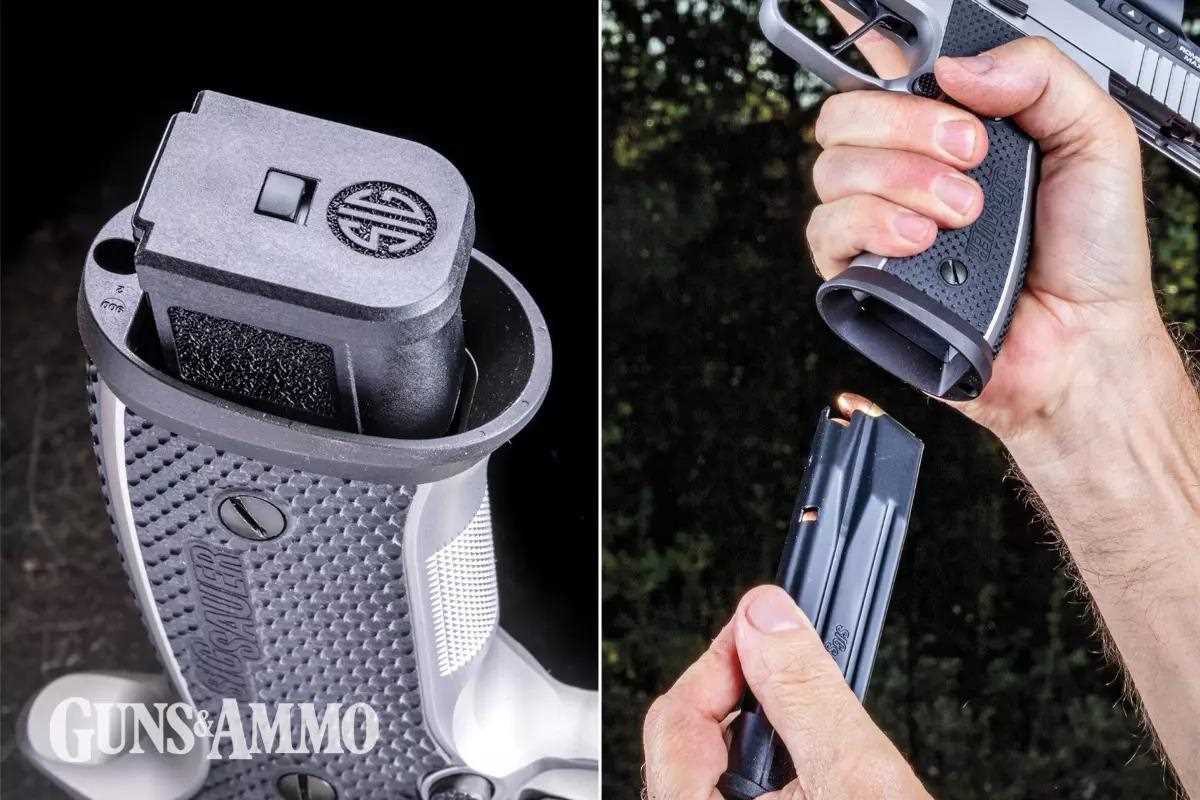

Three, 21-round magazines are supplied with the P320-XFIVE SXG, each having a textured basepad that extends beyond the bottom of the magwell for confident speed reloads. (Photo by Mark Fingar)

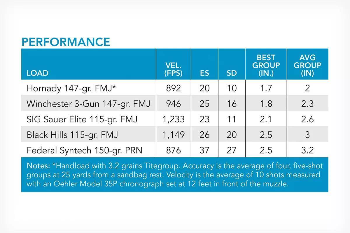

At the range, the P320-X­FIVE SXG proved reliable and more than accurate enough for competition. We did some shooting with the optic, but accuracy testing with the standard sights. The narrow front sight was about 8-MOA wide, whereas most front sights are 12- to 15-MOA wide.
It is a big, heavy gun, so recoil was as soft as one would expect — especially with a dedicated USPSA 9mm handload. SIG Sauer’s Team Captain Max Michel and other competitors have been winning local, state, and national matches with various models of the P320 for years. That trend is sure to continue with the P320-X­FIVE SXG.
