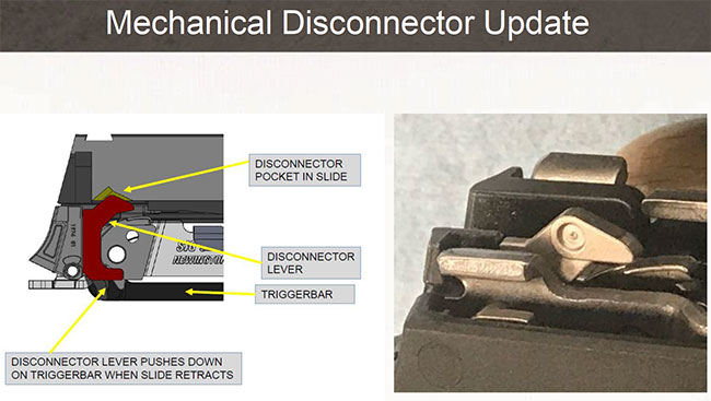

  • New mechanical disconnector, which looks like a small dinosaur head and is visible at the top rear portion of the removable chassis.

SIGP320MechanicalDisconnectorUpdate

SIG SAUER is offering a voluntary program for P320 pistols.  This will include an alternate design that reduces the physical weight of the trigger, sear, and striker while additionally adding a mechanical disconnector.

The new design has a physically lighter trigger, sear, and striker assembly with the addition of a mechanical disconnector.
