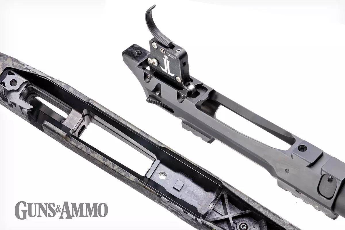

The receiver footprint is unique to Seekins Precision and it creates copious contact with the stock’s mini-chassis. Contact is secured by the action screw thread engagement and three flats seen on the receiver’s bottom. The stock integrates a machined aluminum mini-chassis that mates to the receiver. A lug protrudes from the chassis into a recess underneath the receiver. (Photo by Mark Fingar)

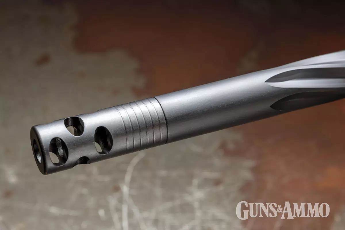

The PH3 barrel features a 5/8-24 threaded muzzle to mount a muzzle device or suppressor. Seekins installs an effective radial muzzlebrake to each barrel. (Photo by Mark Fingar)

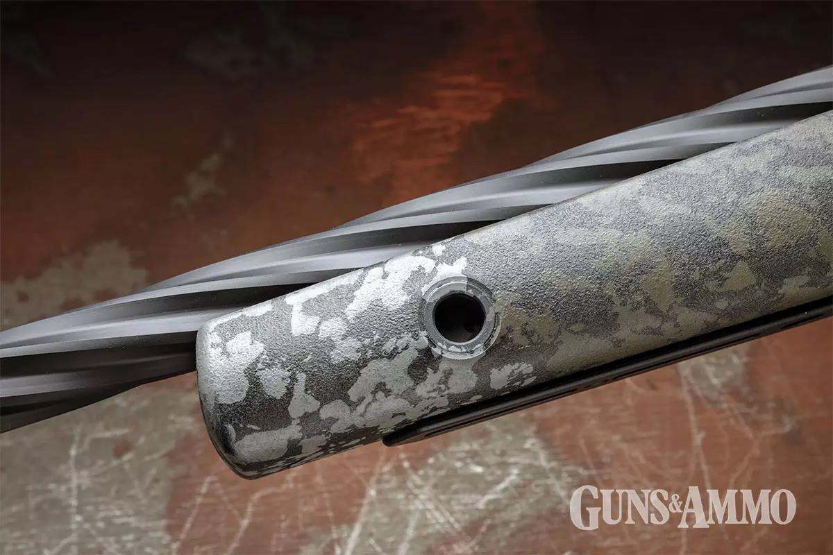

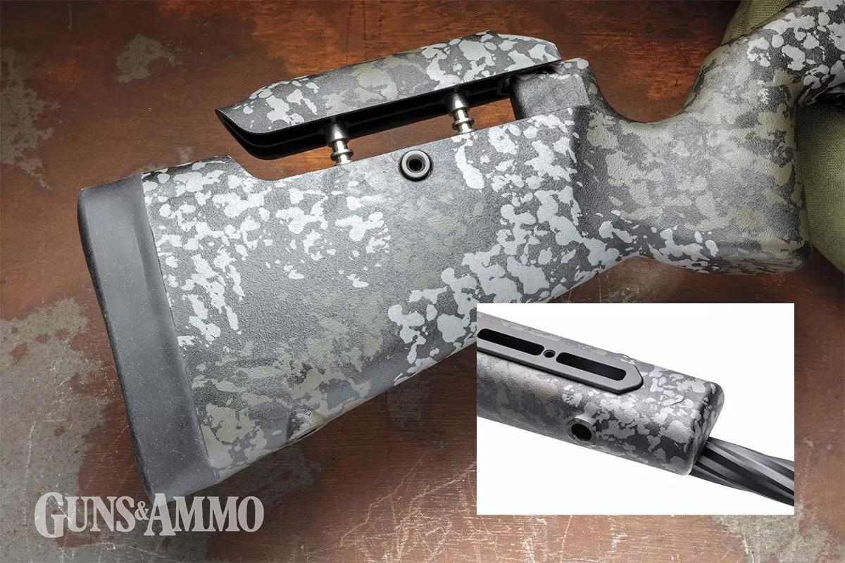

The stock has an adjustable comb and flush cups for sling mounting under the toe and on each side of the forend. The forend also hosts two M-Lok slots that can be used to attach a bipod. (Photo by Mark Fingar)
The PH3 fixes those issues and brings several capabilities that aren’t possible anywhere else. The PH3 has a footprint unique to Seekins rifles. There are three angled flats on the bottom of the receiver that match with flats of the mini-­chassis in the stock. When combined with the three-­fold increase in action screw engagement, the PH3 is more thoroughly immobilized in the stock than a Model 700 footprint. Seekins’ rifles have a reputation for exceptional accuracy, and the action’s footprint is a big reason why. The receiver is held so firmly that Seekins’ rifles will rarely — if ever — throw unexplained flyers when shooting groups.

The stock and bottom metal are Seekins’ own, which tip the scales at an even 3 pounds. The stock is made from carbon-fiber composite, and it has an aluminum mini-­chassis inside. There is also a section of M-­Lok along the underside of the forend to keep it clutter-­free while also supporting the option to attach a bipod or tripod. The stock has an adjustable comb, which allows the PH3 to comfortably fit almost any shooter/scope combination.

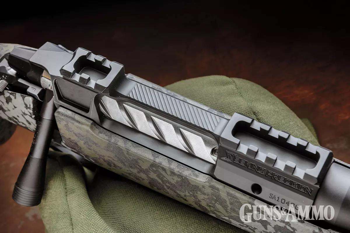

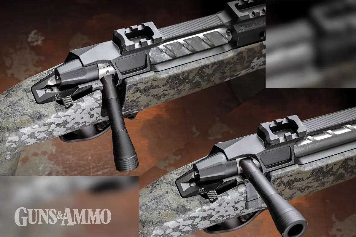

The biggest change from the Havak PH2 and PH3 was the move to a 60-degree bolt lift. This keeps the bolt handle away from the scope, so even the largest ocular housings pair well with the PH3. (Photo by Mark Fingar)

The real value of the PH3 comes when considering its many relevant capabilities. It has a three-­lug bolt, so only 60 degrees of lift is required to open the action. Normally, a three-­lug action is harder to open than a two-­lug; three-­lug bolts have to do the same amount of work in 60 degrees as a two-lug bolt with a 90-­degree. However, Seekins’ engineers made a couple of significant efforts that made its bolt assembly easier to open than even most two-­lug actions. The first significant design change was to wrap the firing pin spring around a bearing instead of around the firing pin as is typical. This approach allows the spring to spin independently of the firing pin. When opening the action, the bolt body rotates, but the firing pin doesn’t. This usually means the firing pin spring drags along the inside of the bolt body, which creates felt resistance. The use of a bearing means that the spring spins freely, eliminating any resistance to the bolt body’s rotation.

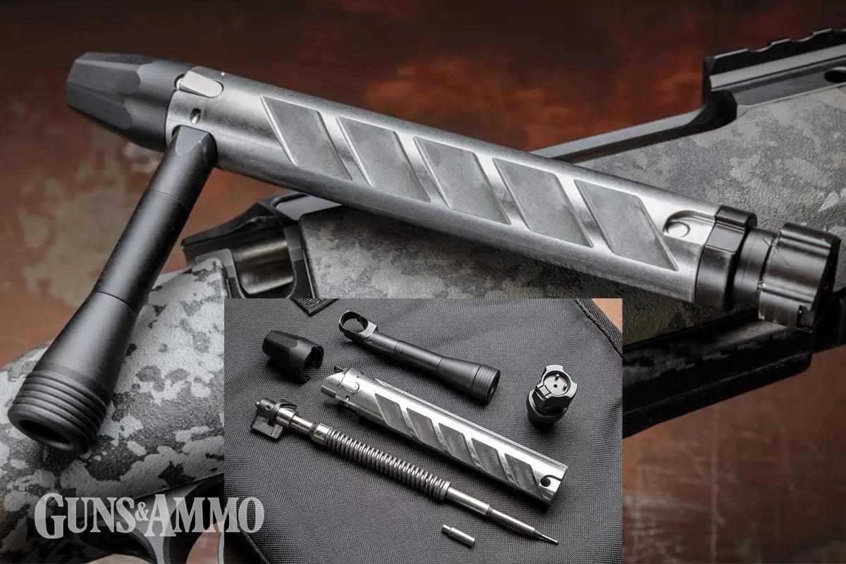

The three-lug bolt enables the short 60-degree lift. The bolt includes dual ejectors, extractor, and small-diameter firing pin. (Photo by Mark Fingar)
The second engineering feat was the use of dual helixes where the bolt body and cocking piece meet. Lifting the bolt to open the action pulls the cocking piece and firing pin rearward. More than 90 percent of bolt-­action rifles have a single angled ramp cut into the back of the bolt body, so opening the bolt drives the cocking piece up that ramp. Seekins uses dual helixes on the bolt body that match the two surfaces on the cocking piece. Using both sides of the bolt body keeps the firing pin centered in the bolt body and the helixes spread the load across the entire angle instead of just loading it all on a single point. The result is less resistance when opening the bolt. I called Glen Seekins when evaluating this rifle to ask him about the light bolt lift, and to discuss its features.

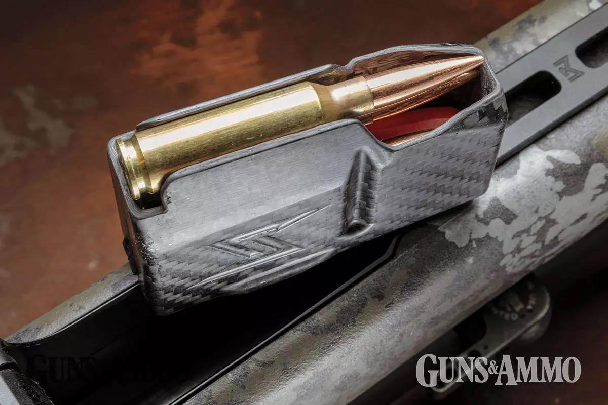

Seekins Precision makes the three-round, center-fed, carbon-fiber magazine that ships with each rifle. Common-use AICS-pattern magazines also work in the Havak PH3. (Photo by Mark Fingar)

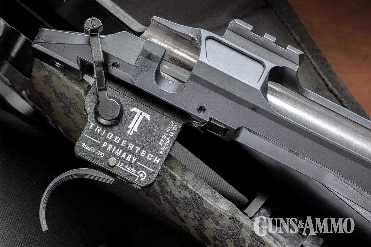

Within the triggerguard is the TriggerTech Primary, which adjusts between 1 pounds, 8 ounces, and 4 pounds with a crisp let-off. Integral to the triggerguard front is the magazine release. (Photo by Mark Fingar)

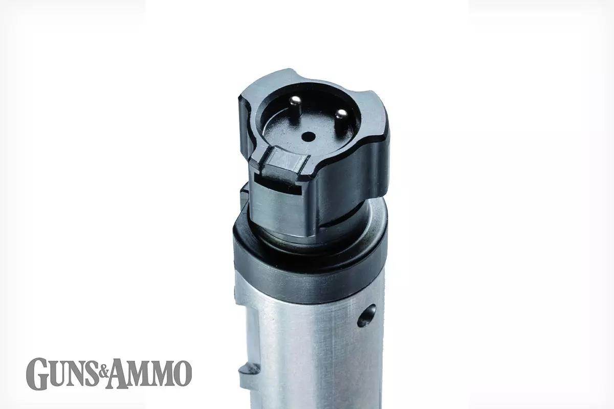

The bolt also offers toolless disassembly, so getting the bolt apart for maintenance is a snap. The bolt head is removable, so it’s also possible to chamber the same short-­action receiver in everything from .22 Creedmoor to 6.5 PRC. (I wouldn’t be surprised to see .223 Remington pop onto the menu at some point.)
Realizing that caliber interchangeability is a good thing, Seekins also made it possible to quickly ­change barrels. Barrels only need to be threaded into the receiver and tightened to about 10 foot-­pounds (ft.-lbs.). There is a small clamping mechanism built into the bottom of the receiver where the barrel threads into it. That clamp only requires 20 inch-­pounds (in.-lbs.) to firmly hold the barrel in place. The Havak PH3 — thanks to the removable bolt heads and the quick-­change barrel system — can be re-­barreled or caliber-­changed with basic tools. While no one is likely to change barrels on a regular basis, it is likely that many of us will benefit from the ease to replace a shot-­out barrel or set up a PH3 to experiment with a new cartridge. No gunsmith services required!

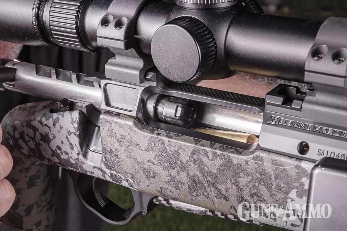

The receiver sports integral scope bases, but it features an opening over the top of the bolt to allow for top-feeding the action. Making scope rings is how Seekins Precision got its start. (Photo by Mark Fingar)
