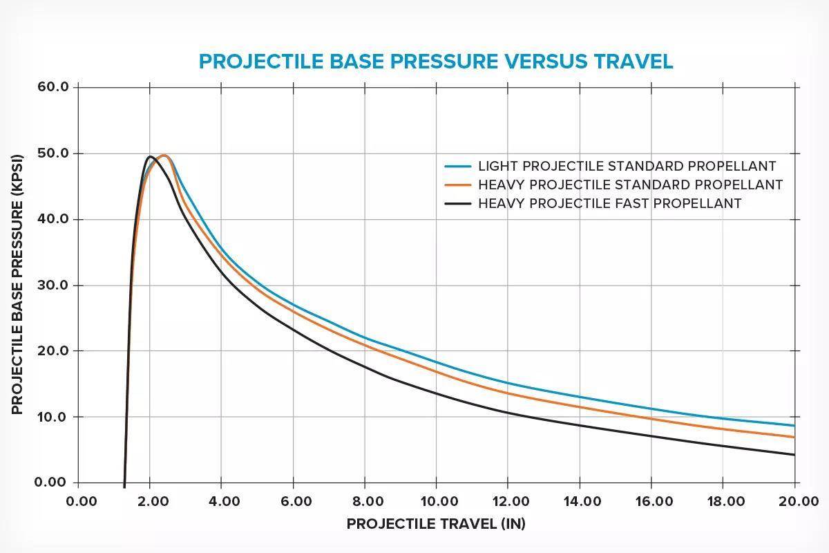

Figure 1. Projectile Base Pressure vs Travel
Notice the large difference in pressure at a 20” muzzle location for a standard AR 15 versus a 10.0” muzzle location for an SBR AR platform, 7,800 psi versus 17,500 psi. Also take note of the pressure difference between a gas port at 14” and 7”, 11,500 versus 23,000 psi. If the gun is suppressed there is much higher pressure gas going into the suppressor and a lot of unburned powder versus the 20” barrel. This results in a lot of carbon and residue in the suppressor making cleanup more frequent and more difficult and probably reduces the life of the suppressor.  This higher pressure in the suppressor results in much more gas and unburned propellant fragments being forced back into the action by the gas system. This in turn means the action needs to be cleaned more often and is more difficult to do. The factor of over 2 times difference in port pressure between a 14” location and a 7” location will drive the action much harder and open the bolt much sooner in the ballistic cycle. I’m not saying that an SBR won’t run on regular ammunition, because it will. It’s just not optimal.

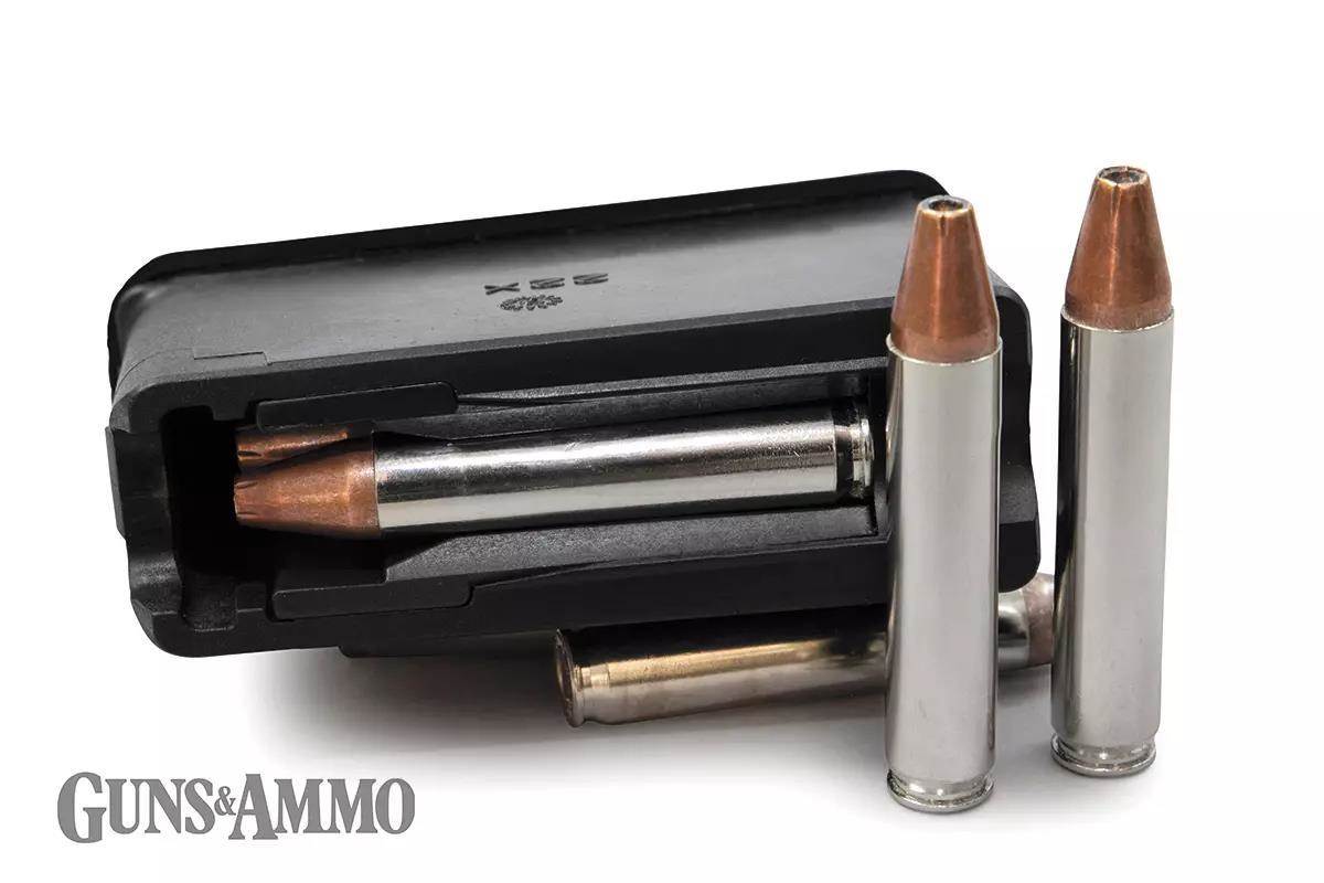

Heavy straight wall cartridges like the 350 Legend have some merit as SBR cartridges.

Figure 2. Light versus Heavy Projectile with Standard Propellant and Heavy Projectile with Fast Propellant Base Pressure versus Travel
Notice the base pressures for a light bullet are higher than the heavy bullet. Light for the caliber loads at full velocity with “standard speed” propellants will result in higher port and muzzle exit pressures. Fast propellants can be used with light projectiles to reduce bore pressures, but many times the reduced charge weights along with a light bullet can result in unreliable functioning. It is much easier to find a happy middle ground with a heavy bullet and fast for projectile weight powder at reduced charge weights as compared to a “standard” speed propellant.
Generally speaking, if a load shows full velocity for the bullet weight from a standard length barrel, I would argue it is not optimized for an SBR. A true SBR load is strictly designed around a shorter barrel and may not have enough gas volume in a longer standard rifle length barrel to reliably run the gun or produce full velocity for that bullet weight in the standard length barrel.
The optimum loads for an SBR, especially a suppressed SBR, are heavy-for-caliber bullets with fast (for the bullet weight) propellants. This combination results in lower, more manageable port pressures, better action timing, and lower muzzle exit pressure. These things combine to provide a better functioning and cleaner running firearm and suppressor, less recoil and longer case life if you reload.

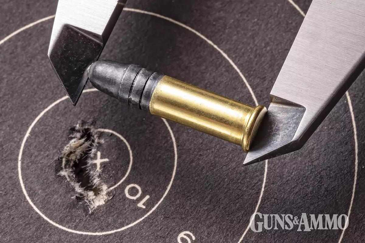

Don’t look past the 22 Rimfire. Firearms are reliable and relatively inexpensive and of course available as semi-auto or fixed breech. Barrels are easy for a gunsmith to shorten to 16” and thread the muzzle. Virtually every 22 Rimfire ammunition provider offers several subsonic loads. Some manufacturers offer standard velocity loads that are advertised as suppressor friendly. Most standard velocity 40 grain projectile .22 LR loads are suppressor friendly as the propellant is completely consumed by 14” – 16” of travel. 22 Rimfire provides a lot of inexpensive shooting, and would be a very good entry into the suppressor game. Additionally, subsonic .22LR loads in a suppressed firearm are virtually silent.

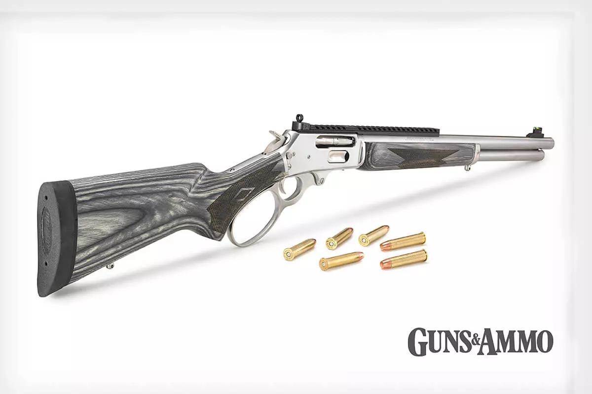

The return of the 1894 Marlin by Ruger opens up some interesting options for someone wanting to dabble with subsonic loads and a suppressor, but maybe not go the whole way to acquiring a full on SBR. Ruger offers the 1895 Trapper model with a 16-inch barrel and the muzzle threaded for a suppressor. It offers models chambered in .357 Magnum, 10 mm Auto and .44 Magnum. You won’t find subsonic factory ammunition for any of these loads at this point in time, but a motivated handloader can easily load the heaviest for caliber bullets in each caliber to subsonic velocities. .38 Special or .44 Special can certainly be loaded to subsonic velocities if they will function through your gun. Virtually any load in these calibers will work well because they are designed for barrels much shorter than 16 inches. These guns also offers some interesting options to someone wanting to hunt quite in short range hunting environments. Most of the hollow point bullets available for these cartridges will expand in the 1,000 – 1,050 fps muzzle velocity range and provide deep penetration. The Hornady Subsonic line also offers some other interesting fixed breech options with a 30-30 Winchester, 350 Legend and 45-70 subsonic loads among several others. Throwing the old Thompson Center Contender and Encore firearms into the mix opens up a lot of possibilities for someone wanting to tinker.
