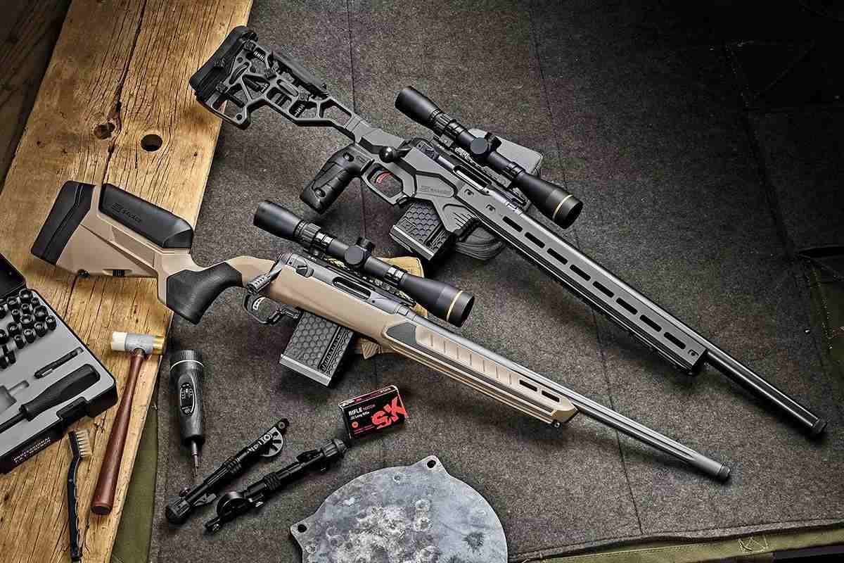

The legendary Savage 110 bolt-action rifle has been totally redesigned and modernized for 2026, and part of that redo includes three brand-new .22 rimfire variants. We got our hands on early versions of two of the new rimfire rifles, and we’re pleased and honored to give readers of this special publication the first look at them.
The three .22 rimfire Model 110 rifles are called the Elite Precision, the Core Tactical, and the Magpul 110 RF rifles. We received the Elite Precision and Core Tactical variants, so let’s take a good hard look at them.

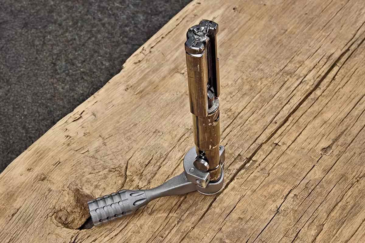

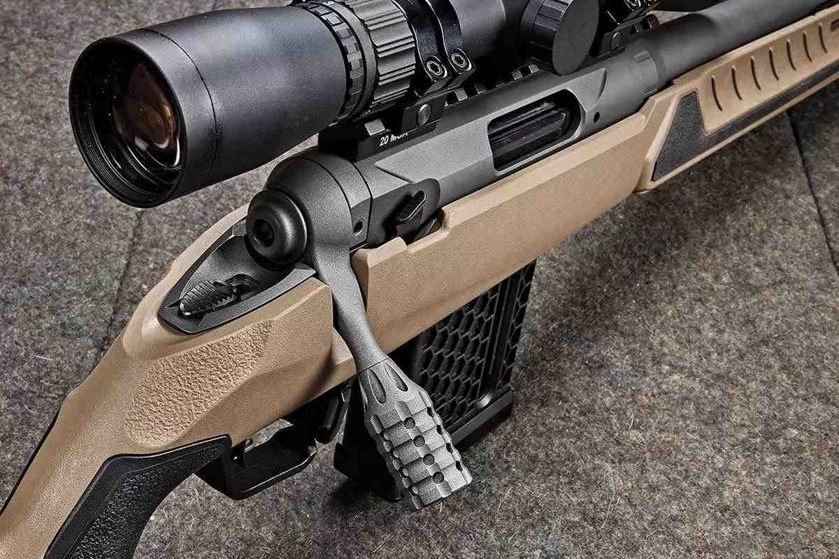

Core Tactical bolt with fluted, elongated bolt knob
The bolts have front locking lugs and switchable front baffles that allow the bolt throw length to be as long as that for a .308 Win. or as short as for a typical .22 LR. Shown is the Core Tactical’s bolt with fluted, elongated bolt knob. (Photo by Michael Anschuetz)
One of the most interesting features of these rifles is their full-length Model 110 actions with adjustable bolt throw lengths. They come with switchable front baffles that allow the bolt throw length to be either a .308 Winchester length or a shorter .22 rimfire bolt throw length. These rifles are intended to serve duty as straight-up rimfire competition and hunting rifles as well as rimfire trainers, hence the flexibility to have either bolt throw length.
The bolts of both rifles have front locking lugs, and they lock up with the Model 110 action just like centerfire Model 110s. The Elite Precision has a large round bolt knob, whereas the Core Tactical’s bolt knob is elongated and fluted. And the bolt handles are threaded for attachment of the bolt knob, making them ripe for customizing. The pitch is 5/16-24.

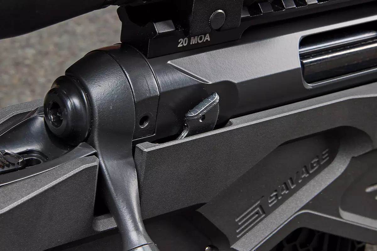

three-position safety on the Savage 110 RF rifle
The three-position safety on the new 110 RF rifles is located on the tang. Forward is the “Fire” position, and rearward is the “Safe” position, which blocks bolt lift and trigger movement. The middle position blocks trigger movement but allows the bolt to be moved for unloading. (Photo by Michael Anschuetz)

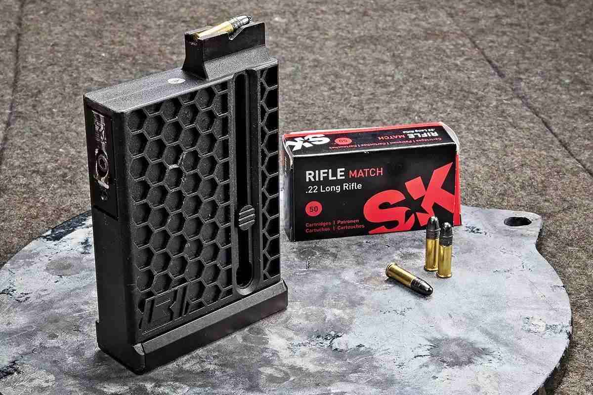

Both rifles utilize L3i AICS-style detachable magazines, and the magazines hold 10 rounds of .22 LR ammunition. Loading the magazines was quite easy, thanks to the assist buttons located on the right-hand sides. The magazine bodies are injection molded from premium glass-reinforced polymer, and the baseplates are billet-machined 6061-T6 aerospace-grade aluminum finished with Type II anodizing.

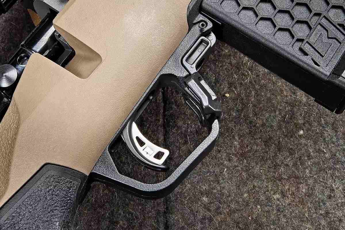

Both rifles come with Savage’s proven user-adjustable AccuTrigger. The AccuTrigger features a safety blade incorporated into the trigger’s fingerpiece, and that prevents full rearward movement of the trigger until the blade is fully depressed. The pull weight on both sample rifles averaged 1 pound, 9 ounces for five measurements each with an RCBS trigger pull gauge. And they were incredibly consistent. My gauge did not detect any variation whatsoever over all those measurements.

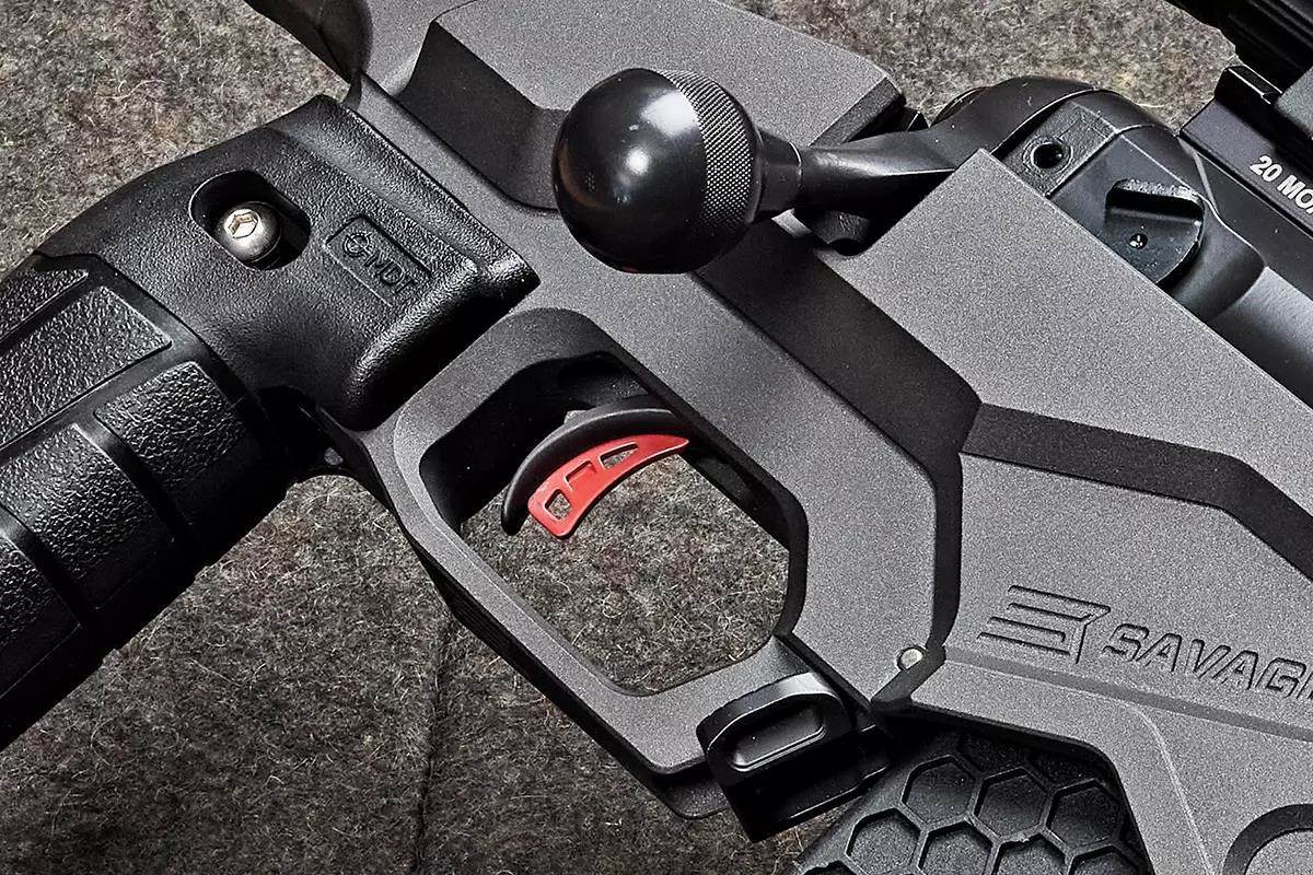

The Elite Precision 110 RF comes with an MDT Gen 2 ACC Chassis stock. The stock is CNC machined 6061-T6 aluminum, and it is fully adjustable, including the vertical grip angle, the length of pull, and the cheek rise height. The underneath side of the fore-end has a full-length ARCA rail with M-LOK slots, and the sides feature M-LOK slots. The top, on both sides of the barrel channel, has drilled-and-tapped holes for bridges and other such accessories. QD sling cups are located on the buttstock, and the buttstock also has an M-LOK slot underneath. Obviously, this chassis system is very well built and offers a lot of adjusting and accessorizing for competition shooting.
 L3i AICS-style magazine next to a box of .22 LR ammo
The rifles use special L3i AICS-style magazines made of glass-reinforced polymer and 6061-T6 aluminum that hold 10 rounds of .22 LR ammo. (Photo by Michael Anschuetz)

adjustable AccuTrigger on Savage 110 RF rifle
The 110 RF rifles come with Savage’s well-established adjustable AccuTrigger with built-in safety lever. The Elite Precision’s trigger (shown) and the Core Tactical’s trigger had extremely consistent trigger pulls, each averaging 1.56 pounds of pull as tested. (Photo by Michael Anschuetz)

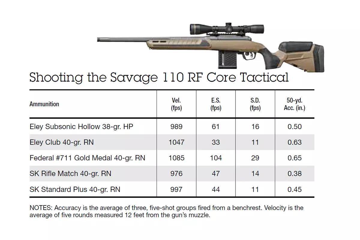

As you can see, I test-fired .22 LR match, hunting, and plinking loadings in both rifles. A total of five different ammo types was fired in each rifle. I have to admit the results are somewhat boring—as in very precise and very consistent. I was not surprised with how well these rifles shot. I did the shooting at 50 yards, outside (see what Simpson says about shooting outside and how even a slight wind can skew accuracy with the .22 LR), but in the most sheltered part of my stand of timber. It was very still as far as wind conditions go. I’ve said it many times, but to reiterate, I am not a champion shooter. At best, I am an average shooter with mediocre skills. Still, I achieved excellent accuracy with these rifles.

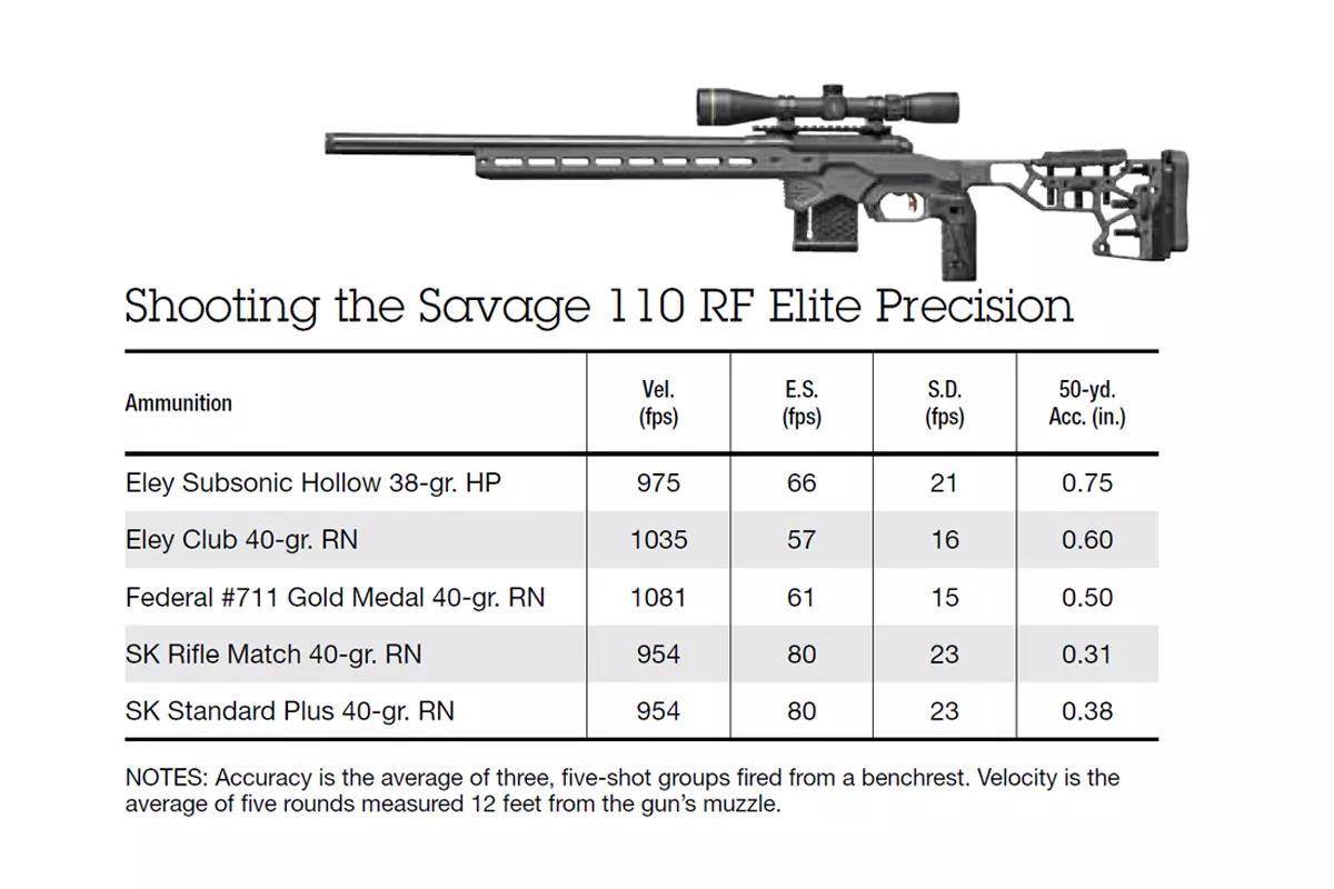

The Elite Precision 110 RF averaged 0.51 inch for five-shot groups with all loads. With the match loads only, the average was 0.41 inch. The best-shooting loading for me in this rifle was the SK Rifle Match, and it averaged 0.31 inch for five-shot groups at 50 yards.
The Core Tactical 110 RF averaged 0.52 inch for five-shot groups with all loads. With the match loads only, the average also was 0.52 inch. And the SK Rifle Match turned in the best accuracy in the Core Tactical rifle too. Its average in this gun was 0.38 inch for five-shot groups at 50 yards.
By the way, I used the bolts’ front baffles so that both rifles had the shorter .22 LR bolt throw length. The Elite Precision was a bit more accurate overall than the Core Tactical, but oddly, the Core Tactical produced better accuracy with one load. It was the Eley Subsonic Hollow loading, and I don’t have a good explanation for why I shot it better in the Core Tactical than in the Elite Precision. I suppose I may have introduced some sort of shooter error when shooting it in the Elite Precision, but if I did, I sure didn’t notice it.

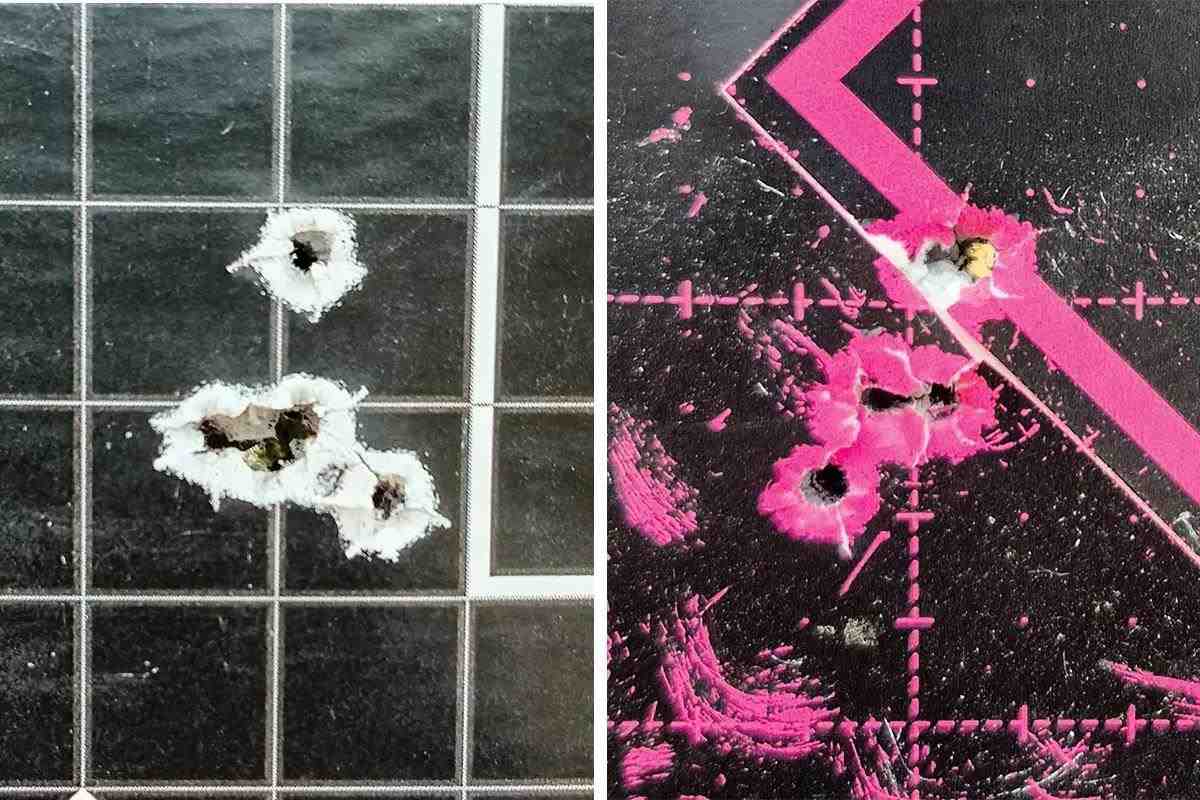

targets showing shot groups at 50 yards
Both rifles achieved excellent accuracy for five-shot groups at 50 yards with the match ammo, hunting ammo, and plinking ammo tested. (Photo by Michael Anschuetz)

Savage 110 RF Elite Precision accuracy chart

Shooting the Savage 110 RF Core Tactical accuracy chart
