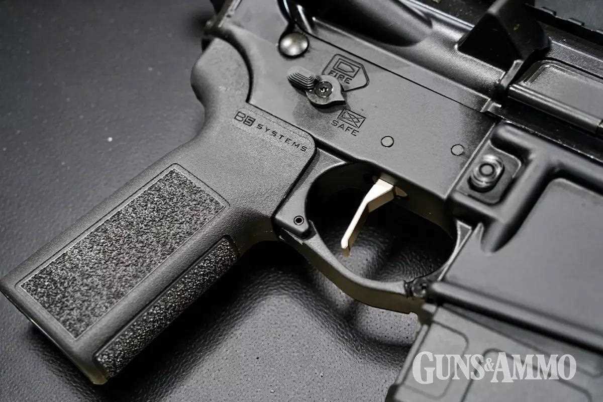

Controls and features follow the trend of the new SAINT Victor rifles, including a B5 grip, 45-degree safety selector, and flat-faced nickel boron-coated trigger.

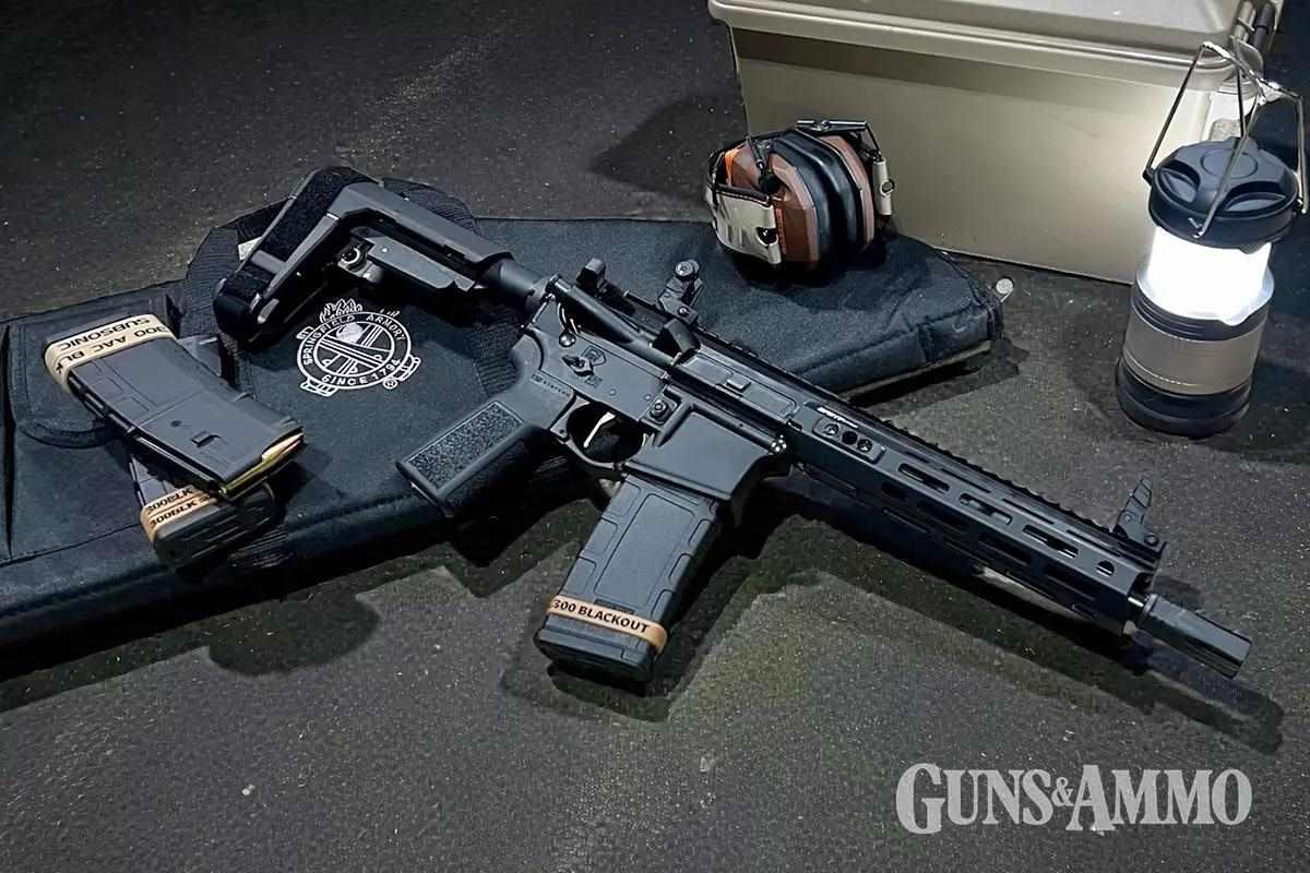

I was happy to see that the pistol comes with two .300 BLK Gen M3 PMAGs. It would have been easy to throw in a couple of 5.56 mags and call it a day, so the extra effort was appreciated. Controls are the same found on the other new SAINT Victor rifles and pistols, with a B5 grip, 45-degree safety selector, and nickel boron coated flat-faced trigger.

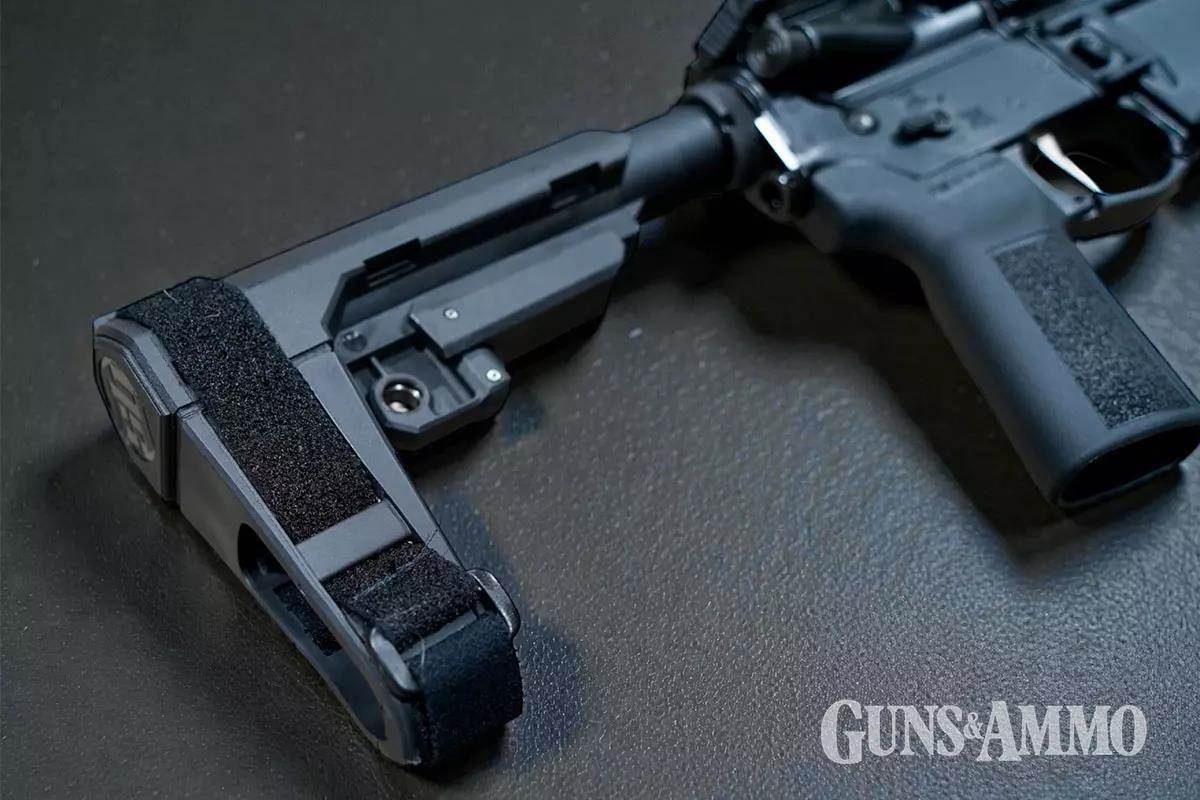

As this model is a pistol, rather than an SBR, the B5 Sopmod stock found on new Saint rifles has been swapped with an SBA3 pistol brace from SB Tactical. The barrel is a 1:7 twist rate, made from 4150 chrome-moly vanadium steel, and threaded 5/8x24 at the muzzle.

The SAINT Victor pistols ship with an SBA3 brace from SB Tactical.

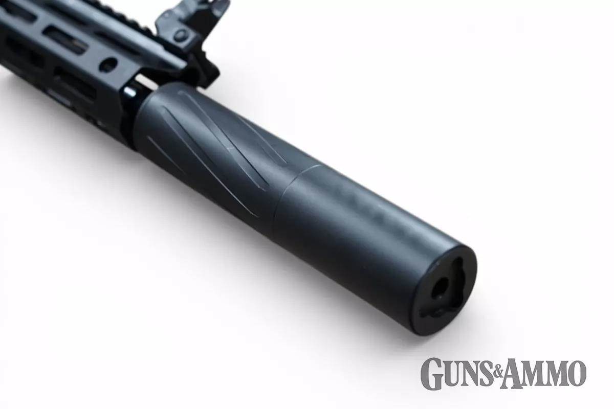

For the next range trip, I removed the three-prong flash hider and mounted a BANISH 30-V2 via direct-thread. The suppressor was changed to it’s shorter configuration by removing two of the baffles, which helped keep the length of the pistol down. While this may reduce overall sound suppression, subsonic rounds are quiet enough as-is that I belived it would have been overkill to keep it full size.

A BANISH 30-V2 in short configuration was mounted via direct thread for suppressed and subsonic testing.
Subsonic loads were a bit finicky, as is the case with this cartridge, though I quickly found a goldilocks round in Hornady’s 190 gr Sub-X rounds. Out if 90 rounds, I found no malfunctions or any issues with blowback. I'd like to get some more testing done with different ammo as well, and run through a few more mags of Sub-X to confirm. During a cursory take down, I saw that Springfield opted for an H2 buffer weight. As the gas system is fixed, swapping this weight is a solid option for tuning performance if you’re deadset on using a particular subsonic round.
