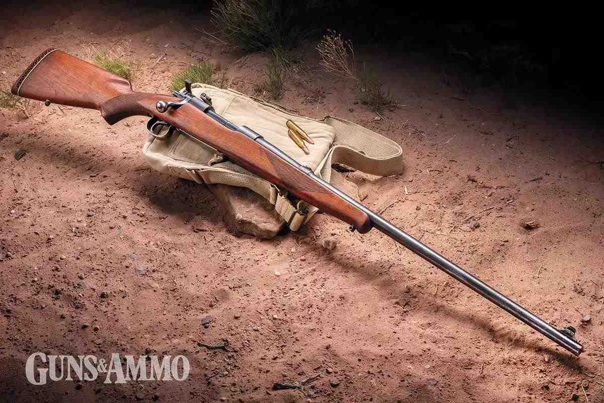

Winchester Model 54(Photo by Mark Fingar)

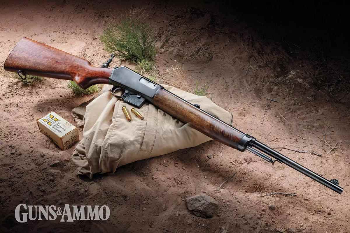

Winchester Model 1907(Photo by Mark Fingar)

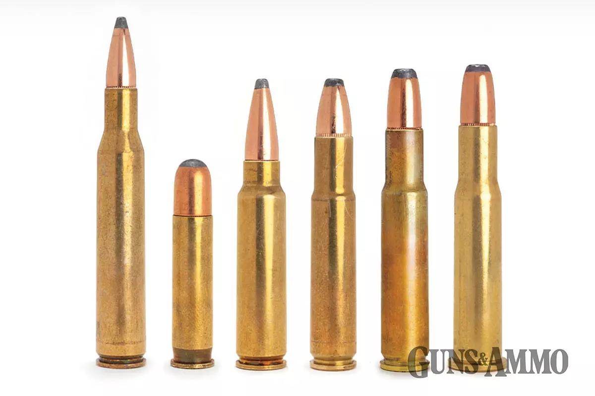

From left to right: .270 Win, .351 WSL, .300 Savage, .32 Rem, .30 Rem, .-30-.30 WCF (Photo by Mark Fingar)
Lever-­action cartridges such as the .30-­30 Winchester, .35 Remington, .33 Winchester and similar rounds fed into Winchester’s Model 1886 and 1894 rifles had displaced the older blackpowder cartridges by the turn of the century. The 1895 Winchester introduced high-­performance smokeless cartridges by chambering the 7.62x54R, .30-­’06 Springfield and .405 Winchester in a commercial rifle — albeit a lever-­action. Just before and after World War I, improvements in smokeless propellants began the push for even higher performance, flat-­shooting cartridges to take advantage of new bolt-­action rifle designs.
The .30-­’06 evolved from the .30-­’03, introduced in 1903. The ’06 was a powerful cartridge for the time, and first offered in the Winchester 1895 lever-­action along with several other smokeless cartridges. In 1921, it was offered in the bolt-­action Remington Model 30. Some custom bolt-­action rifles chambering the .30-­’06 were built on imported commercial Mauser actions.
“Wildcatting,” i.e., the development of higher-­performance cartridges, began shortly after smokeless powder and jacketed bullets became publically available in the 1910s, championed by Charles Newton. Powders and jacketed bullets available at that point were limited compared to today. Introduced in 1915, the first commercial cartridge to achieve 3,000 fps was the .250-­3000 Savage with an 87-­grain bullet.
gaad-100-yr-hunt-13
The .300 Savage was introduced in 1920 and based on the same case as the .250 Savage. It was a very compact round that nearly matched the .30-­’06 Springfield’s 150-­grain load. As mentioned, the .270 Winchester was introduced in 1925, loaded with a 130-­grain bullet at an advertised velocity of 3,160 fps. With the powder speeds available, I won’t conjecture at what the operating pressure of that round was. Current specs for a standard .270 Winchester 130-­grain load are 3,060 fps. The .270 Winchester cemented the fast, flat-­shooting hunting round in the American shooter’s mind. Professor Jack O‘Connor became the champion of this movement as a writer for “Outdoor Life” magazine, and later as the executive editor of “Petersen’s Hunting.”

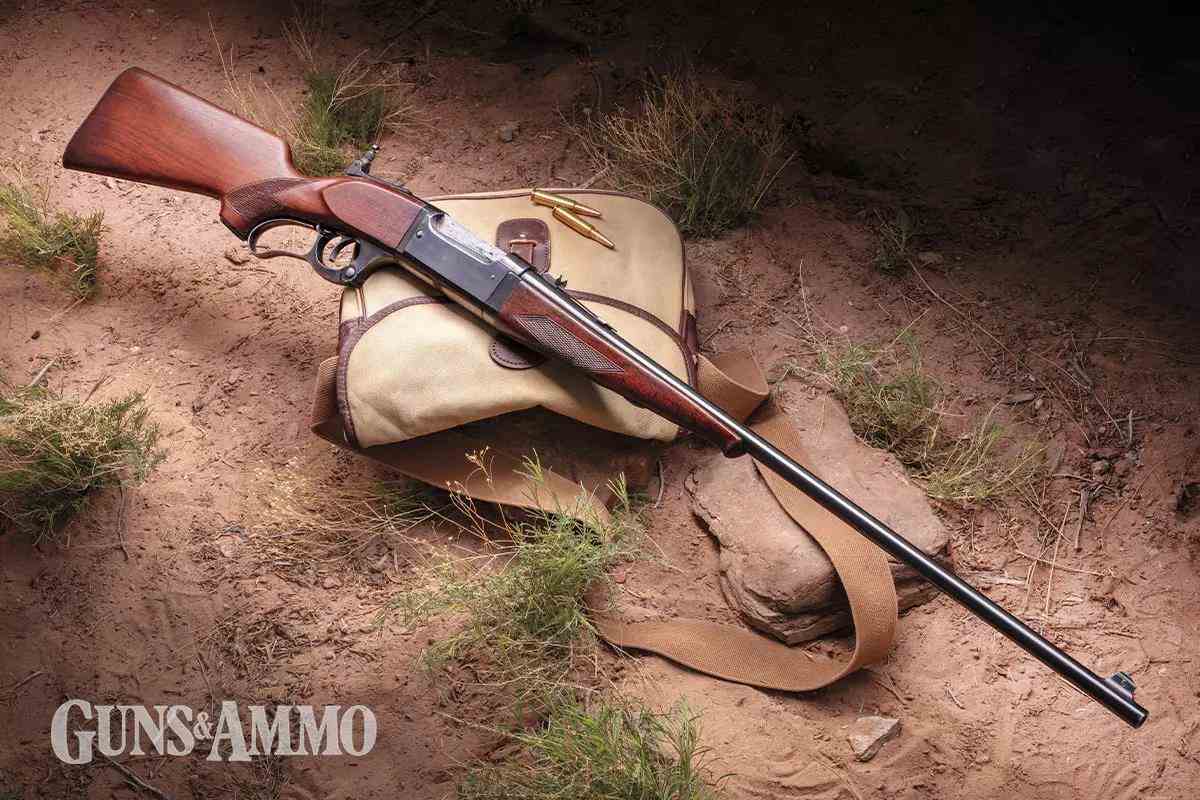

Savage Model 1899 (Photo by Mark Fingar)
The .30-­40 Krag became popular in the 1920s, but not due to its performance characteristics. Low-­cost rifles such as the Krag-­Jørgensen bolt action was prevalent on the surplus market as the U.S. Army sold its Krags at the conclusion of World War I.

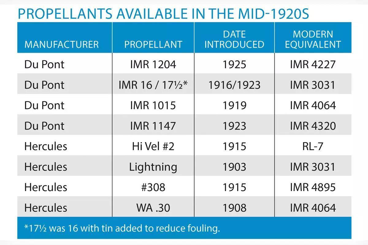

The primary suppliers of smokeless propellant in the U.S. during the 1920s were Hercules Powder Company and Du Pont Improved Military Rifle (IMR) Powder. Hercules was the more dominant supplier of pistol and shotgun powders, while IMR had the larger share of the rifle market. Since 2003, IMR is owned by Hodgdon Powder Company.

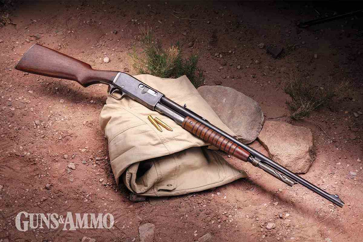

Remington Model 14 (Photo by Mark Fingar)
Table 1 shows the rifle speeds of propellant that were available in the mid-­1920s. It’s interesting to note that IMR 4064 was the slowest rifle propellant available. IMR 1147 — which became IMR 4320 — was new in 1925 and likely developed for the .270 Winchester. Ball powders did not exist yet. Ball powders were developed in the mid-­1930s to repurpose surplus World War I propellant; They weren’t offered to the public until 1960. Reloading finally became popular after World War II with the availability of good jacketed bullets from Hornady and Speer.

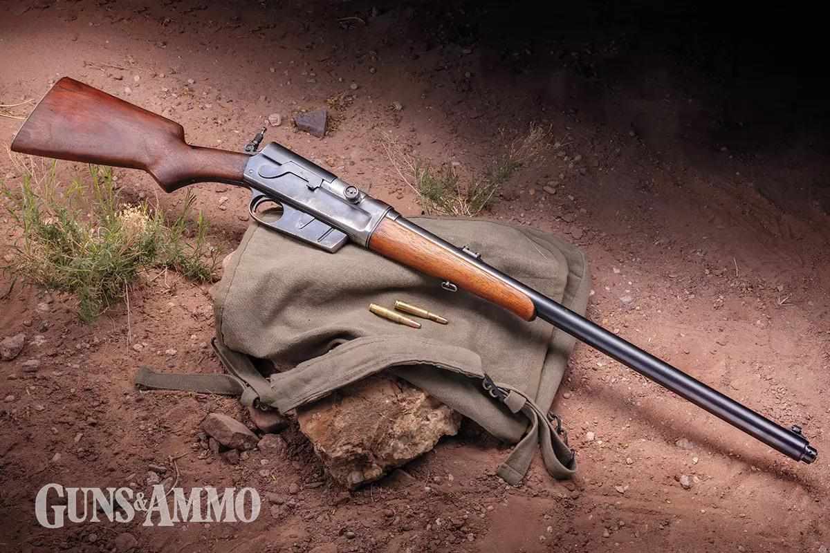

Remington Model 8 (Photo by Mark Fingar)

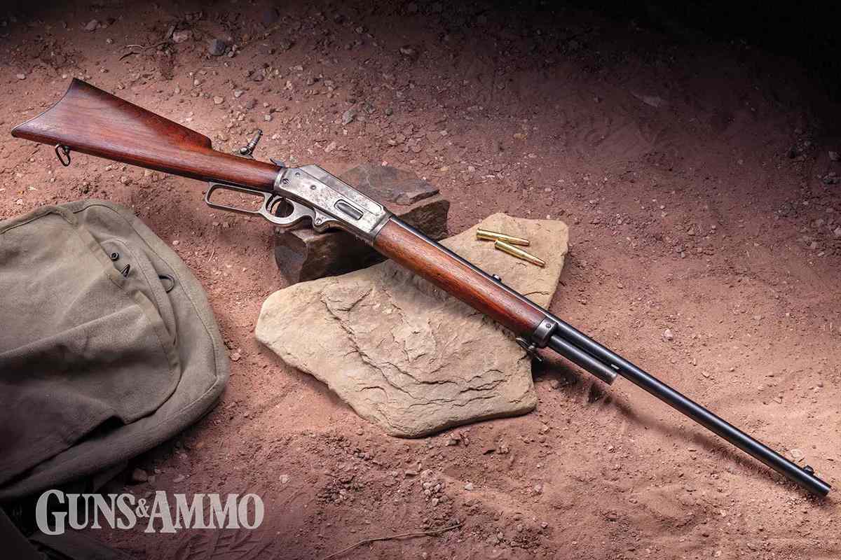

Marlin Model 1893 (Photo by Mark Fingar)

It wasn’t until Winchester introduced the Model 54 bolt-­action in 1925 that a bolt-­action rifle gained serious attention, and it’s no coincidence that the .270 Winchester cartridge was also introduced with the Model 54. Based on the Mauser design, the Model 54 was the first successful commercial bolt-­action rifle. The Model 54 led directly to the Model 70 we’re all familiar with, which was introduced in 1936. During its 11-­year production run, more than 50,000 Model 54 rifles were produced.

Several other types of firearms were popular during the Roaring Twenties. It might come as a surprise to some, but semiautomatic magazine-­fed rifles were available and popular long before bolt-­actions! Remington came out with its John Browning-­designed Model 8 semiautomatic in 1906. It featured Remington’s line of cartridges meant to compete with Winchester’s 1894 chamberings. The .25, .30 and .32 Remington were rimless versions of the .25-­35, .30-­30 and .32 Winchester. Of note, the .35 Remington was also introduced in the Model 8, and it stood the test of time. An interesting piece of history is that the Model 8, chambered in .35 Remington, was used by Texas Ranger Frank Hamer during the takedown of Bonnie Parker and Clyde Barrow on May 23, 1934.
Winchester had two semiautomatic rifles available during this time. The Model 1907 was chambered in .351 Winchester Self-­Loading (WSL), and the Model 1910 chambered the powerful .401 WSL cartridge. The Model 8 and Model 1907 were very popular among law enforcement and prison institutions of the era.

Another firearm of note was the Remington Model 14 and 14½ pump-­action rifles. Introduced in 1913, they were meant to compete against the Winchester Model 1892 and 1894. The Model 14 chambered the Remington line of rifle cartridges, while the Model 14½ chambered the .38-­40 and .44-­40 Winchester pistol cartridges. The Model 14 was followed by the virtually identical Model 141 in 1935. Approximately 200,000 Remington pump-­action rifles were made between 1913 and 1951.

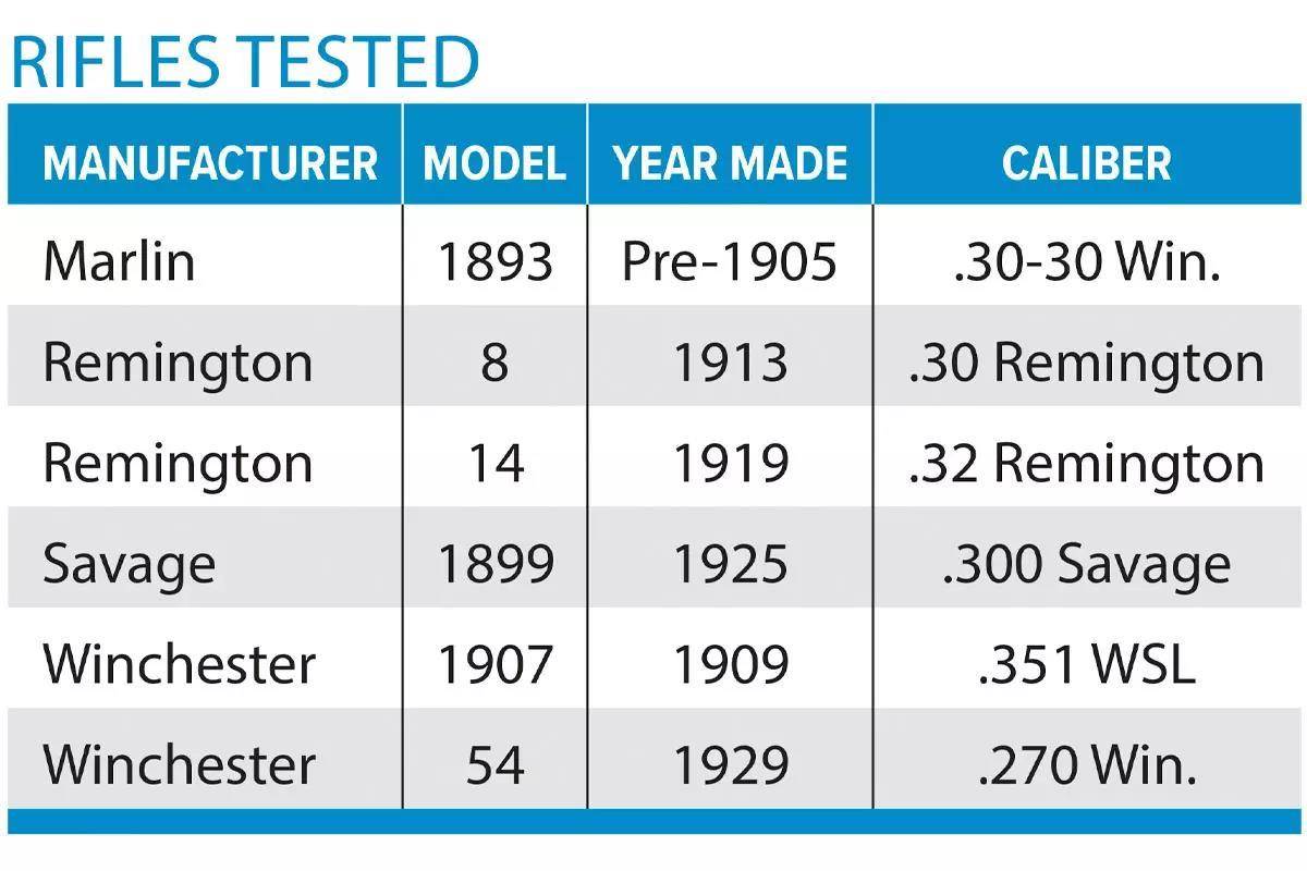

Six period rifles were obtained to evaluate the performance and handling hunters could have expected 100 years ago. Ammunition was handloaded to approximate bullet types and performance specifications known of that time period. Table 2 includes a summary of the rifles that were sourced, including when they were produced and the chambering.
Space is limited for an evaluation of this type, and we could not reasonably test every rifle available in 1925. These are a representive sampling of manufacturers, action types, and cartridges for deer hunting. Of note, I chose an 1893 Marlin in .30-­30 instead of a Winchester 1894. So much has been written about the 1894 that I’m not sure much new information could be added, so I felt it would be interesting to consider a direct competitor of Winchester’s 94. 
