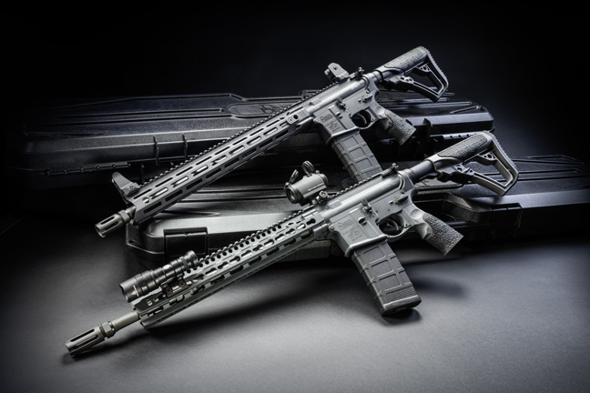

And now for the differences. While similar at first glance, these rifles are actually substantially different. First, the V11 was finished in Daniel Defense's proprietary Tornado gray Cerakote. The color is striking and is complemented with black furniture for a visually appealing and suitably low-profile package. The V11 also has a standard aluminum dustcover, while the V7 wears a polymer one. Daniel Defense informed me the polymer resists deformity better, lasts longer and is 11 grams lighter, so it is the way forward on all new DD rifles. The V11 SLW is optimized to be an extremely lightweight fighting rifle that utilizes the KeyMod accessory attachment system and a skeletonized, mid-length 12-inch SLiM rail to shroud a 14½-inch lightweight-profile barrel to keep the weight to a minimum.

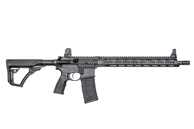

The V7 is a slightly heavier carbine than the V11 SLW because it incorporates a 15-inch M-LOK-compatible rail and a medium contoured 16-inch barrel. Everything in the world of tactics is a compromise, and building rifles is no different. The lighter weight V11 carbine sacrifices a bit of rail estate, a little velocity and longevity in exchange for increased portability. The V7 gives you additional rail space, slightly increased robustness and velocity in return for a slightly heavier total package. As the late Pat Rogers was fond of saying, "The mission drives the gear train." Figure out what your needs are and go from there.

Built from the ground up as a lightweight fighting rifle, the M4 V11 SLW cuts weight, not corners. The lightweight KeyMod-compatible rail continues the legacy of efficient DD rails and adds modularity without weight.
In practical use, there are some detectable differences. Because the barrel on the V11 is lighter, there is a slight increase in muzzle rise during shooting. In slow fire, it is almost imperceptible; however, during faster strings of fire it becomes evident. Besides the heavier, longer barrel, the V7 has an additional 3 inches of handguard mounting space, allowing us to extend our forward hand for additional control.

The M4 V7 is not as svelte as the V11, yet it remains lightweight. The handguard features the M-LOK attachment system and is longer than the V11's, providing extra mounting space for accessories and added control of the muzzle when firing rapidly at close range.
In my shooting drills, the V11 shined. Internet expertise dictates that a heavier barrel will track more smoothly, but the lighter V11 was faster on target and transitioned between targets more quickly and smoothly. Even on the shot timer, my time to target was about .05 seconds faster with the V11 than the V7. Besides that, I don't have many quantifiable reasons to tell you why, but the V11 just felt better to me. It was livelier in the hand, and I found myself defaulting to it when pushing myself through training, especially on steel or when I wanted to go fast.
