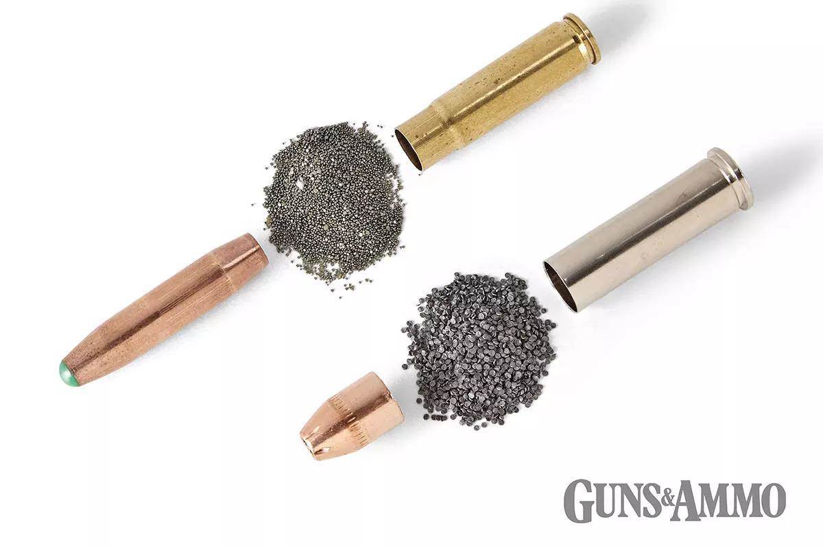

Even when fired from a suppressed SBR, standard loads can produce flash as unburnt powder escapes the chamber. Fiocchi’s SBR Enhanced line is charged with flash-suppressant powder.
SBR Enhanced
Terminal performance is an important consideration for SBR load development. Velocity affects bullet penetration and expansion, and barrel length affects velocity. Many rifle loads do not meet performance expectations out of short barrels. It’s a tricky combination. SBR ammo needs a bullet that expands at lower velocities, and it needs to be matched with the right powder to do so. The powder is symbiotic to the bullet in the case of load development.

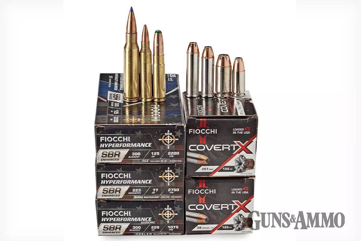

Fiocchi’s SBR Enhanced loads are available in .223 Rem., .308 Winchester, .300 Blackout, and the elusive 4.6x30mm made famous by the HK MP7. In addition to selecting the right bullet for the respective cartridge, the SBR Enhanced line is loaded with powder that incorporates a flash suppressant. Put it together and Fiocchi engineered a formula that provides superior advantages when shot through an SBR.
gaad-fiocchi-sbr-cov-05

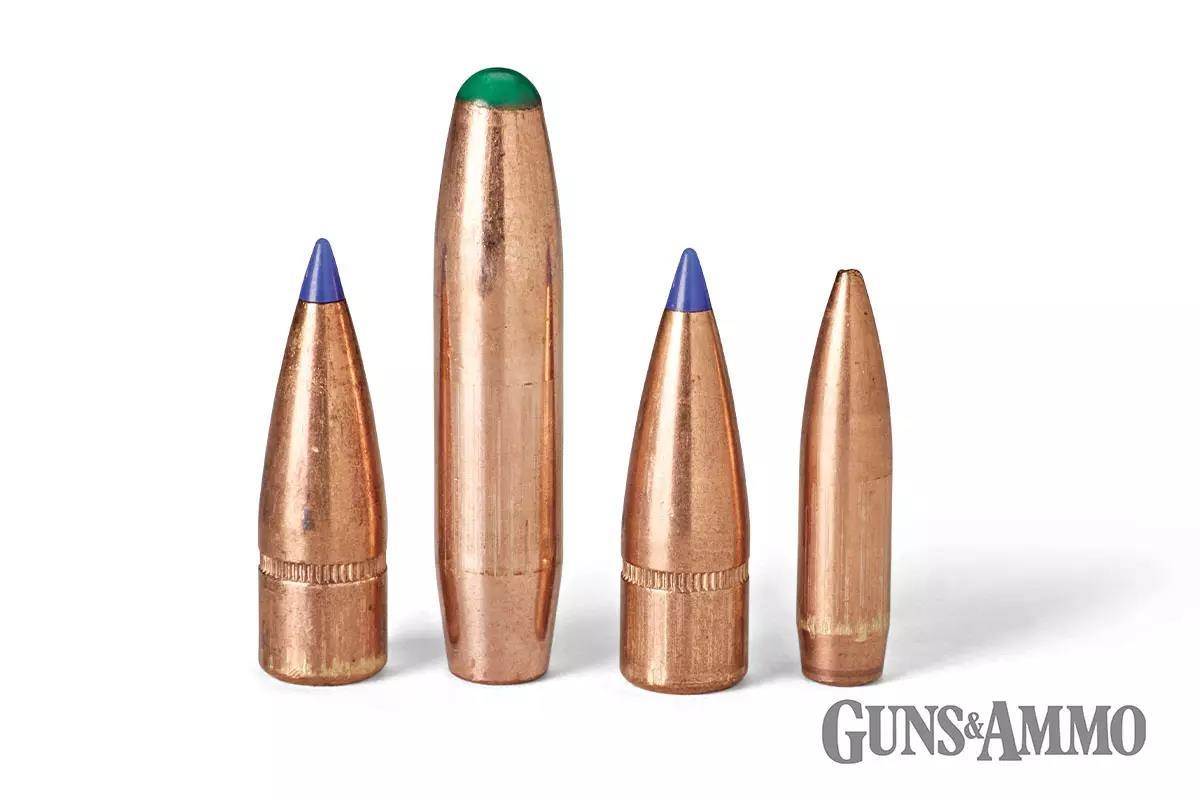

Fiocchi Hyperformance Defense SBR Enhanced ammunition is offered with blue-tip Hornady SST projectiles, a 220-grain green-tip Nosler Ballistic Tip for .300 BLK, and Sierra MatchKing bullets. SSTs are used in .300 BLK and .308 Win., and MatchKings in .223. (Photo by Michael Anschuetz)

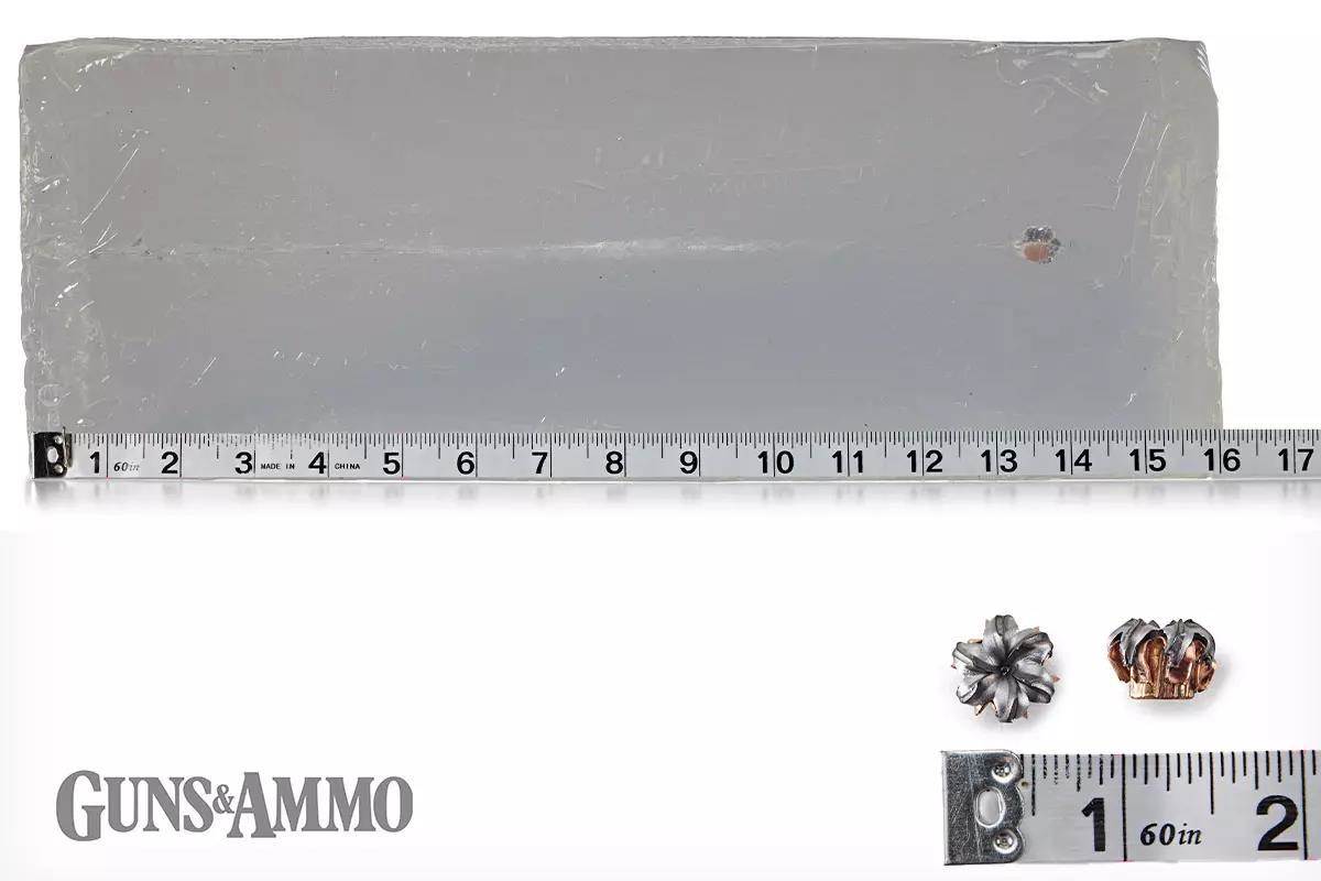

Fiocchi brought an array of SBRs to demonstrate the new ammo at the event. Dead Air Silencers  was also a presenter, outfitting our rifles with an assortment of cans. I really got excited, though, when staff unboxed Clear Ballistics’ Gel Blocks. The gel blocks don’t provide a perfect picture, but they offer a unique insight into a bullet’s expected performance regarding penetration and expansion. Other mediums do not illustrate wound channel cavities in the way that shooting into gel does. Based on recovered bullets tested at The Site, I was most impressed by the .223 Rem. load with a 77-­grain Sierra MatchKing (SMK) bullet. This round left the AR’s 12-­inch barrel at 2,313 feet per second (fps), measured by a Garmin Xero C1 Pro chronograph. The block revealed that it had inflicted a massive permanent wound channel.
gaad-fiocchi-sbr-cov-06

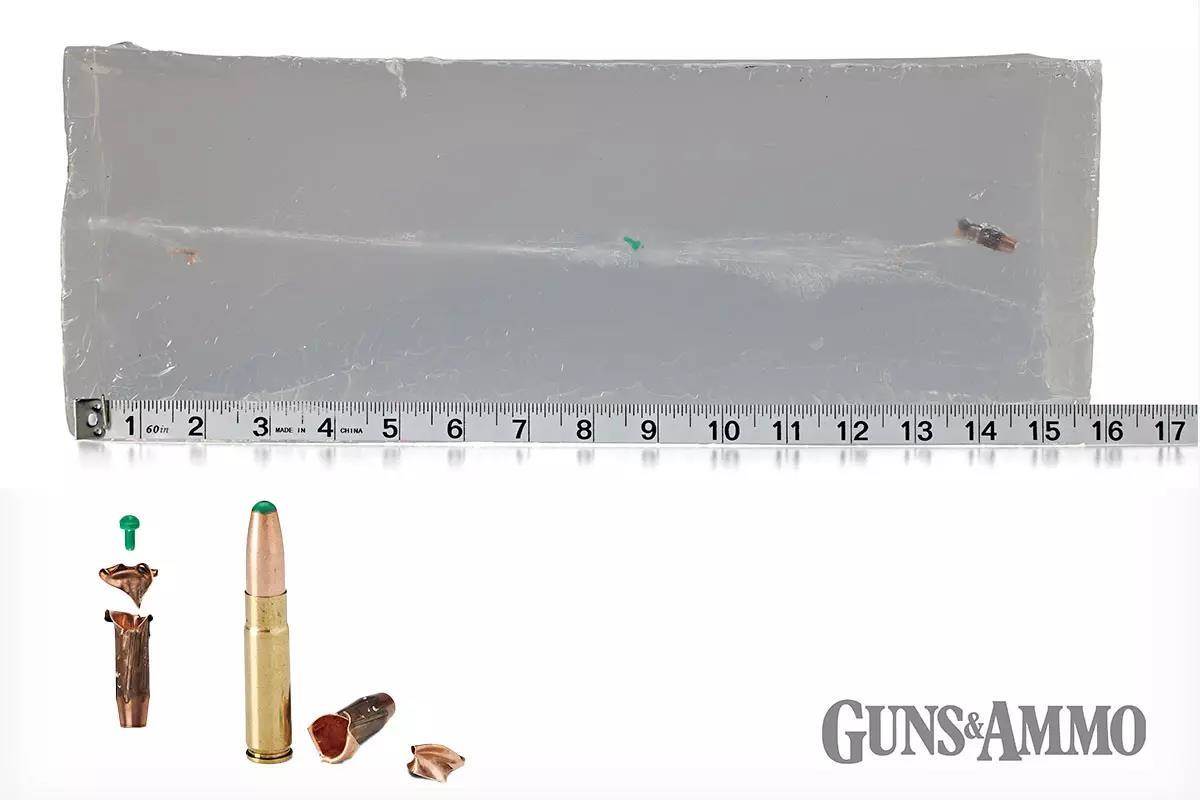

The .300 Blackout load exits an 8.5-inch barrel at 1,080 fps with 570 ft.-lbs. of energy, leaves a 10.5-inch barrel at 1,111 fps with 603 ft.-lbs., and a 16-inch barrel at 1,126 fps with 619 ft.-lbs. of energy. The 220-grain projectile penetrated 15 inches and fragmented in clear gel. (Photo by Michael Anschuetz)
The .300 BLK and .308 Win. loads also proved effective in gel. The two .300 BLK loads are offered in supersonic or subsonic varieties. The supersonic cartridge is loaded with a 125-­grain Hornady Super Shock Tip (SST) bullet, and the subsonic features a 220-­grain Nosler Ballistic Tip (BT). The .308 Win. also got the Hornady SST bullet. I like these options.

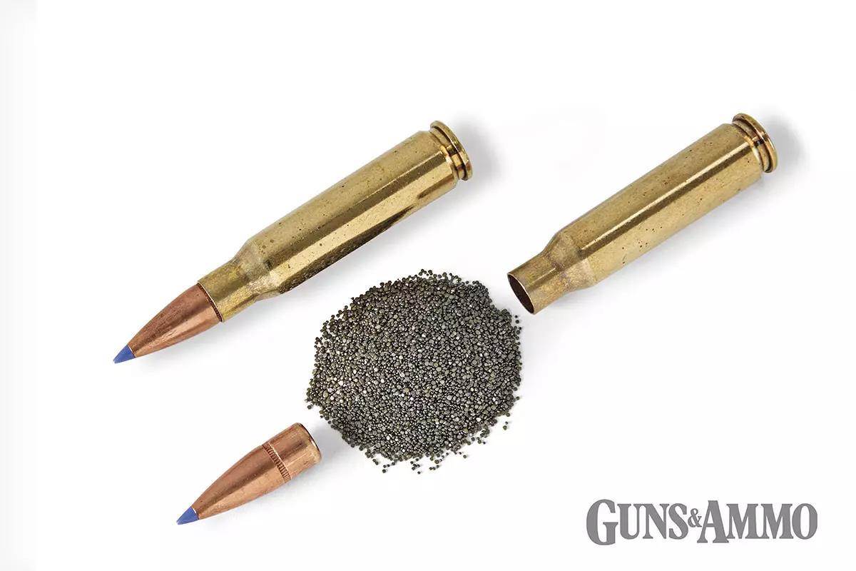

The Hornady SST used in one of the .300 BLK and .308 loads is also a well-­established bullet. In contrast to the match-­type bullet loaded in the .223 Rem. round, the SST was designed for hunting first. It features a polymer tip designed to ensure rapid expansion on impact. The tip is colored “Fiocchi Blue” instead of “Hornady Red.” The 125-­grain bullet clocked 2,801 fps from a .308-­chambered SBR with a 12-­inch barrel. Moving to a Franchi Momentum All-­Terrain Elite bolt-­action with 18-inch barrel added 270 fps ($1,479, franchiusa.com). Groups at 100 yards from a benchrest were right at 1 inch. Kinetic energy measured with a Garmin chronograph and confirmed with a calculator turned in an astounding 2,600 foot-­pounds (ft.-­lbs.) of muzzle energy.

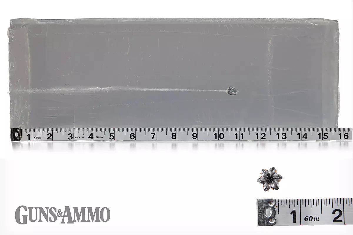

Fiocchi CovertX load for the 9mm features a 124-grain JHP bullet that averaged 1,145 fps from a 3.8-inch barrel. Penetration in bare 10-percent clear gel was measured at 14 inches. The projectile expanded to .58 inch. (Photo by Michael Anschuetz)

Fiocchi introduced the CovertX line alongside the SBR Enhanced at The Site event. Like the rifle ammo, the CovertX was optimized for short barrels — but not only pistols. The difference in production volume for handguns versus the number of SBRs produced is substantial. There are many AR manufacturers making AR pistols, pistol caliber carbines (PCC) and SBRs, but I can’t think of any handgun manufacturer worth its salt that doesn’t offer several compact or micro pistols. The Springfield Armory Hellcat line alone has almost 50 models to choose from!
Fiocchi introduced the CovertX line by supporting the five most ­popular pistol cartridges, all loaded with a jacketed hollowpoint (JHP) bullet. The line includes a 95-­grain .380 ACP, 124-­grain 9mm, 125-­grain .38 SPL +P, 125-­grain .357 Mag., and a 230-­grain .45 ACP.
In many ways, handgun ammo is facing the same design challenges as SBR ammo. How do we get a bullet to penetrate at least 12 inches per FBI protocol for bare gel, but no more than 18 inches and expand at slower velocities? The answer is the same. Fiocchi needed that tricky combination of the right bullet matched with the right powder that performs in a sub-­4-­inch barrel. Well, they found it.

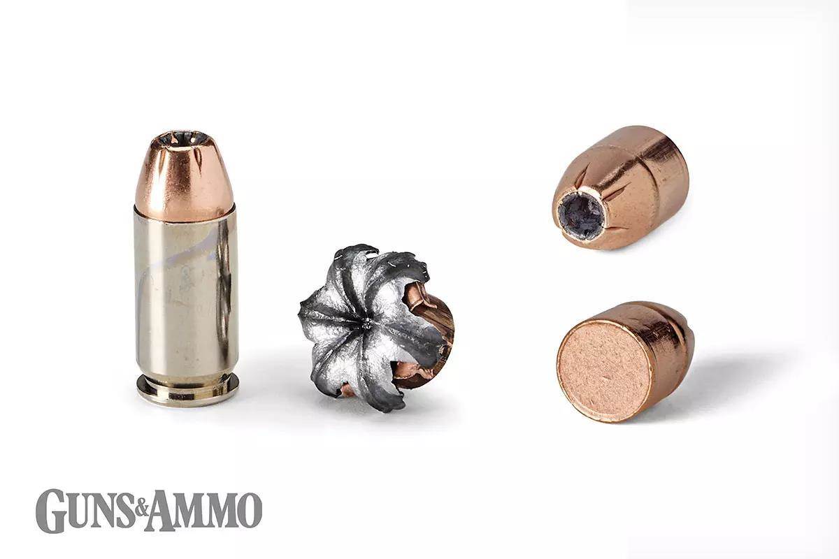

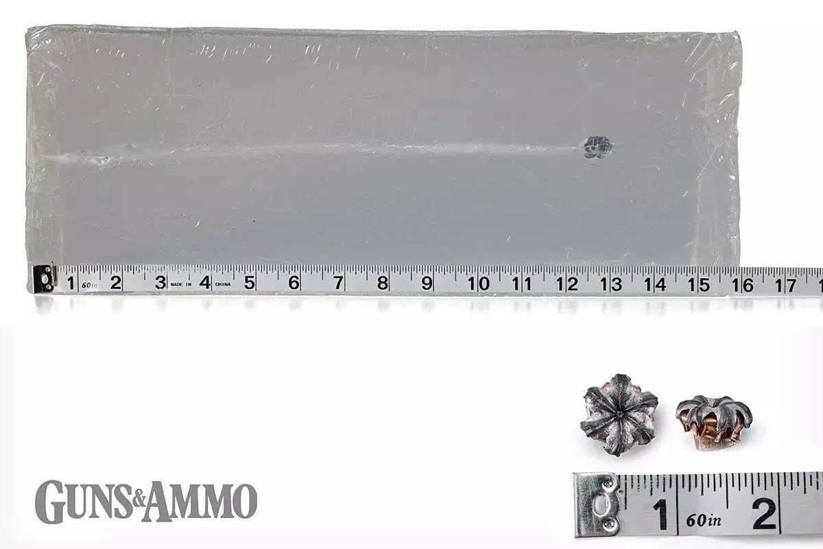

CovertX JHP bullets were pulled from gel blocks and told us a lot about its performance. The .380 penetrated at least 10 inches, but the other calibers met or exceeded the FBI standard for bare 10-percent ballistic gel. The bullets mushroomed beautifully, too, and held together. All demonstrated 99-percent weight retention.
gaad-fiocchi-sbr-cov-10
Fiocchi CovertX ammunition features a flat-base JHP bullet with a lead-alloy core given a skived jacket. The case is nickeled brass. (Photo by Michael Anschuetz)

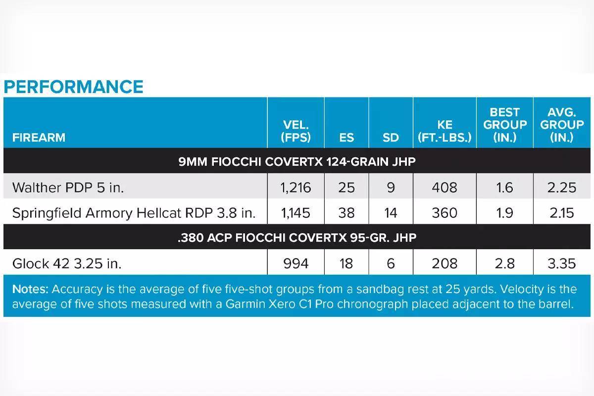

Despite only penetrating 10 inches, I was most impressed by the .380 CovertX load. From a 10-­inch-­“ish” AR barrel chambered in .380, it clocked 1,086 fps and penetrated the same as the bullet fired at 994 fps from my Glock 42. (The unreleased Rock River AR in .380 was revealed to media at the event.)
Across the line, the JHP bullet has pre-­cut skiving in the tip. The core is a lead alloy, and the copper jacket is thick enough for controlled performance for use in full-­size handgun barrels, too. The cases are formed from nickel-­plated brass. I experienced no feeding issues or malfunctions throughout testing. They fed well and printed tight groups at 25 yards. Within 10 yards, I could shoot one jagged hole with any of the loads.
It’s hard to accurately measure recoil impulse in a handgun, so my perception comes from simple experience. Against standard 124-­grain 9mm loads, I perceived the CovertX in my Springfield Armory Hellcat RDP as less “snappy.” It was a benefit to defensive drills that involved shooting multiple rounds. It doesn’t matter how good a bullet is if it doesn’t hit the target. During my ongoing testing, the 9mm and .380 ACP CovertX loads were accurate and easy to keep on target. After I considered the performance in gel and accuracy at the bench, I concluded that Fiocchi’s CovertX is an ideal pairing with compact EDC pistols.
