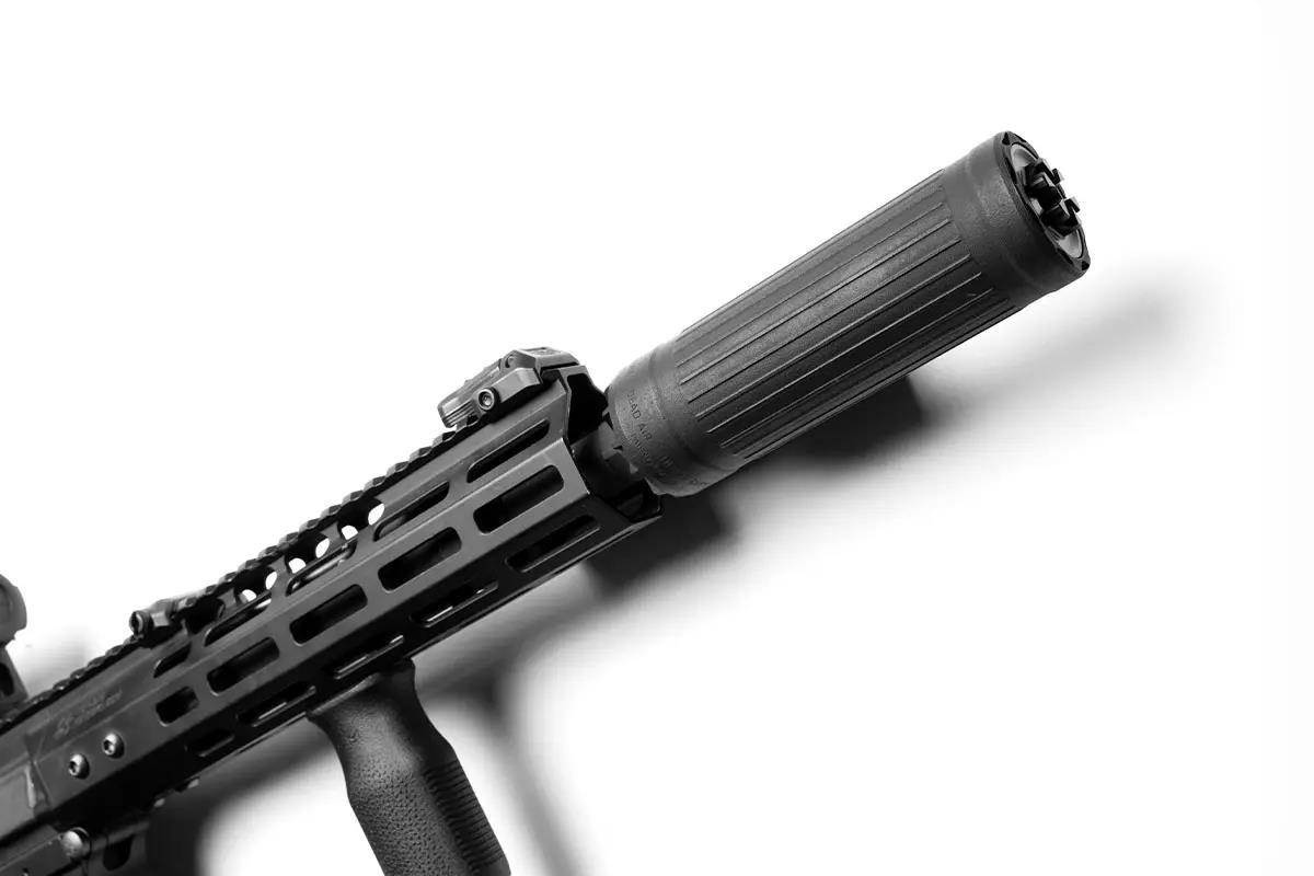

The slim profile of the CT5P belies just how durable the suppressor is, being rated for short barrels and full-auto fire. (Photo by Mark Fingar)

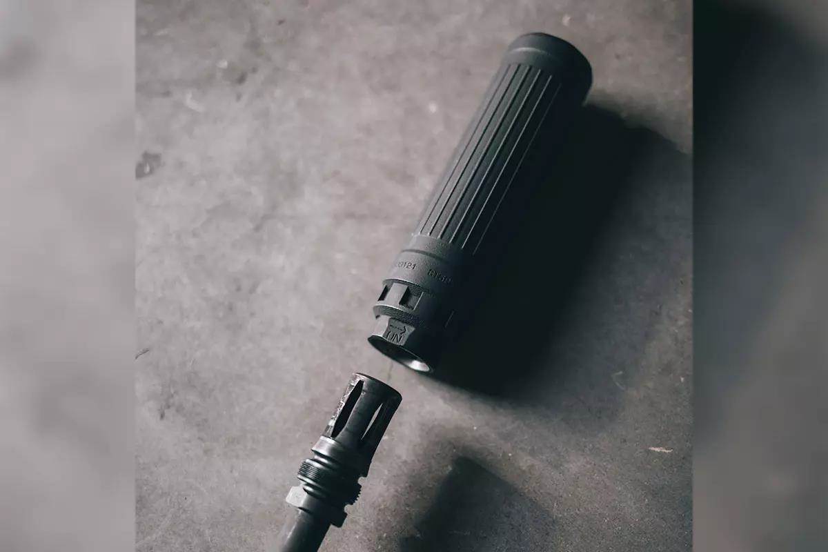

CT5P suppressors feature a high temperature Cerakote exterior finish in either black or FDE. The finish is designed to withstand both high temperatures and rough handling. Duty carbines are shuttled in and out of patrol vehicles each day and are subjected to high-speed drills that inevitably result in impacts and abrasions. The Cerakote high-temp finish shrugs off this abuse and keeps the can looking new and in working order. You may also notice the ridges on the exterior of the can, a design feature that increases surface area to speed cooling. The ridges also offer an anchor point when loosening or tightening the suppressor by hand—just be certain not to do so until the suppressor has had sufficient time to cool down after firing.

The CT5P is available with direct-thread, Keymo, or Xeno (pictured) mounting systems. (Photo courtesy of Dead Air)

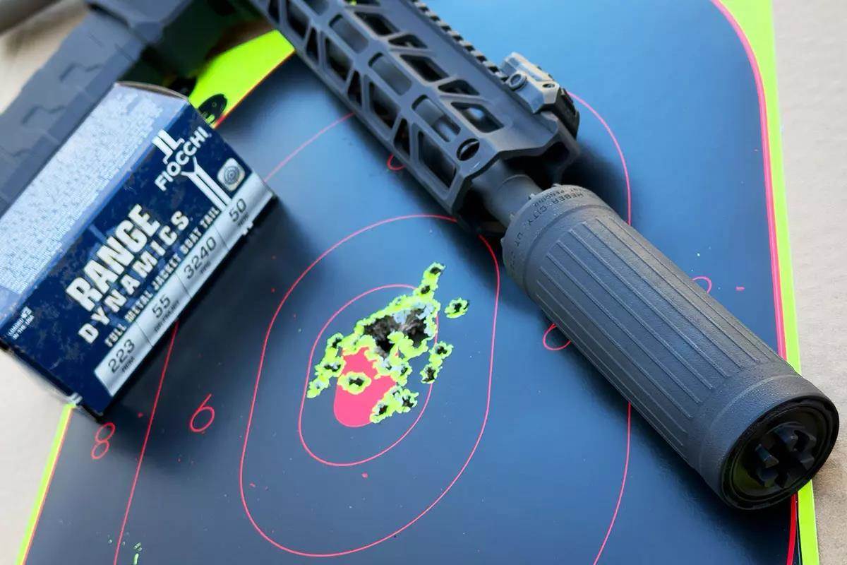

That compact size was thanks in part to the short CT5P suppressor with direct thread mounting system which added just about five inches to the overall length of the rifle. I fired 55-grain Fiocchi Range Dynamics FMJ at a torso target at the range and was impressed with the sound reduction. Using a NIOSH sound level meter, I tested the rifle without the suppressor in place and found that the unsuppressed RRA carbine produced noise levels of 137 to 140 decibels (dB) at the shooter’s ear. Since 140 dB is sufficient to cause permanent hearing loss shooting that rifle/load combination would require hearing protection.
With the CT5P in place sound levels dropped to 129 dB. That may not seem like a very dramatic reduction, but you must remember that sound is measured logarithmically. Every 10 dB increase represent ten times as much sound energy, so the CT5P reduced noise substantially. More importantly, the suppressor drops sound levels to hearing safe levels so that you can shoot the rifle without the need for hearing protection. The reduction in sound and blast also made shooting the rifle quickly much more enjoyable.

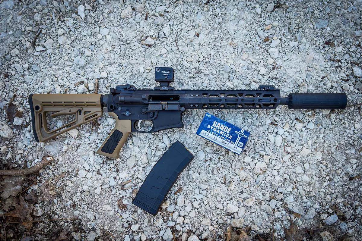

Besides noise reduction, the CT5P also does an outstanding job managing backflow of gasses. I don’t care for shooting suppressed rifles that spew toxic gasses from the receiver, but the CT5P was easy to shoot for extended periods. This is particularly important for suppressors designed for hard use since the shooter will likely be pulling the trigger many times each day. Reducing exposure to harmful and obnoxious gasses is always a good thing, but it’s practically a requirement on a duty suppressor. Plus, the gas management reduces the wear and tear on the gun—and the shooter--from a hard-cycling bolt.
To really appreciate the performance of the CT5P we had to slow things down. Mark Sidelinger filmed a series of shots in slow motion, and only then that you can truly observe the Triskelion Gas Management System in action. With each shot we could see the gasses escaping forward from the front of the suppressor. It wasn’t so much gas that the rifle failed to operate, but it did help make for a more pleasant shooting experience.
