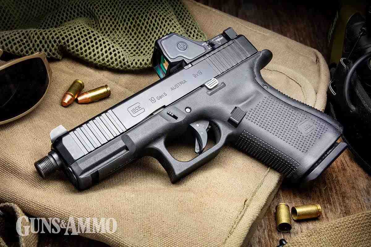

Social media, web forums, and other types of electronic media have provided firearms enthusiasts with an outlet to share images of their collection more conveniently than ever. But when you toss that new pistol on the kitchen table and snap a quick photo, you’ll get a flat, dull and uninteresting image. Or maybe you want to sell that old rifle online, and all you can get is a lifeless image without detail and depth, especially if you use that dreaded on-camera flash. Believe it or not, taking a decent photo isn’t as hard as you might think. In fact, it’s pretty easy.

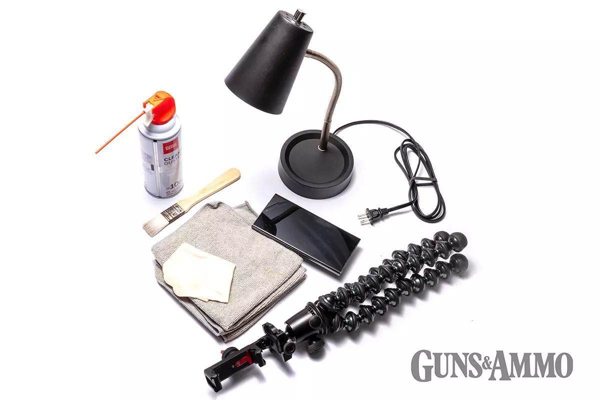

A cellphone, a desk lamp and a background are the tools used for all the photos in this article.
Gear Up.
You don't need expensive cameras, lenses, strobe lights, and an army of tripods or light stands to get started. I’m guessing you have everything needed in the room you’re sitting in right now. A cellphone, a desk lamp and a neutral background can work wonders. If you can’t get a desk lamp, use the sun.

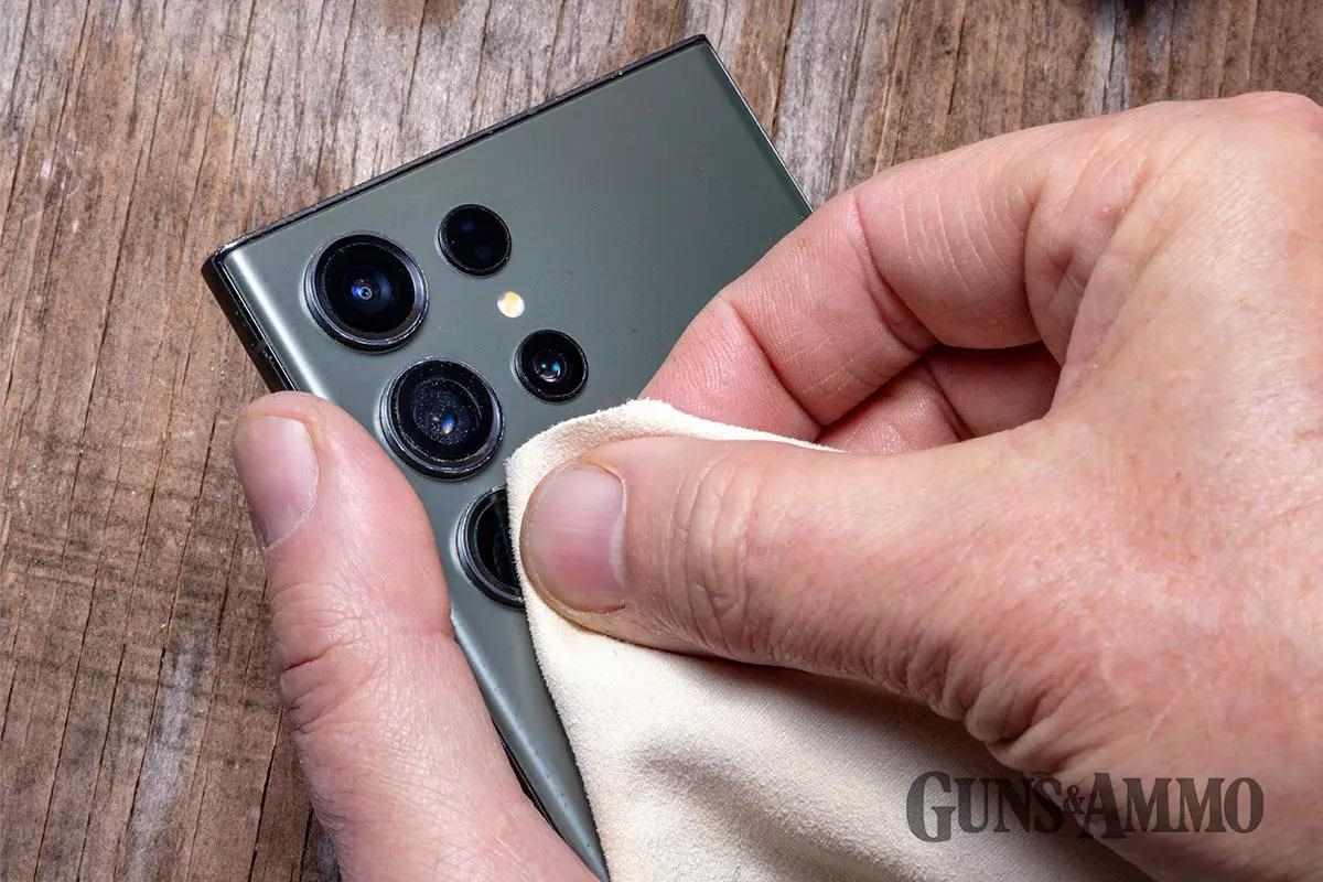

The most important thing with a camera is to meticulously clean the lens.
All the techniques I’ll discuss here apply with any type of camera, be it an expensive DSLR or an old(ish) cell phone. With today’s technology, anyone can do a great job. The most important thing with a camera is to meticulously clean the lens. So, get a pristine microfiber wipe and do some detail work. Otherwise, it’ll look like you’ve been taking fuzzy photos underwater. If your phone or camera has a built in flash, disable it. Nothing kills a good photo faster than direct light. If you have shaky hands, a tripod with a cellphone cradle will ensure sharper photos, but modern cellphones have internal stabilizers that help with that already.

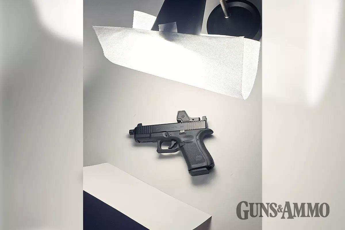

A basic gooseneck desk lamp will provide decent indirect off-camera lighting. A cheap upgrade to a desk lamp would be a white paper towel, or an old white T-shirt to diffuse the light. Drape it over the light’s hood and secure it with tape or a rubber band. Make sure there’s space between the bulb and the diffuser to avoid heating up the material and for proper light diffusion. By diffusing the light, the shadows will be softer, and the details will look more natural. Make sure there’s no printing on your chosen diffuser, or you’ll get unwanted colors projected on your subject. Make sure the bulb is a low-temperature (most modern bulbs are), and you won’t burn the house down.
gaad-gun-photos-101-04
Taping a paper towel to a desk lamp will provide diffused, soft shadows.

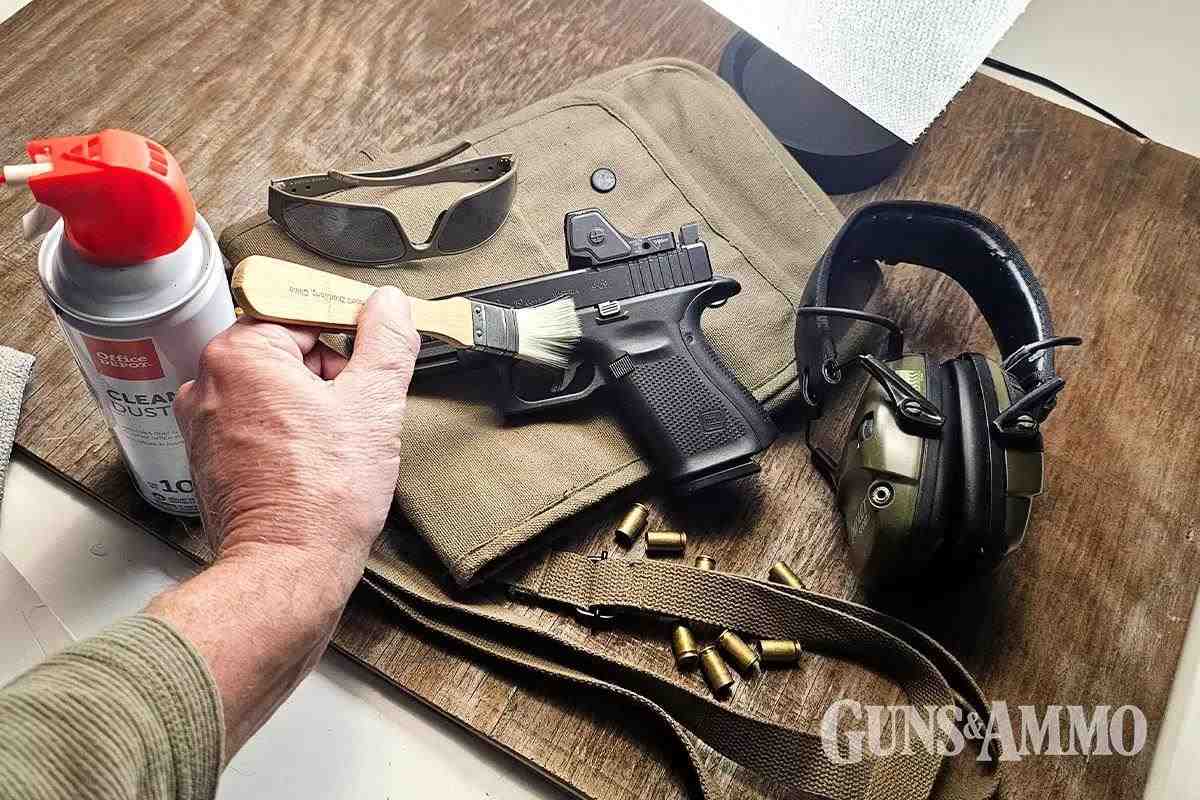

Keep a can of compressed air and a couple soft brushes on hand. Wipe everything down with a lint-free towel, or microfiber cloth. Get all the fingerprints and visible oil off the firearm. The result of this effort can be dramatic. I spend at least 80% of my time prepping the firearm before I turn on a camera. As you can imagine, I have a whole arsenal of brushes, q-tips, cotton gloves and cleaning supplies.

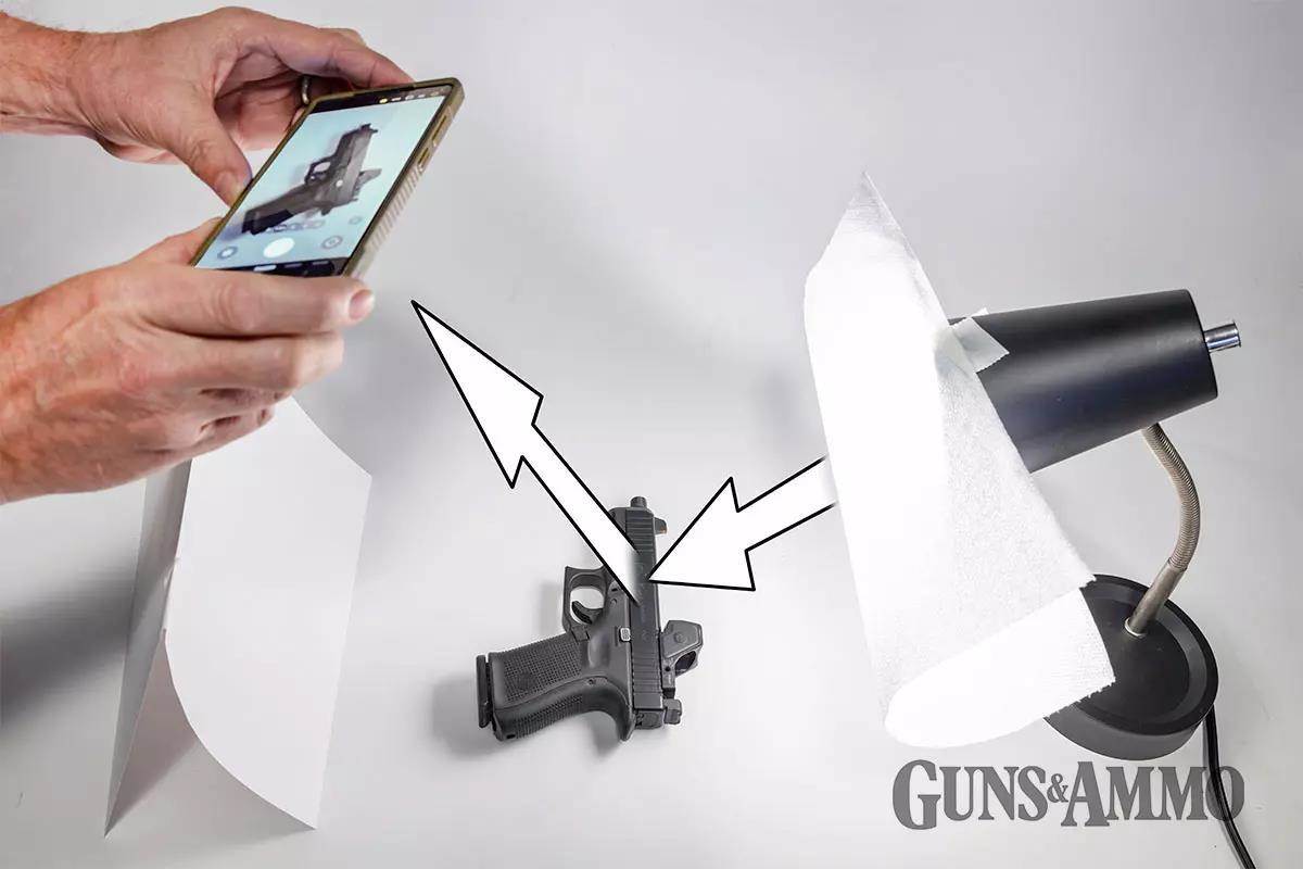

The word photography means "drawing with light”. While that’s true in the technical sense, I say it’s more like “playing pool with light”. When playing pool, you strike a cue ball into a numbered ball, hopefully sending it into a chosen pocket. Ricocheting everything on the table with precision to reach a goal. With photography, think of your light source as a cue ball, the subject is the numbered ball and the pocket is the camera’s lens. You want to bank, or more precisely, reflect light off the firearm and into the camera. The challenge is to position those elements in concert, so you get a photo that pops.

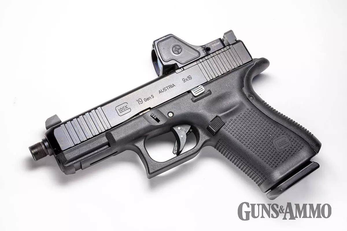

gaad-gun-photos-101-07
Bounce light off the subject into the camera.
The simplest way to do all of this is to place your subject on a desired background. Next, frame the subject with your camera and save that spot. Then, move the light, until it shines off the subject into your framed shot. With a black gun, you’ll see the effects quickly. You may need to adjust your composition slightly, but studio lighting is that simple. Lighting in this manner will provide amazing details that are impossible to capture with an on-camera light source.
gaad-gun-photos-101-08
The subject firearm shows up much more clean and detailed when light is properly directed.
