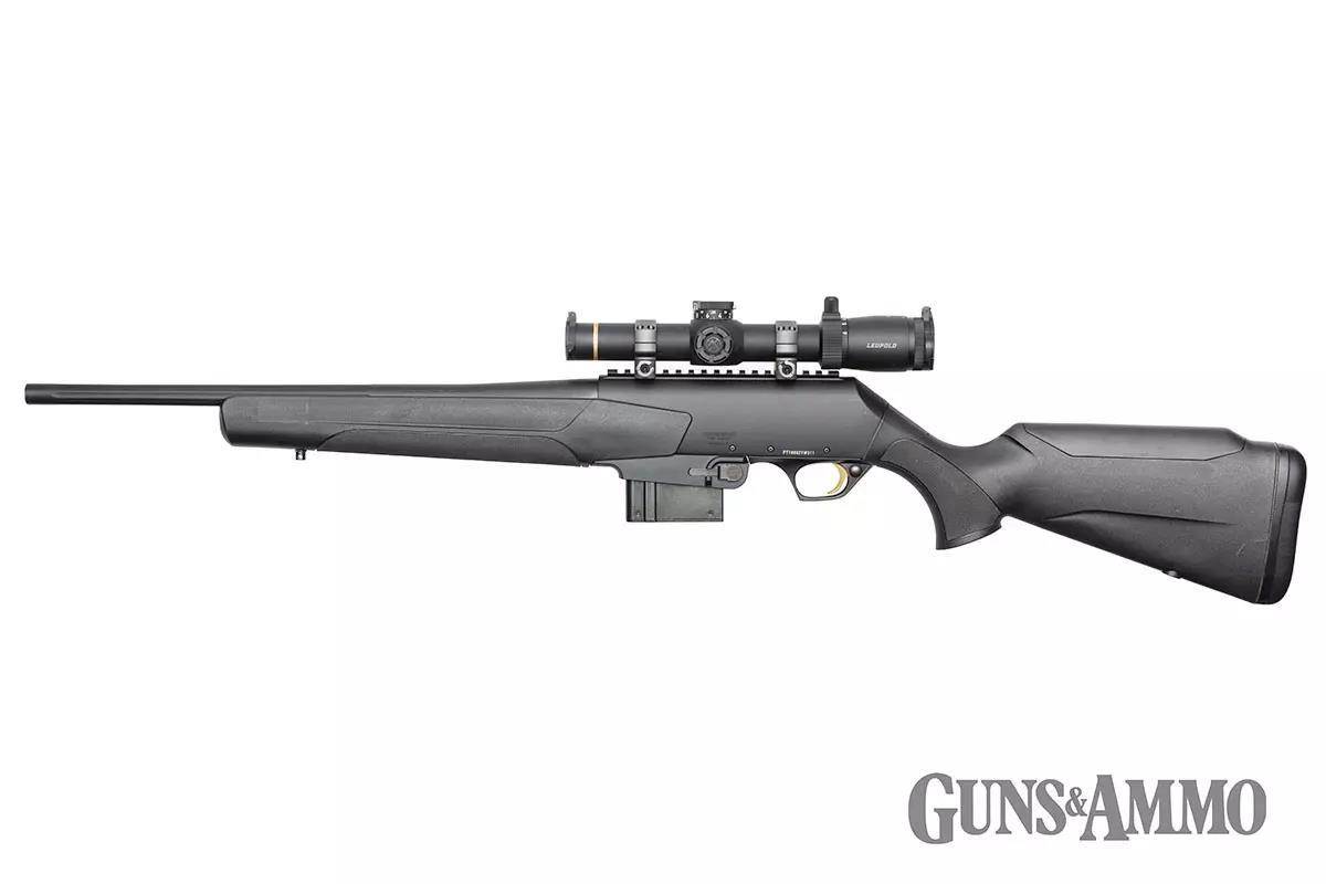

Introduced in 2025, the Browning Automatic Rifle (BAR) Mk 4 is a gas-piston-operated semiautomatic rifle that feeds from a detachable box magazine. The next generation version of the BAR supports popular short-action cartridges and long-action magnums. (Photo by Mark Fingar)

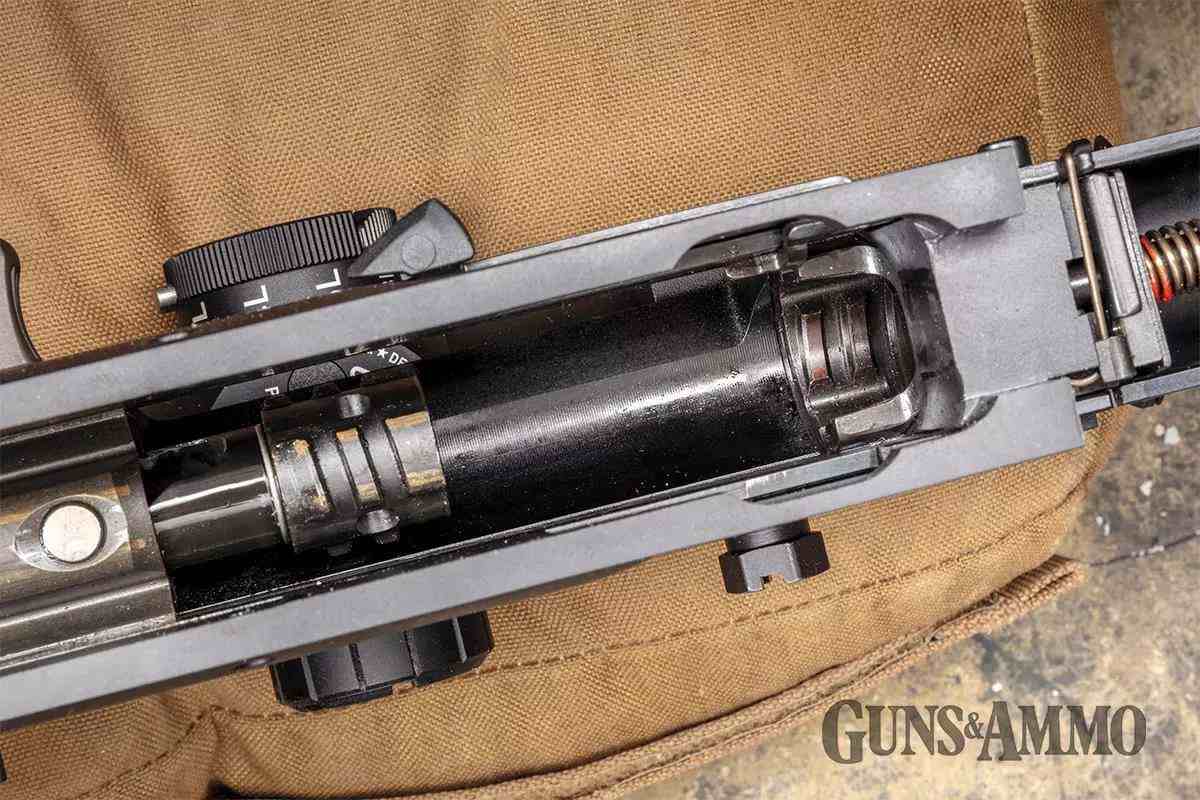

With the bolt retracted and lower assembly removed, the steel bolt lug abutments in the receiver and barrel can be accessed. (Photo by Mark Fingar)
The Sporting Arms and Ammunition Manufacturers’ Institute (SAAMI) lists the maximum allowable chamber pressure in a .243 Winchester as 60,000 pounds per square inch (psi). A .300 Winchester Magnum is allowed 64,000 psi. When you combine the higher pressure of the .300 Winchester Magnum with the larger case head diameter, there is a huge difference in how much each of those cartridges presses against the bolt face, i.e., “bolt thrust.” The bolt in the BAR is strong enough to handle the magnum-­level thrust, and the piston operation is forgiving enough to work reliably with significant differences in gas volume. I know of no other semiautomatic rifle that can make these claims.

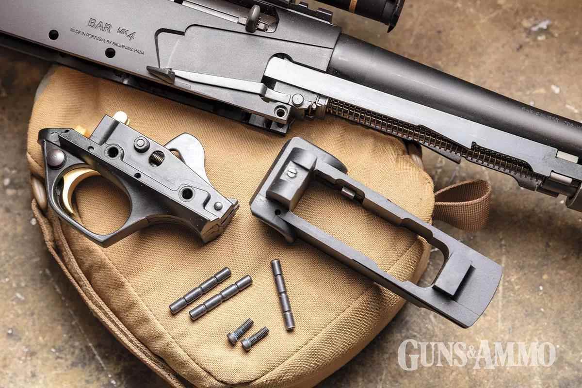

The rifle is as simple as it is durable. With the forend and stock removed from the receiver, the gas piston and operating rod are found located underneath the handguard. A quick twist of a wrench allows the gas piston to be removed, after which the operating rod and recoil spring can separate from the barreled receiver. The rest of the BAR can be disassembled in detail with some dexterity, a pick, and a little know-­how.

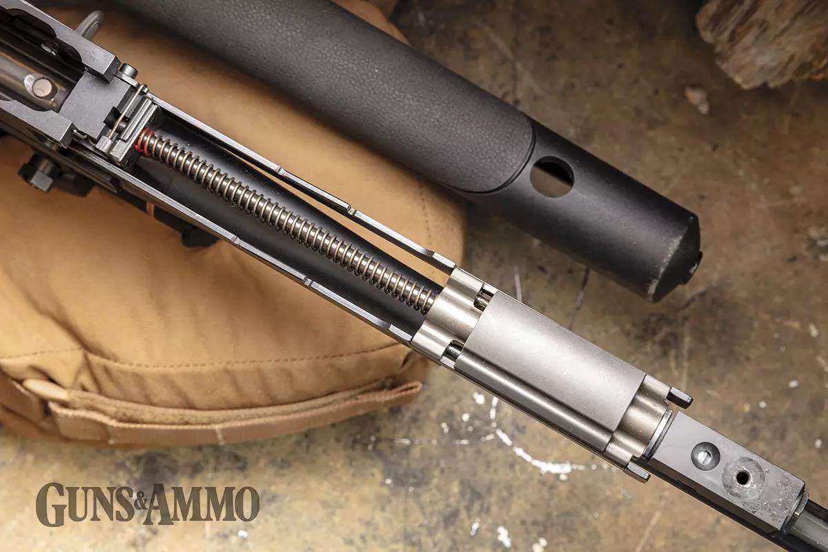

The composite forend shrouds the gas-piston operating rods, coil springs, and action bars that provide the BAR its smooth operation. (Photo by Mark Fingar)
From a maintenance perspective, the BAR is a dream. With a handful of the most basic tools, the owner can perform a detailed disassembly of the rifle for inspection and basic maintenance.

Separating the trigger assembly and magazine well from the BAR Mk 4 involves removal of notched crosspins and two fasteners. (Photo by Mark Fingar)

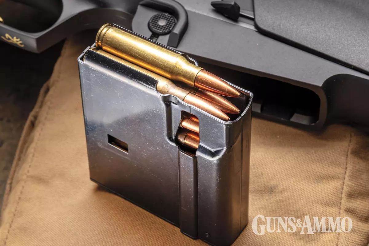

Other changes to the Mk 4 include cosmetics with the stock to reflect shooter preferences today and the addition of a model featuring the long-­awaited detachable box magazine. Guns & Ammo was fortunate to test this version. The detachable box magazine carries a double-­stack ammunition column that feeds effortlessly into the chamber. The addition of the new magazine was an excellent idea because it combines easy reloads with a simple and robust rifle that is great for follow-­up shots.

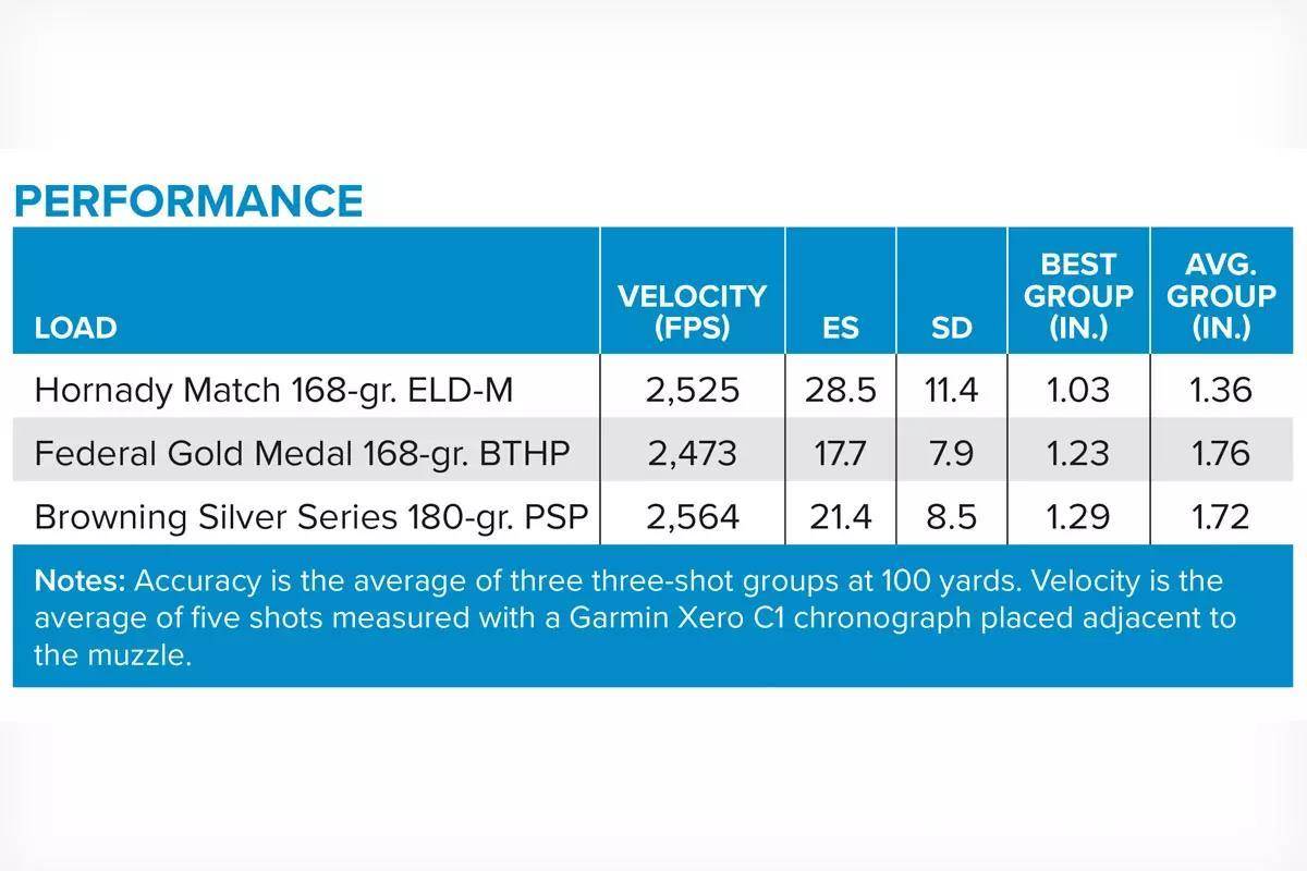

For me, testing the BAR Mk 4 included range sessions and a black bear hunt in Idaho. The takeaway from all that shooting was that the BAR enjoys a cult following for a reason. The rifle exudes quality. At no point was there a functional hiccup. Disassembling the rifle also revealed just how easy it is to maintain. Unlike AR-­pattern rifles, the BAR can chamber anything from short-­action cartridges to the .300 Win. Mag. Magnum chamberings bring a lot of fast-­shooting firepower unavailable anywhere else.
Shooting the BAR was pleasant. It isn’t so much a result of weight, since the test model scaled at 71/2 pounds. The semiautomatic operation bleeds a lot of felt recoil away from the shooter to cycle the action. While a 71/2-­pound .308 Win. is never going to be known for its punishing recoil, the BAR Mk 4 is pleasant to shoot. I expect the magnum chamberings would be equally forgiving.

The blued steel detachable box magazine holds 10 rounds of .308 Win. Spares are available at browning.com. (Photo by Mark Fingar)
