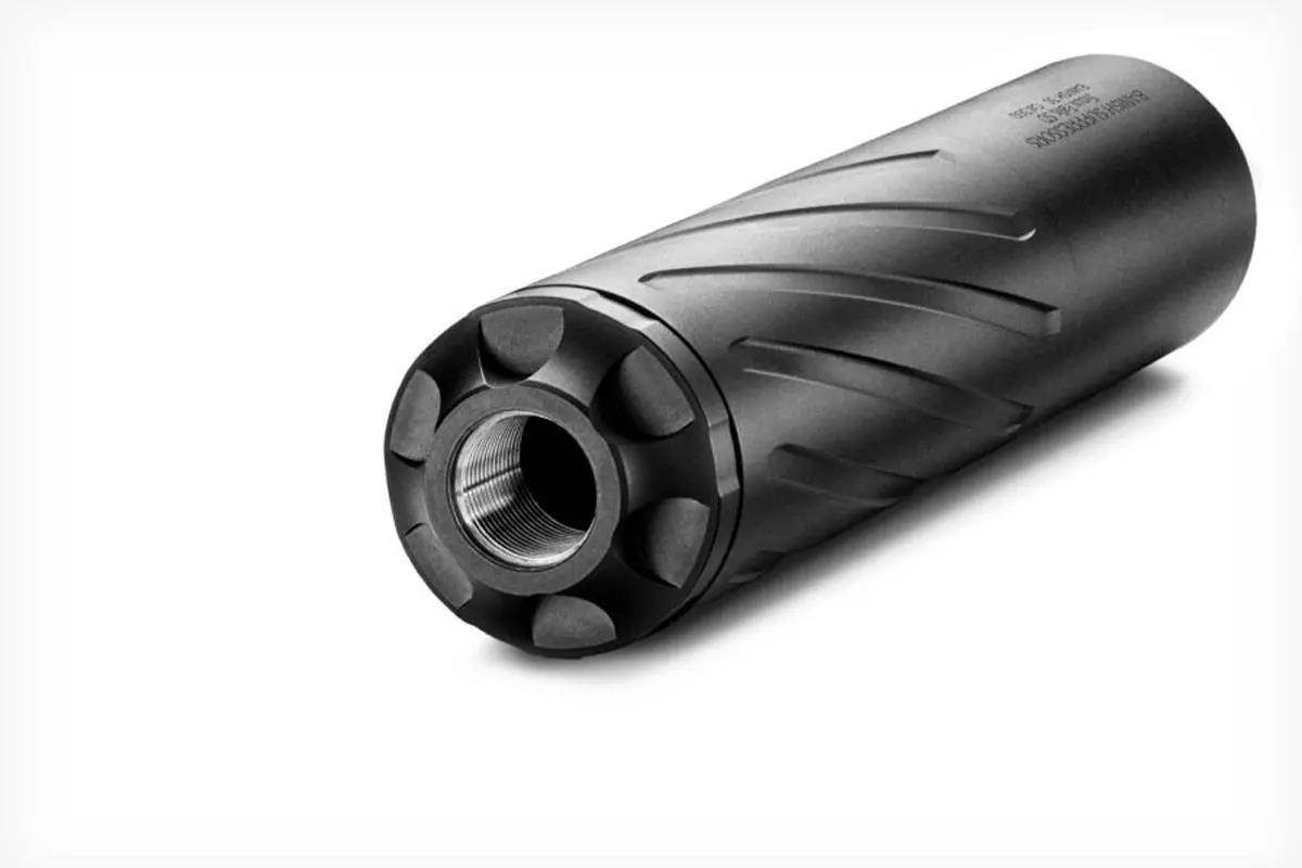

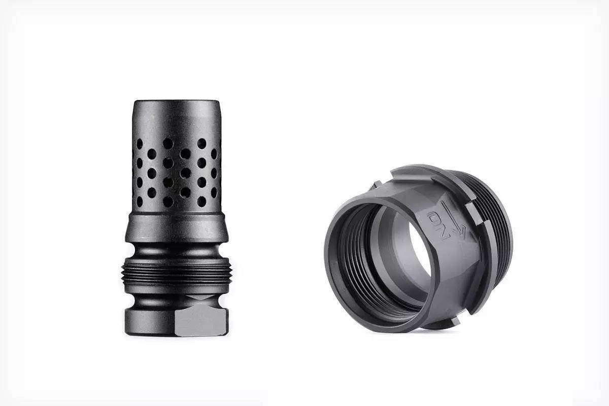

The original Banish 30 was limited to direct-thread mounting on 5/8x24 thread patterns. The mounting device uses a proprietary thread pattern unique to the suppressor.

The Banish 30 is a direct thread suppressor with a 5/8x24 attachment thread pitch. This didn’t bother me at all when I bought it because I only had two guns that I planned on using it with. My lack of foresight would become a pain point.

At this point, you may be asking yourself why I didn’t just remove the direct thread mount from the Banish 30 and install something like a HUB to enable use of the muzzle device of my choosing. Well, that’s because the direct thread mount on the Banish 30 isn’t designed to be removed - and even if you did remove it, Silencer Central used a proprietary thread pitch that didn’t work with any other products on the market. In short, I was stuck.
gaad-banish30-hub-fit-08

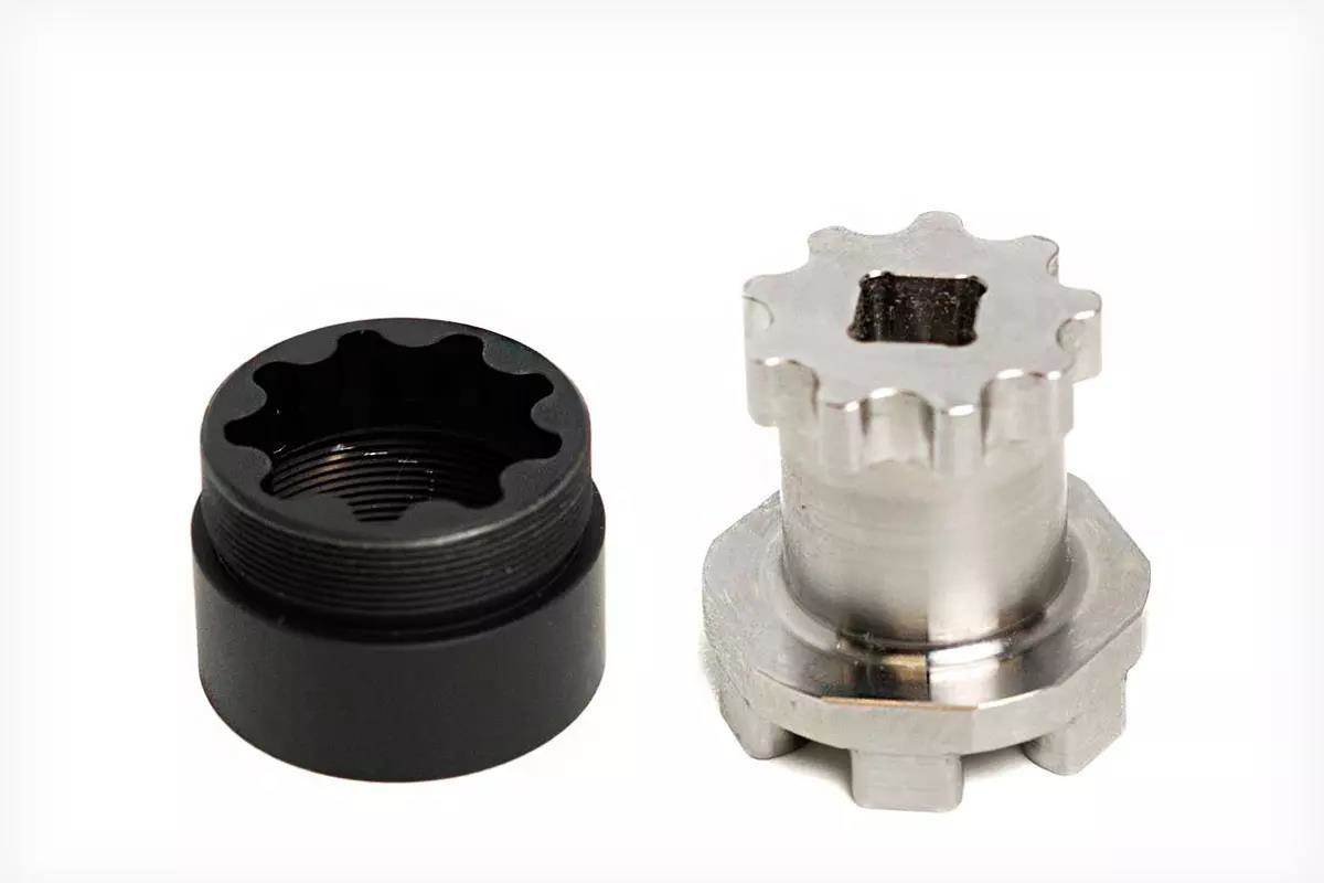

gaad-banish30-hub-fit-06
The hub mount has a nine point gear cut that matches the shape of the adapter tool.

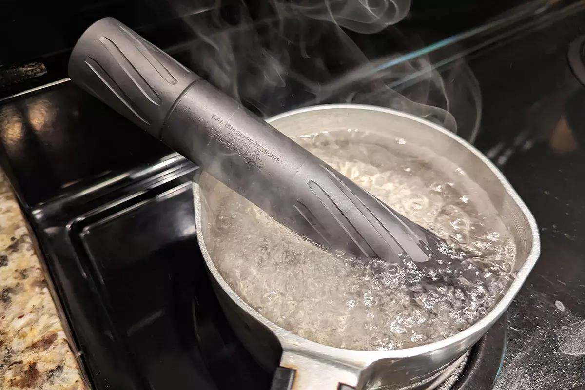

The how-to video they provide to guide you through the steps says you should use boiling water and keep it in there for 15 to 30 minutes before attempting to remove the mount. The combination of water, heat, and time ensures an easy removal process. In theory.
With my HUB Retrofit Kit in hand, I grabbed a pot from the cupboard, boiled some water, and made suppressor soup. After 30 minutes, I took my Banish 30 to my workbench and secured it in my vise using suppressor-specific jaws. The removal tool was installed on a socket wrench, and I got to work. From the video example and what I know about water soluble thread lockers, I expected a fairly easy removal. It absolutely would not budge.

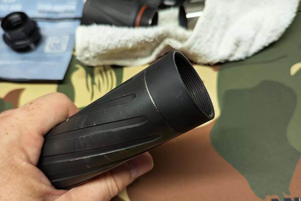

gaad-banish30-hub-fit-03
Boiling the end of the suppressor helps loosen the original thread adapter. Hot water won't damage the can, as it's meant to get much hotter when in use on a rifle.

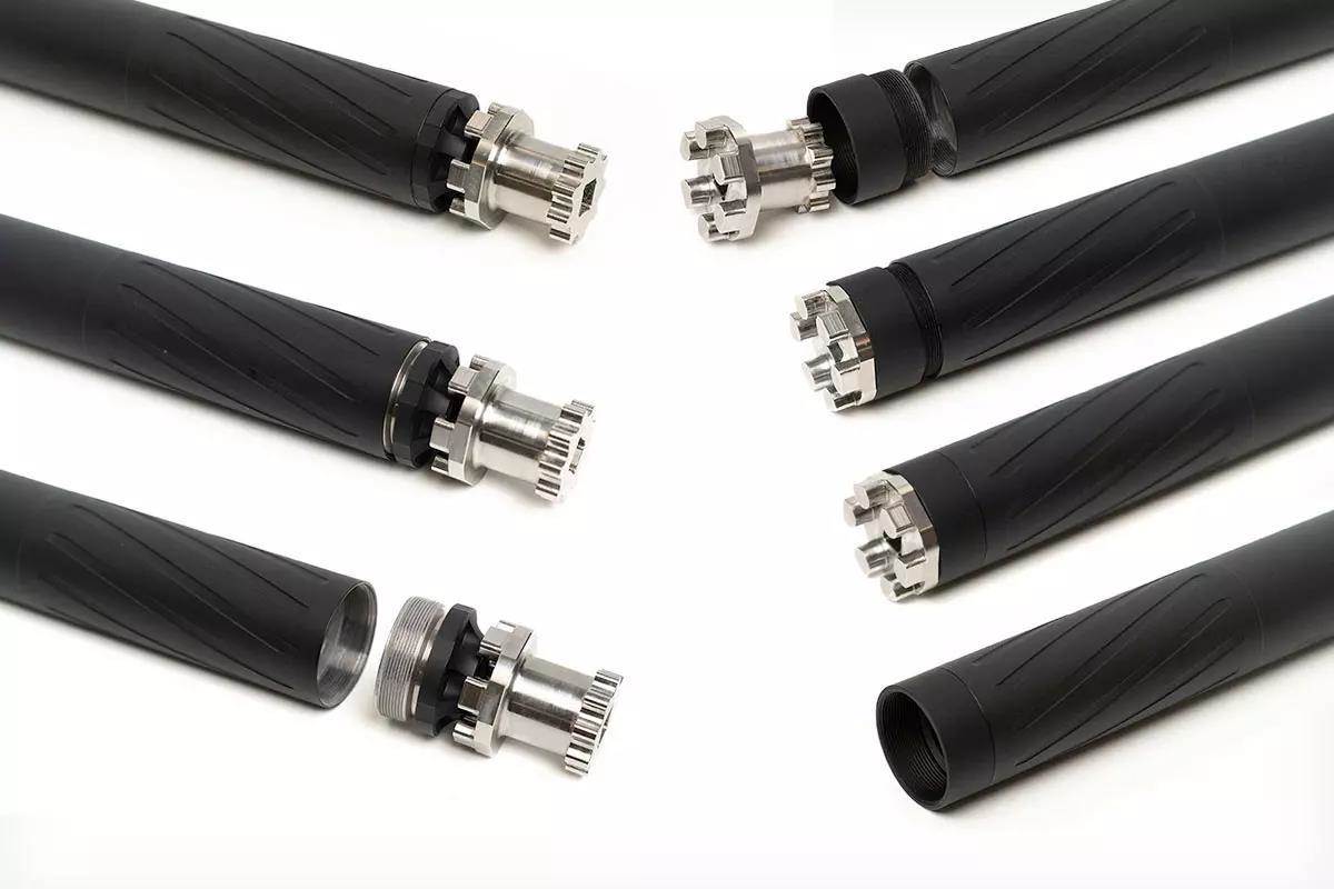

gaad-banish30-hub-fit-04
With the retrofit kit installed, the suppressor is now threaded in an industry-standard 1.375x24 pattern.
Inside was the removal and installation tool that I had sent as well as my suppressor with the HUB adapter installed. I was grateful that not only were they able to remove the direct thread mount, but they also installed the adapter for me. (Not that I couldn’t have, but it was a nice gesture.)

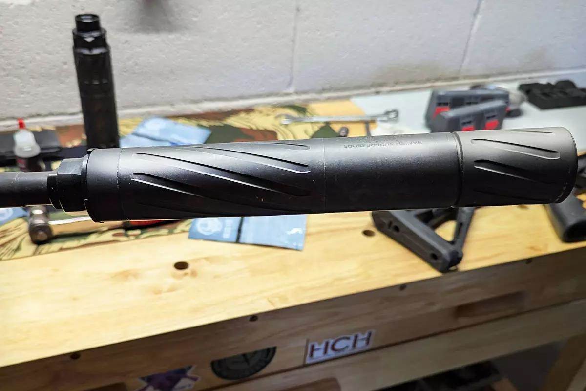

gaad-banish30-hub-fit-02
The newly-upgraded suppressor, mounted on a Xeno brake.
