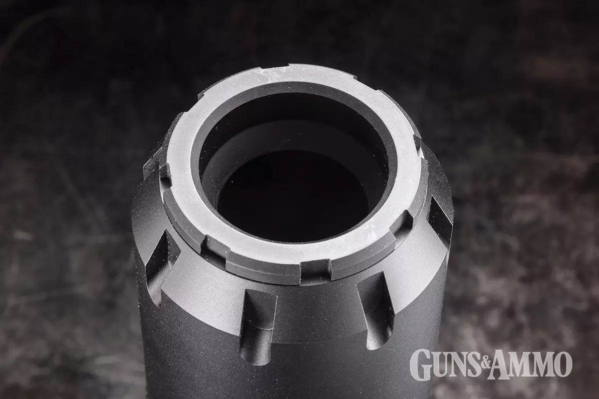

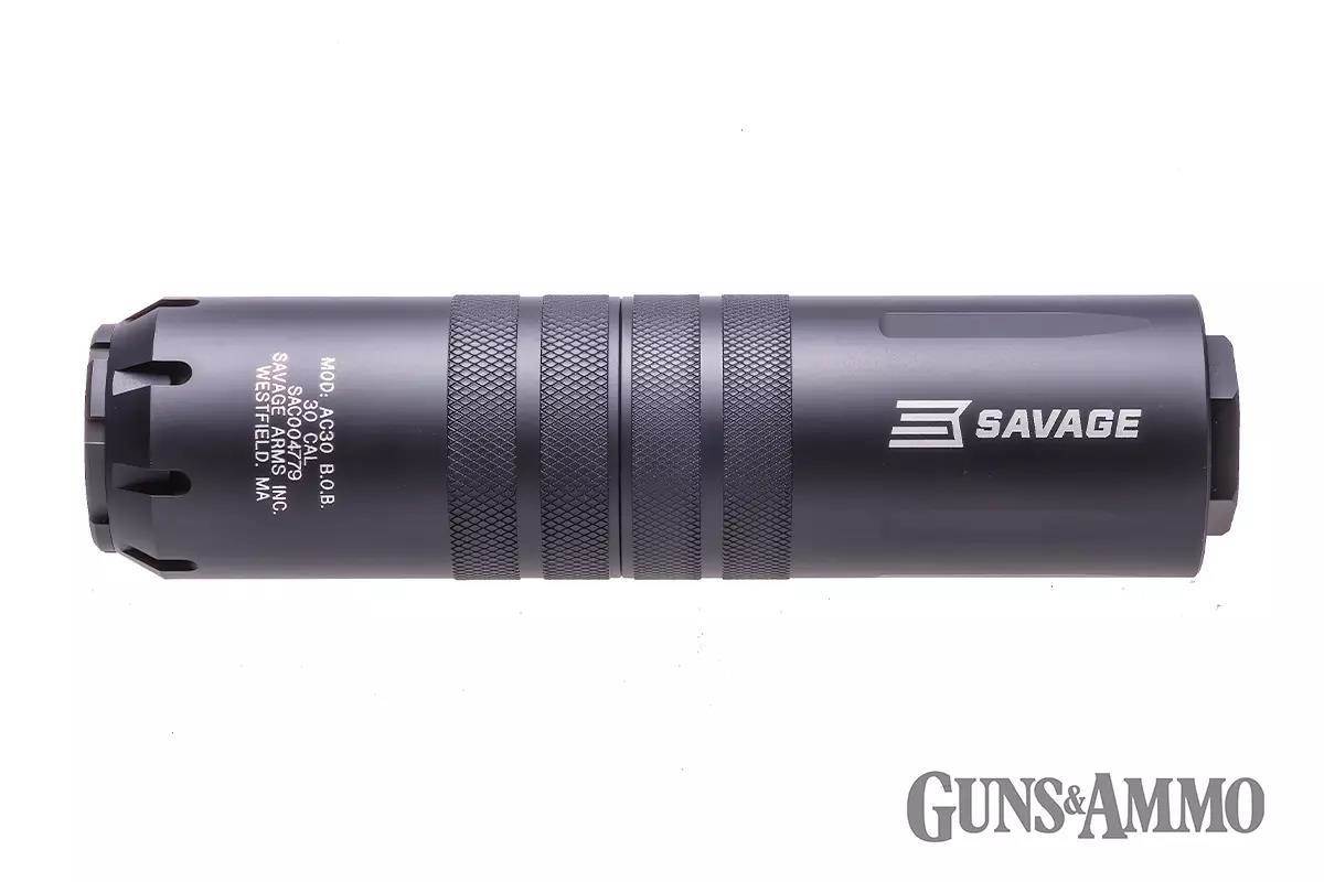

Sliding over the first few inches of barrel, the Savage AC30 B.O.B. offers the benefits of a full-size can with the reduced length of a shorter model. (Photo by Mark Fingar)
The AC30 B.O.B., the acronym standing for “Back Over Barrel,” provides shooters with an additional advantage that similar suppressors lack. As an over-­barrel design, the threads are recessed, so a portion of the barrel is integrated into the can. The result is reduced overall length of a given rifle, making it more maneuverable and better balanced while still providing ample sound suppression.
How “ample?” According to Savage, decibel (dB) levels from its over-­barrel suppressors aren’t much higher than recordings from its standard cans. In testing, the AC30 B.O.B. had a 133 dB rating from a 20-­inch barrel on a .308-­caliber rifle. Even though it’s shorter, the baffle design quiets sound substantially.

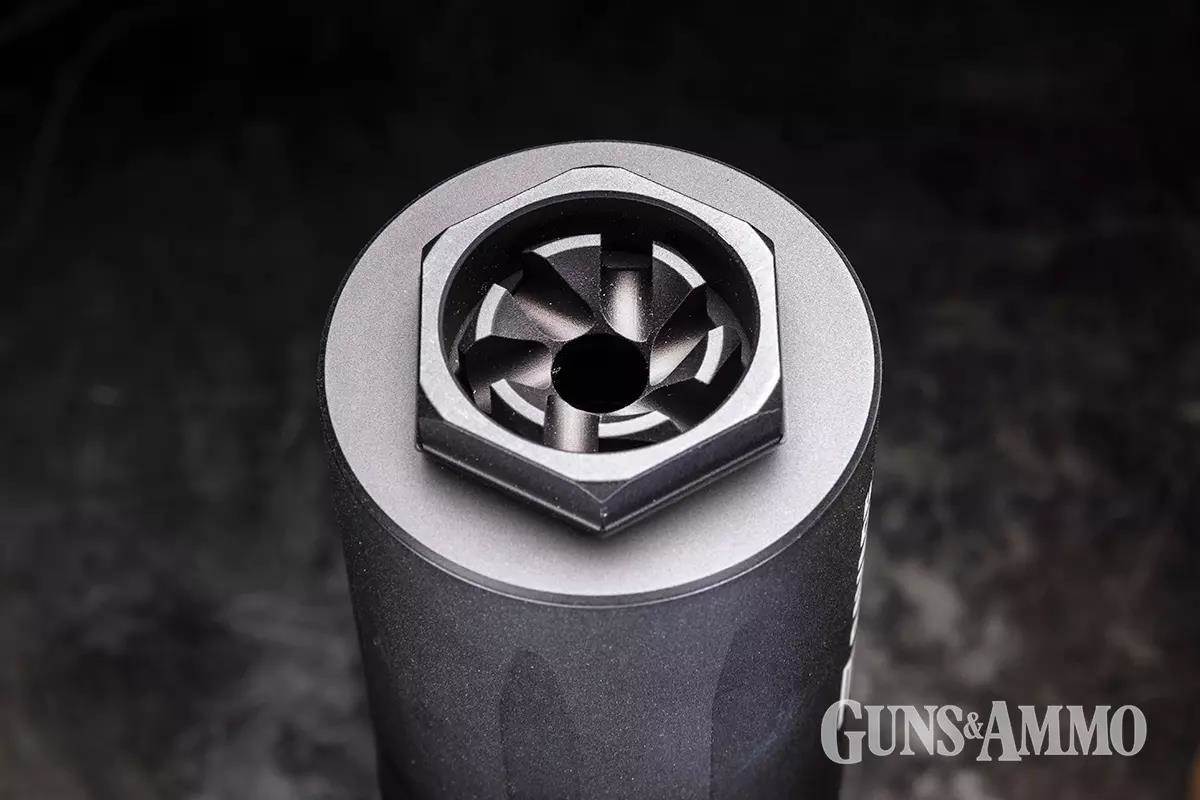

The endcap and core can be replaced. Only the threaded mount is serialized. (Photo by Mark Fingar)
The AC30 B.O.B. is constructed using 7075 aluminum and a Grade 5 titanium thread insert, which is the serialized portion. This translates to light weight (13.7 ounces) and lasting durability. It is also user-­serviceable and is composed of three simple pieces, making maintenance easy to complete without the need for specialized tools. Additionally, Savage builds AccuCan suppressors with integrated self-­cleaning carbon cutters, so cleanup isn’t a concern until round counts are high.

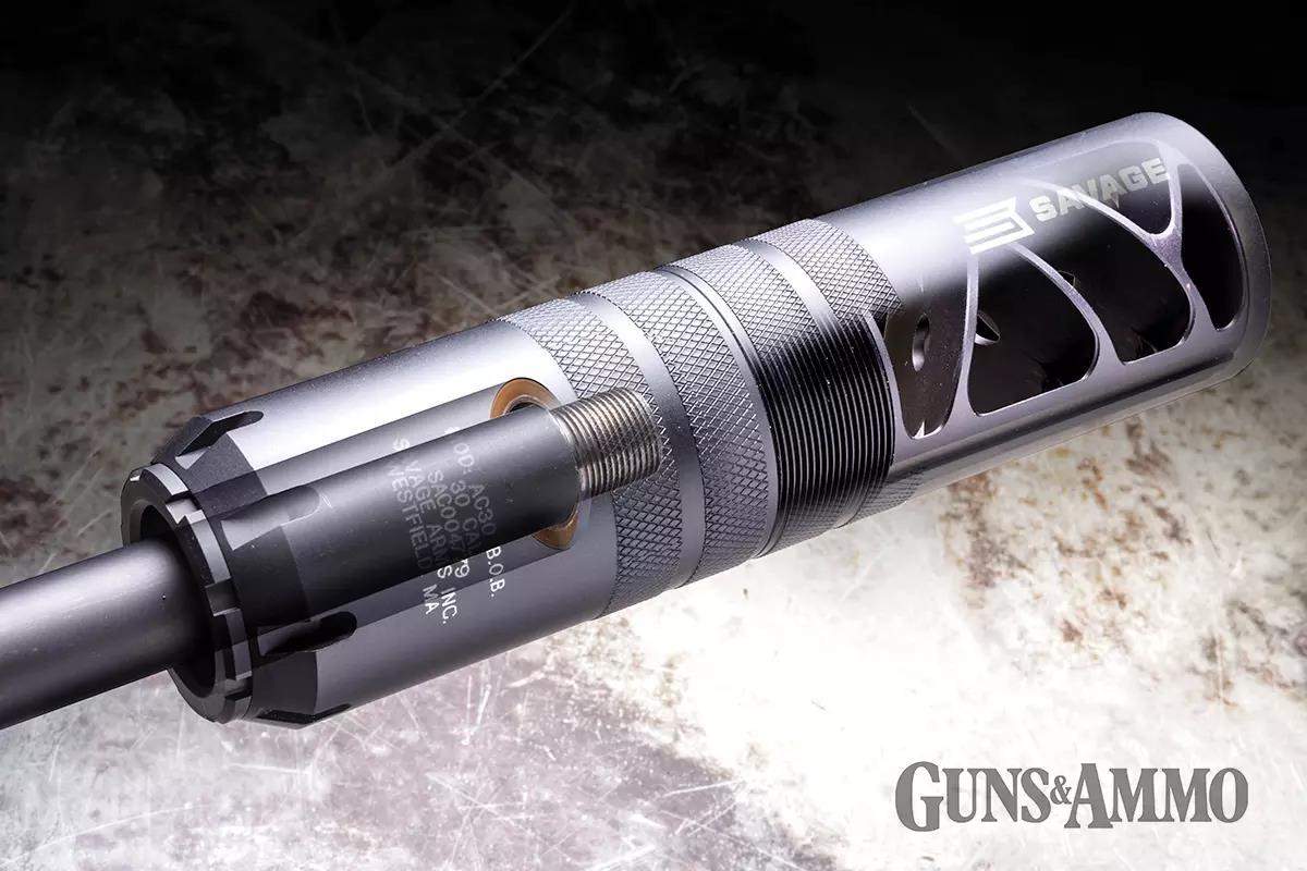

The portion that exists overtop the barrel is slightly oversized to accommodate most .30-caliber barrel diameters. (Photo by Mark Fingar)
Typically, point of impact shift is minimized with over-­barrel suppressors, so if you prefer to carry the can and rifle separately and a rushed shot needs to be made, trust the rifle will perform similarly with or without the suppressor attached. It sports common ⁵⁄8x24 threads, making it compatible with most rifle barrels. This, coupled with its ability to cut down on sound, muzzle flash and recoil, makes the AC30 B.O.B. an advantageous tool for hunters.
