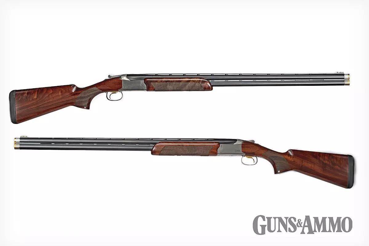

Sporting 32-­inch barrels set into a silver-­nitride-­finished receiver with Grade III or IV black walnut, the 825 is quite pleasing to the eye. The shotgun features two functional improvements of note. First, the grip is better designed for sporting clays. It does not force the wrist into a hard right angle, which greatly improves controlling the recoil impulse. Second, the cast was also optimized for sporting clays. By narrowing the stock, Browning better aligned the eye with the rib. For at least the last decade, most shotguns with wood furniture left a factory with too much width in the buttstock. Excessive width increases the effects of cast, also affecting the point of impact. More wood ensures a stock doesn’t crack, so a lot of gun companies use thicker stocks with lesser grades of wood to prevent cracking. Browning’s design means that the 825 Sporting is not too thick and should never develop a crack in its wrist.

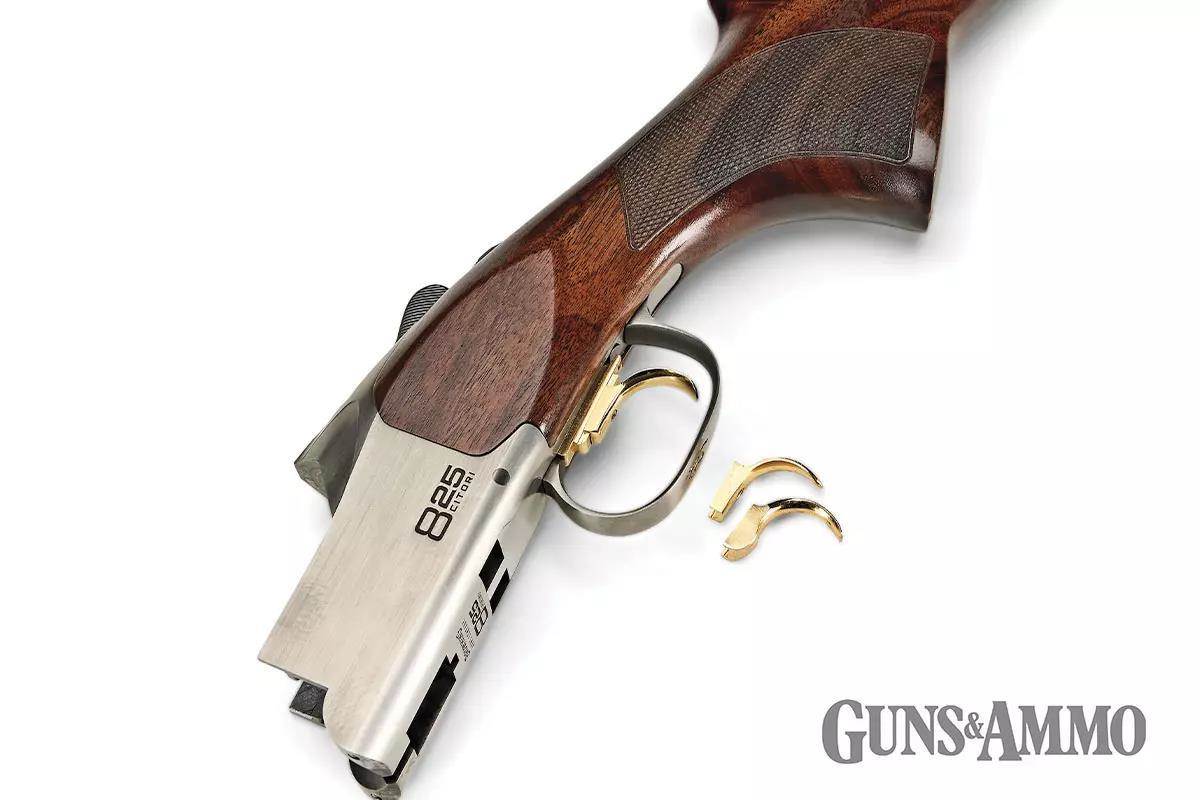

The 825 also received Browning’s Fire Lite 2 trigger, which was outstanding. It has three user-­interchangeable trigger shoes. The narrowest was best for abundant true-­pair courses. It’s a mechanical design that doesn’t rely upon recoil inertia to set the next shot. It shoots fast, which is necessary for a true pair with a short window of opportunity.

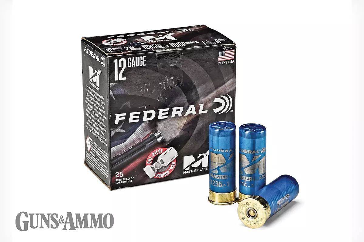

A natural pairing to a sporting shotgun is a shotshell designed specifically for sporting clays. Federal’s Master Class line worked exactly as advertised. I tested the faster 1-­ounce 7.5-­ and 8-­shot loads at OSP’s clinic, which reach 1,300 feet per second (fps). Thirteen-­hundred fps is fast when compared to typical trap and sporting shotshells. Faster loads such as these highlight the importance of correct length of pull. My only issue with the 825 Sporting was the 14¾-­inch length of pull — no fault of Browning. At 6 feet, 4 inches, no shotgun manufacturer makes a length of pull long enough for me. The length of pull of the 825 is appropriate for the average shooter's body size, but I need a full 16 inches to get the right sight picture and to mitigate recoil.

Master Class shotshells feature a modified version of Federal’s popular Podium wad. The one-­piece wad was designed to support the shot and prevent deformation when fired. Gil noted the significance of shotshell development in his 40 years of shooting, explaining one of the key evolutions was the level of antimony used in the shot. It increased from approximately 3 percent to as high as 6 percent in loads such as the Master Class. Antimony essentially makes lead shot harder. Harder shot breaks clay targets more easily.

Three gold-finished shoes come with Browning’s Fire Lite 2 trigger. The shoe can be adjusted forward and backward. (Photo by Michael Anschuetz)

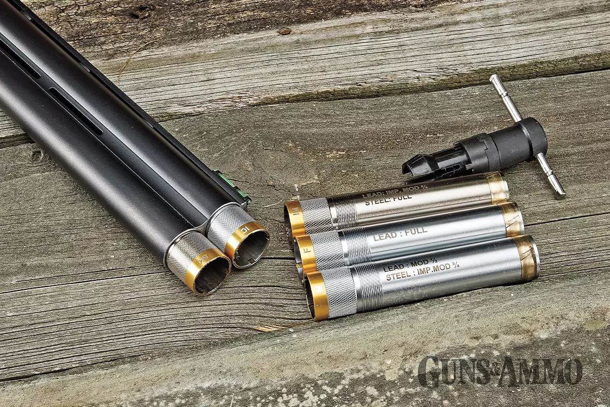

Five Browning Invector-DS extended chokes are included with the 825 Sporting. Additional chokes are available online. (Photo by Michael Anschuetz)

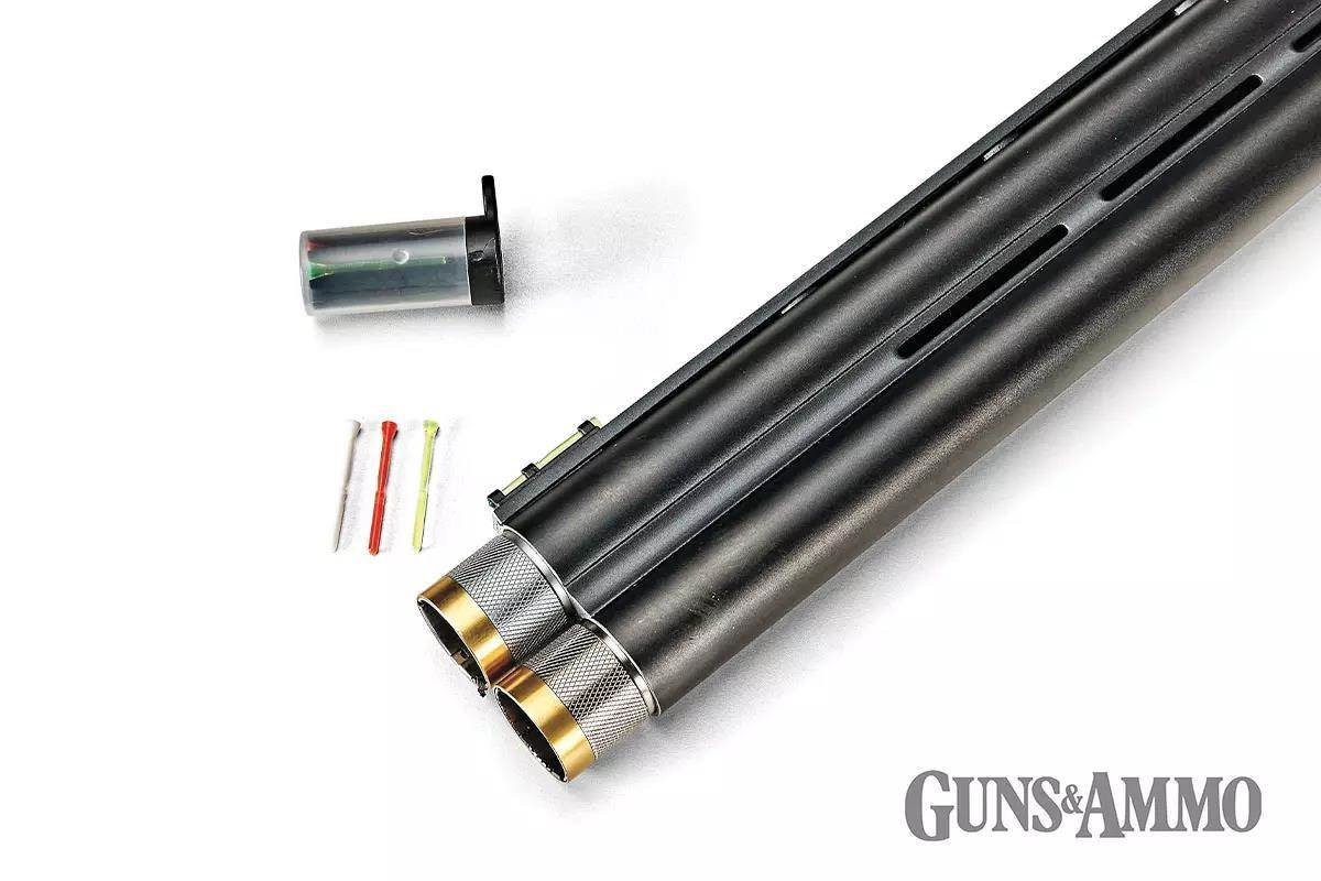

The green HiViz Pro Comp front sight can be replaced with alternate fiber-optic rods or a solid white rod. (Photo by Michael Anschuetz)
