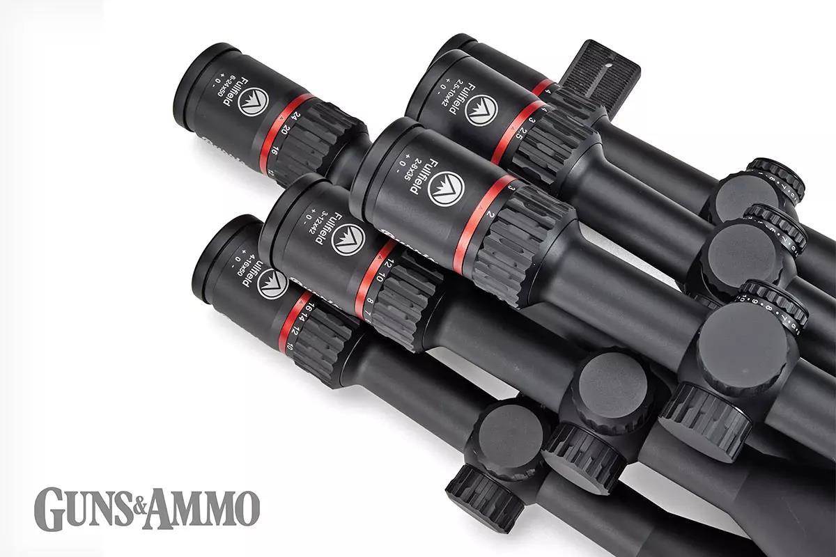

Fifty years ago, Burris unveiled the Fullfield line of riflescopes, which became known for presenting an exceptionally wide field of view. In the years since, Fullfield scopes featured increased light transmission while keeping the price palatable to most working-­class riflemen. These principles have always guided the Fullfield line, but the newest generation of these scopes brings unprecedented performance at a price that remains within reach.
Field of view continues to be one of the areas where the Fullfield shines. While Burris no longer dominates in this area, these inexpensive scopes have fields of view that are just as wide as scopes that cost seven or eight times as much. All these models have second focal plane (SFP) reticles and are best suited to hunting or casual plinking at ranges up to and within 1,200 yards. Holding off for wind requires some additional effort unless the scope is at its maximum magnification, but that’s why I’d recommend these scopes for recreational pursuits versus hardcore competitive use.
Each of these scopes has an intended purpose, so a quick look at each model shows how much thought and great design went into ensuring these scopes meet the diverse needs of today’s rifleman.

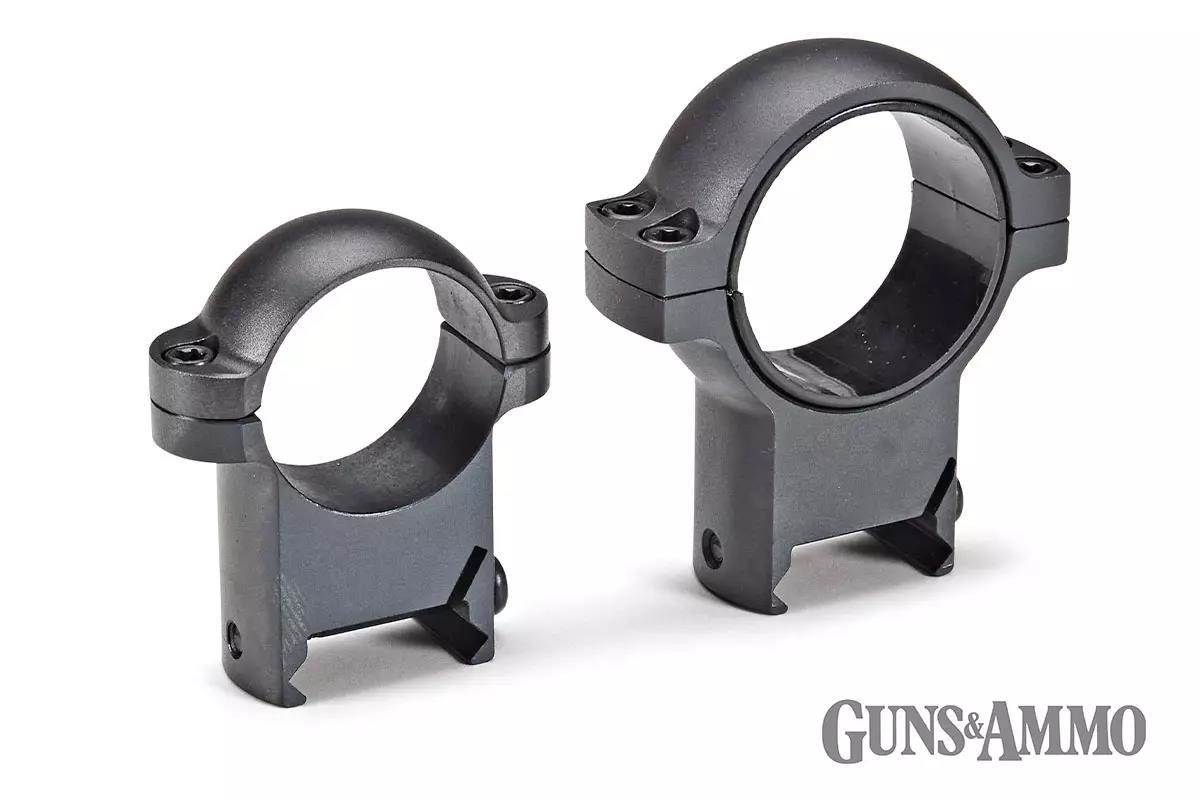

Burris offers numerous rings to mount any size maintube or objective size. Signature rings (below, right) include a Pos-Align insert for additional non-marring grip. $54 – $78 (Photo by Michael Anschuetz)

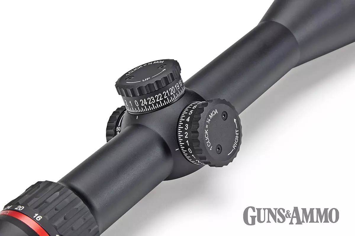

The 3-12X model is the first Fullfield scope I would recommend for hunting beyond 200 yards. There are three versions of this scope available, but one has the new exposed advanced elevation turret, which is also available with a side-focus knob. The exposed elevation turret allows the shooter to dial one complete revolution of 25 minutes of angle (MOA). For reference, 25 MOA would allow most 6.5 Creedmoor rifles with 24-­inch barrels to dial for targets out to about 1,000 yards at near sea level.
gaad-fullfield-50th-04

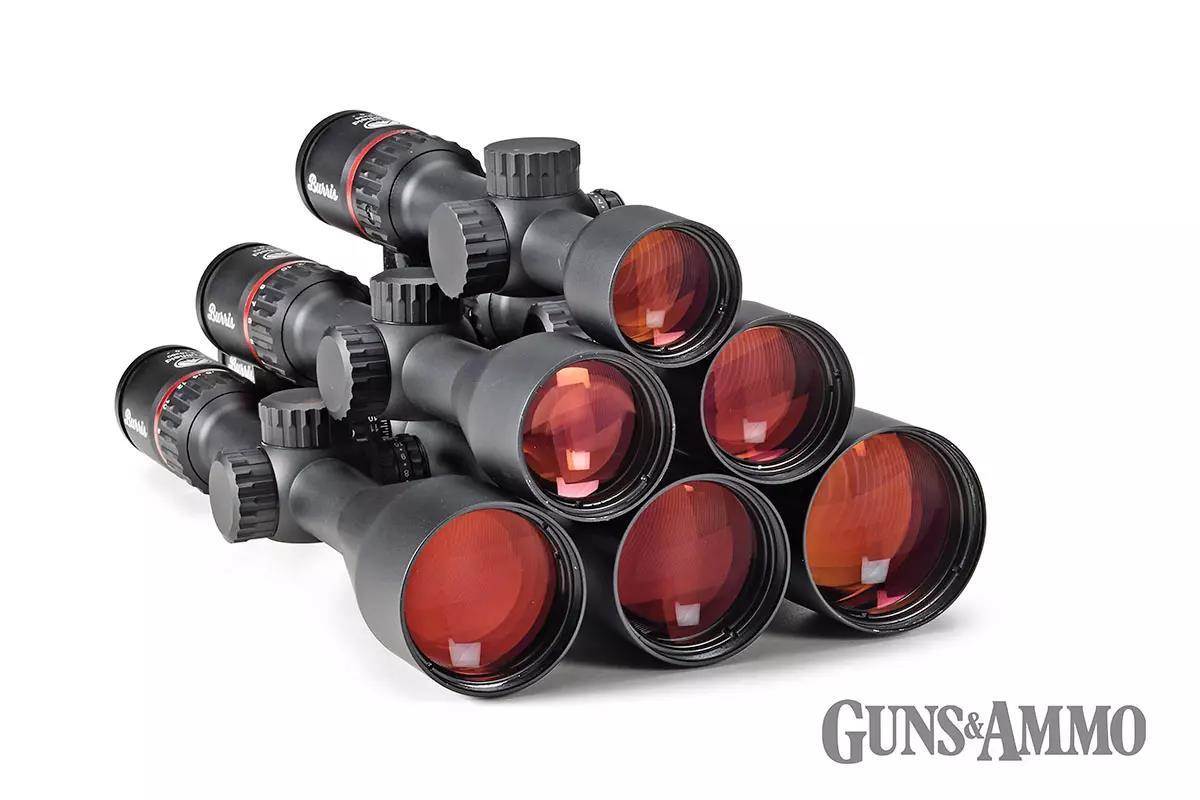

Burris’ 4-16x50mm and 6-24x50mm Fullfield models can be equipped with double-spring, knob-style, Advanced Exposed turrets for precision dialing on long-range targets. (Photo by Michael Anschuetz)
The side-focus knob allows shooters to focus the image at distances as close as 25 yards — Hey, rimfire shooters! — or out to “infinity.” The ability to focus the image coming into the scope is an important step in removing parallax and the error that comes with it. Most of the time, parallax error isn’t significant enough to matter when hunting inside 400 yards, but if the targets get small or the distances get long, the shooter has to eliminate parallax. The side-focus knob makes that possible.

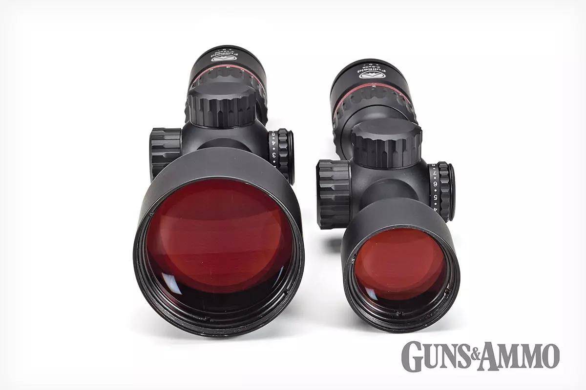

The unique features on the 3-12X are the 30mm maintube (instead of 1 inch) and the massive 56mm objective lens for a scope in this magnification range. The 30mm maintube provides an additional 23 minutes of internal adjustment compared to the 3-­12X with the 1-­inch maintube. However, the elevation turret still has a single 25-­MOA revolution, limiting how much of that travel is usable after zeroing. That additional internal travel is useful for rifles that require a lot of adjustment to zero due to less-­than-­optimal manufacturing. Where it might not be possible to zero the scope with a 1-­inch tube on a questionable rifle, the 30mm and its additional internal adjustment could get the job done.
gaad-fullfield-50th-05
Burris Knob Synergy means that it is easy to upgrade the elevation knob to an advanced or custom ballistic system. (Photo by Michael Anschuetz)
The 56mm objective lens is going to have the largest exit pupil of any Fullfield scope. This means it will be easy to get behind to get a full field of view, and it has a forgiving eye box. Should the possibility exist of needing the scope set at maximum magnification in very low light, this model would provide the best performance.

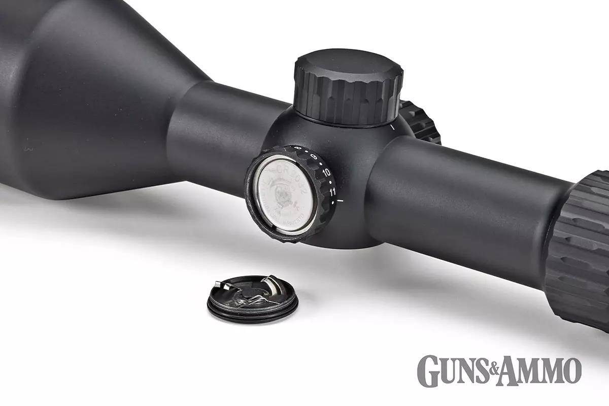

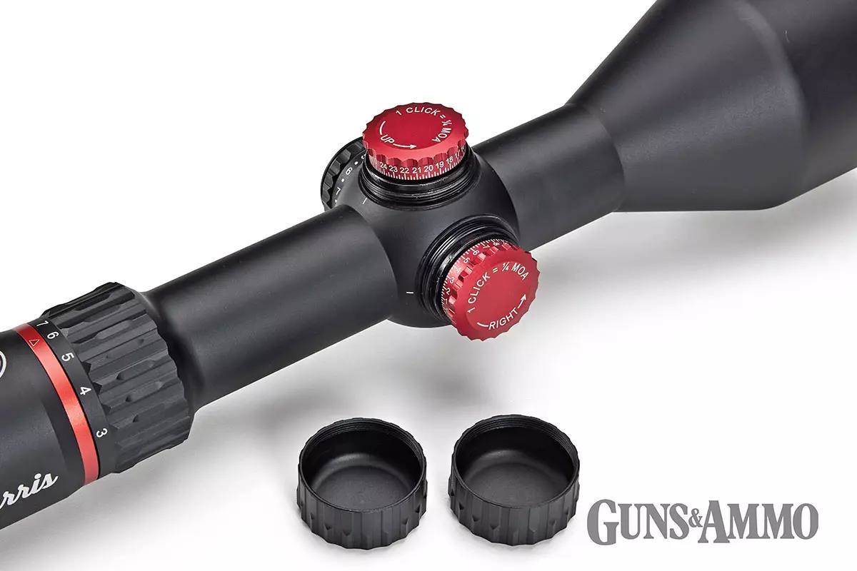

These new scopes, depending on the model, are available with one of four turret systems. The capped elevation turret is what most are used to with a hunting scope. Remove the cap to zero the scope and then put it back on and leave it alone. The next option is the capped advanced knob with a removable cap. Underneath is what appears to be an exposed elevation turret. The size of the internal turret and the engraving on it make it apparent that it’s meant to be dialed for distance.
gaad-fullfield-50th-06
The parallax dial for models with illuminated reticles also houses the CR2032 battery. (Photo by Michael Anschuetz)
Next is the exposed elevation turret with 25 MOA of adjustment, and the final option is a custom-­engraved turret that uses the shooter’s rifle information and expected hunting conditions to create a turret that dials to however many yards to the target. No mils or MOA to calculate; just spin the dial to “4.2” to hit a target at 420 yards.

Burris Fullfield optics feature coated objective lenses engineered to enhance image brightness and clarity. (Photo by Michael Anschuetz)
The Burris Fullfield line is comprehensive with a wide variety of magnification ranges, reticles, and turrets. All Fullfield scopes are IPX-­7 rated, meaning they can be submerged in 3 feet of water for 30 minutes with no moisture penetration of the optic. Best of all, Fullfields still carry Burris’ Forever Warranty. 
